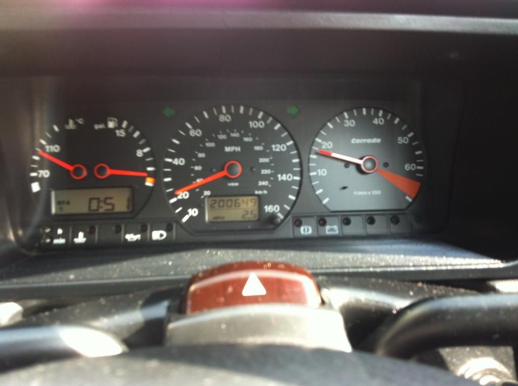

Lesta_Rado 0 Posted August 23, 2014 I've had a quick read through of some old posts but there's mixed opinions. I have a 95 Corrado VR6 and the coolant temp gauge went to 110 (some spirited driving was also conducted). Now, I've read other posts on this forum by members and some say it's pretty normal as VRs tend to run hot and some say it's not normal? Just because of this, I've went to gsf and bought a coolant fan sensor to replace. I was just wondering if someone could please clarify what is normal for these engines and what isn't. Quote Share this post Link to post Share on other sites

Lesta_Rado 0 Posted August 28, 2014 Sorted! Temp stays around 100 or just below and fan kicks in always as you an hear it. Cheers guys!! Quote Share this post Link to post Share on other sites
