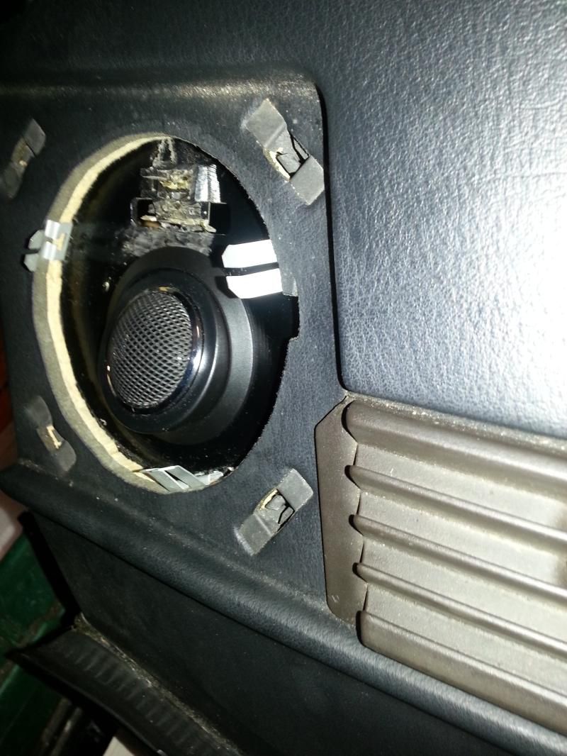

fla 9 Posted January 7, 2015 Also noticed your development on the installation of the tweeters - same as mine! Interested in your solution for the grilles too. I was thinking of cutting some mdf and covering it in some leather to act as the surrounds. Quote Share this post Link to post Share on other sites

Jim Bowen 1 Posted January 8, 2015 Also noticed your development on the installation of the tweeters - same as mine! Interested in your solution for the grilles too. I was thinking of cutting some mdf and covering it in some leather to act as the surrounds. Tried fitting them last night and they do stick up too much, i found out i could just turn the mount upside down and fit from underneath and the original grilles fit over them fine now. Quote Share this post Link to post Share on other sites
EJ Taylor 22 Posted January 8, 2015 Nicely done! Tidy Quote Share this post Link to post Share on other sites

Jim Bowen 1 Posted January 8, 2015 Nicely done! Tidy Looks a bit messy where i cut the old connector off with the dremel, but that will be hidden. Quote Share this post Link to post Share on other sites
sankysvr6 0 Posted January 8, 2015 Aren't the metal spring clips going to be sticking out now? Quote Share this post Link to post Share on other sites
Jim Bowen 1 Posted January 8, 2015 I thought they might and was going to trim them, but the cover fits back on over them, so left them. Quote Share this post Link to post Share on other sites
sankysvr6 0 Posted January 8, 2015 Nice, I like the ingenuity with your thinking. Don't think I would have thought of mounting them from the rear. Quote Share this post Link to post Share on other sites

fla 9 Posted January 8, 2015 Tried fitting them last night and they do stick up too much, i found out i could just turn the mount upside down and fit from underneath and the original grilles fit over them fine now. Great idea! Quote Share this post Link to post Share on other sites
