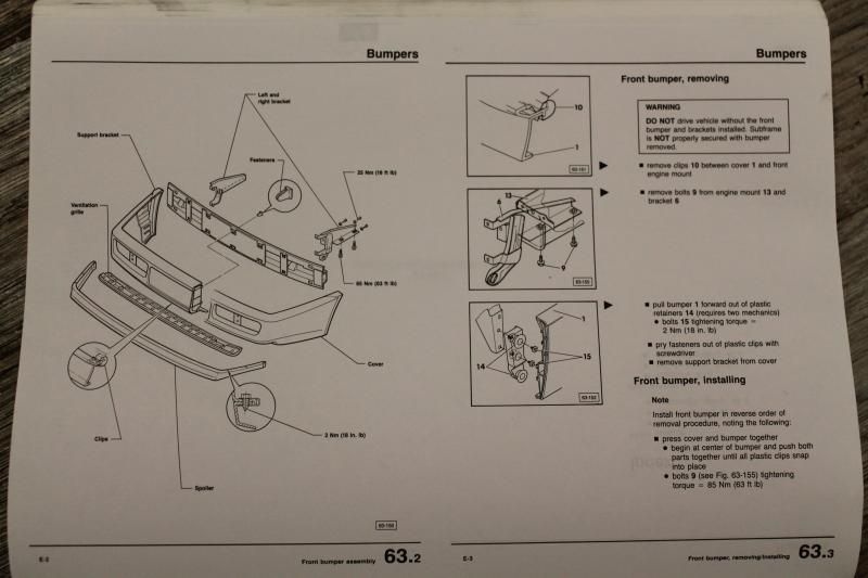

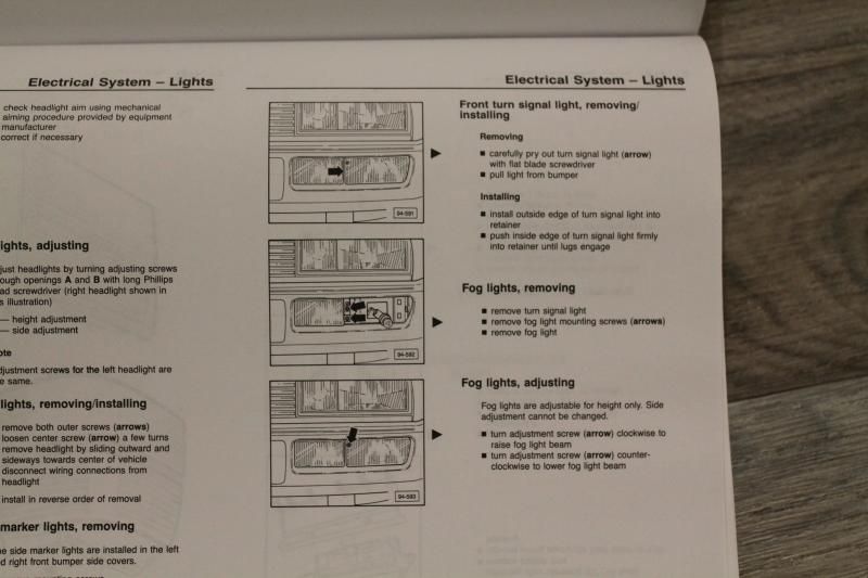

Roger Chatfield 0 Posted January 8, 2015 A little unclear but below is a photo from the Bentley manual. It's real easy to get the indicators out, once out you can disconnect them. Bumper removal. Hope that helps Rog. Quote Share this post Link to post Share on other sites
Ray1965 10 Posted January 8, 2015 (edited) Roger Chatfield said: Put a screwdriver in the side of the indicator and just pop them out, they come out real easy, once out they are easy to disconnect...I think the fog lights are disconnected using the pugs in front of the battery and under (or in front)the airbox also don't forget to disconnect the outside temp sensor, its in the lower grill on the drivers side, easy to disconnect from inside the bumper. Rog. Cheers Rog, Thanks for taking the time out to post pics :thumbleft: fancy popping up to Yorkshire this weekend? Edited January 8, 2015 by Ray1965 Quote Share this post Link to post Share on other sites
