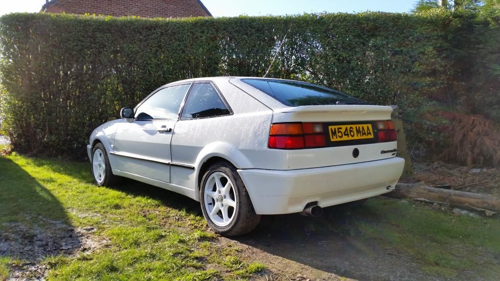

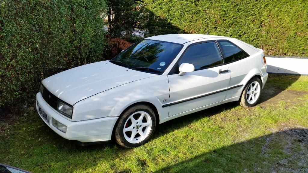

So more updates first a few pics of it clean. Not the best as its having to live on the garden and is were I am having to work on the car :(

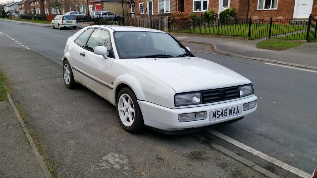

Decided I would do a few subtle changes and see how I like them. Started by getting some orange film and put it over the front indicators as finding some U S spec ones.think it breaks it up a little more.
Then next thought I would have ago at tinting the rear lights red as again I think it looks fairly good on the corrados! Not too sure on them yet will see if they grow on me as I don't want too change the car to much!.
