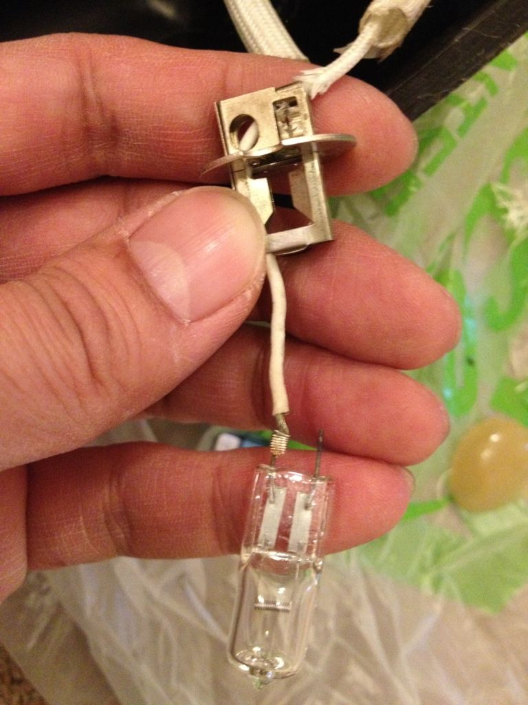

Wayne2015 10 Posted March 1, 2015 Nice to finally meet u today Sanky :) Your car is in immaculate condition too! Thanks for lending me your Soldering Iron set for me to fix my Honda fog lights :) Quote Share this post Link to post Share on other sites

sankysvr6 0 Posted March 2, 2015 Wayne, that bulb you repairing what's on the end of the wire, is it a spade connector? As I'm sure all you needed was a new H3 bulb Quote Share this post Link to post Share on other sites
