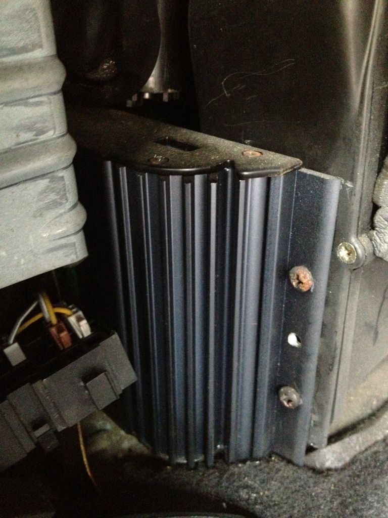

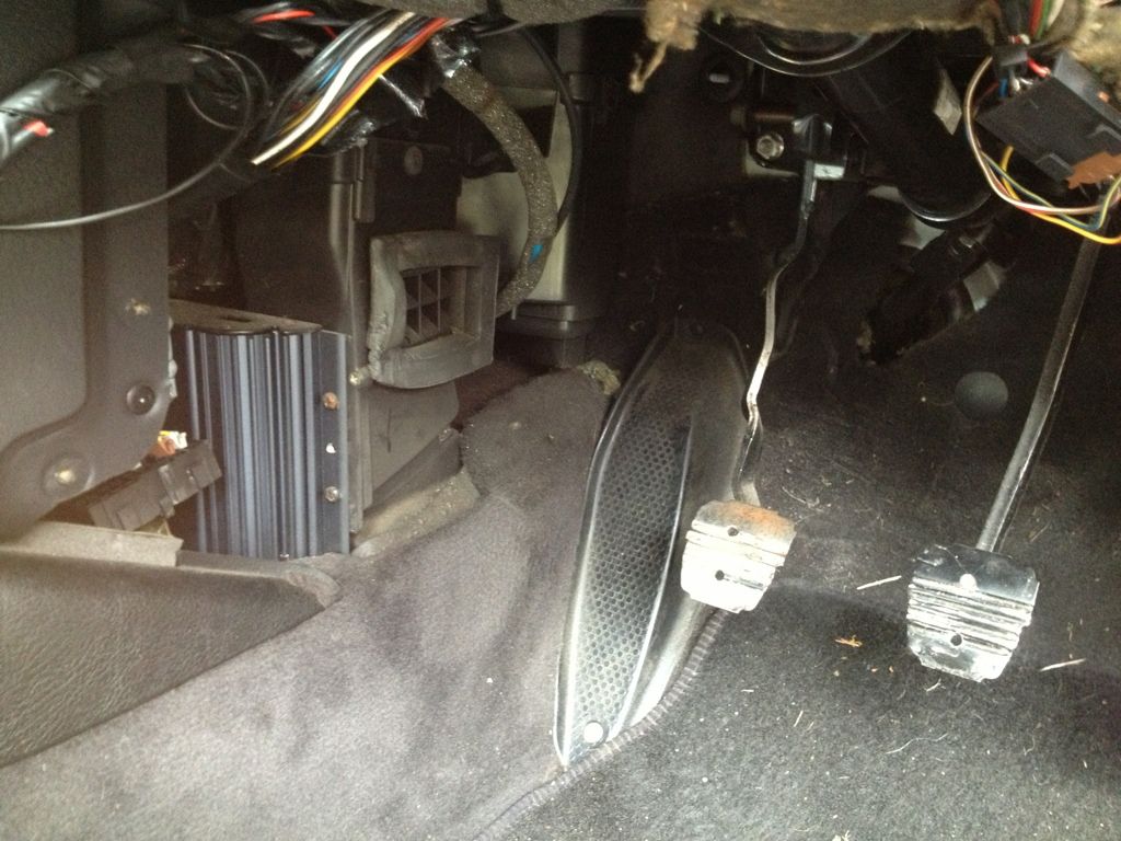

Yay - Box located!!! Tucked up under the dash above the centre console.Now to see if I can get the pin code from the serial number.
