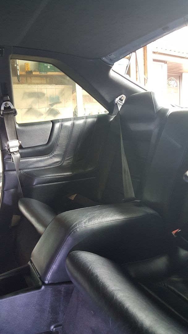

Jim Bowen 1 Posted January 5, 2016 Got mine from here: http://www.as-trim.co.uk/ Used the black foam backed stuff and went on a treat, had never attempted to trim something before but it all went pretty much perfect on the first go. http://www.as-trim.co.uk/index.php?main_page=product_info&cPath=5_200_201&products_id=387 I actually have loads of the material left, enough to do another 2 headlinings. Quote Share this post Link to post Share on other sites

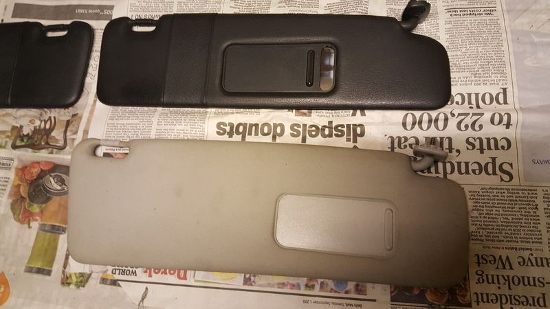

Jim Bowen 1 Posted January 5, 2016 Nah, i didn't want to remove it and thought the same, that it might catch and pull the lining off, so i used a black dye and brushed it on. Didn't come out great as i didn't clean it well enough. Think i even brushed on some black leather paint as it came out a little greyer than the new lining. Looks ok though with a difference in colour. Changed the visors for audi ones. Just realised you can't really see the sunroof in my pics. Quote Share this post Link to post Share on other sites
twinny 10 Posted January 5, 2016 What Audi did the sunvisor a come out of Jim? Thanks Quote Share this post Link to post Share on other sites
Jim Bowen 1 Posted January 5, 2016 A 2007 Audi A4 Cabriolet, but had to modify them to fit properly. Quote Share this post Link to post Share on other sites
