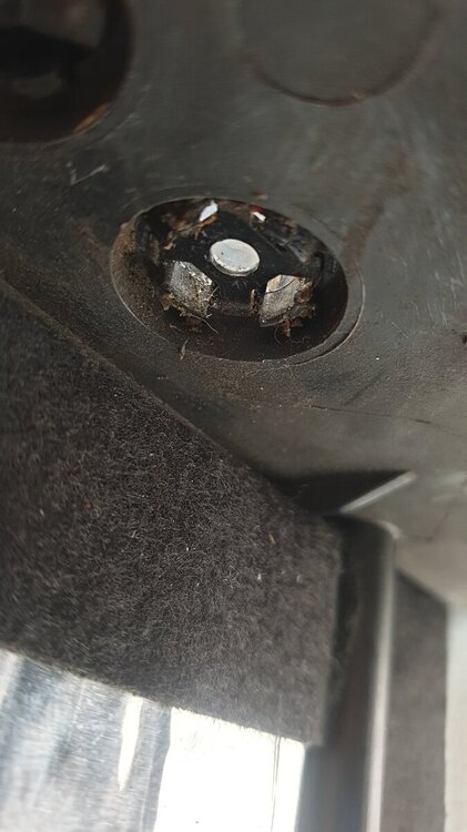

ryan_welshman 10 Posted April 21, 2016 Hello Just took dash out to suss my heater exchange direction problem and im missing a cog (see pic) where can ingwt one from asap??[ATTACH]83683[/ATTACH] Quote Share this post Link to post Share on other sites

ryan_welshman 10 Posted April 21, 2016 ryan_welshman said: Hello Just took dash out to suss my heater exchange direction problem and im missing a cog (see pic) where can ingwt one from asap??[ATTACH]83683[/ATTACH] Anyone got suggestions on the missing cog for the front flap? :-( Quote Share this post Link to post Share on other sites

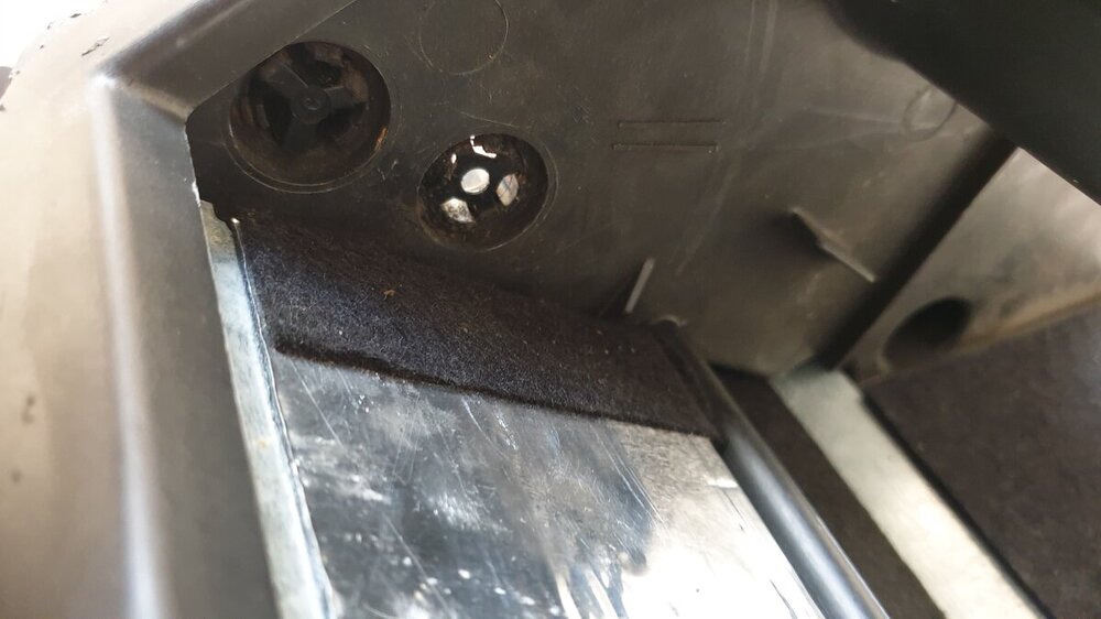

Cressa 45 Posted April 21, 2016 [ATTACH]83684[/ATTACH]which one do you think is missing? Sent from my SM-G900F using Tapatalk Quote Share this post Link to post Share on other sites
ryan_welshman 10 Posted April 21, 2016 The centre of the three on the left Quote Share this post Link to post Share on other sites
Cressa 45 Posted April 21, 2016 Mine was broken. I managed to purchase a 2nd hand unit and rob the cog for mine. I did find that a 95 polo had the exact same flaps which have a better covering and also a straight swap. That's what I used in mine. I'll look this weekend to see if I Have a spare but can't promise I would Sent from my SM-G900F using Tapatalk Quote Share this post Link to post Share on other sites

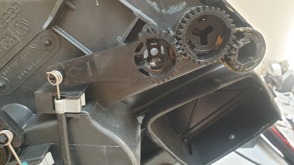

fla 9 Posted June 4, 2023 The cog on my heater direction gear in the heater box is 1 or 2 teeth out. Cant seem to get the cog off and I'm a bit worried about snapping the retaining lugs inside the box. Im trying to remove the lhs gear arm with the cable attached. Any suggestions? Thanks Hasan Quote Share this post Link to post Share on other sites
fla 9 Posted June 4, 2023 Well nailbiting does help! Managed to get the arm off without snapping the collars. Used a mid-width screwdriver and patience...and bad language Quote Share this post Link to post Share on other sites
