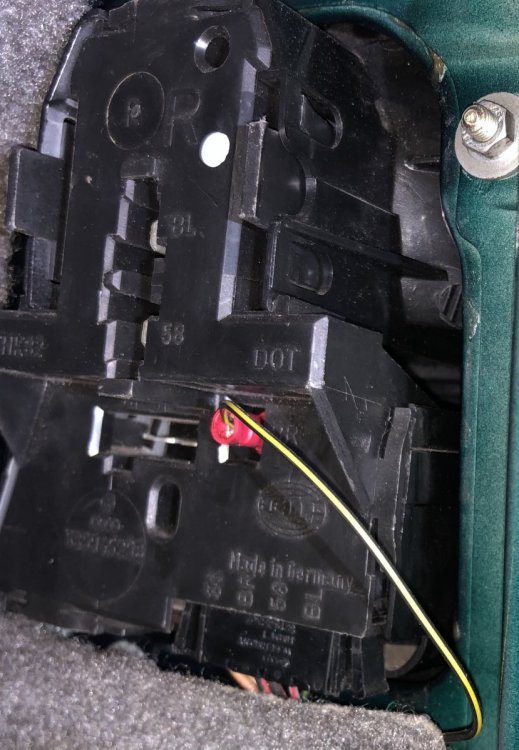

fla 9 Posted October 11, 2020 Where should these connections go for the third brake light? I cant seem to get it to work in any combination... The grey with black stripe is the negative for the light. Thanks Hasan Quote Share this post Link to post Share on other sites
fla 9 Posted October 11, 2020 (edited) I guess i should think a bit more first! 31 for ground and BR for live! Had to remove the resistor for the led indicators but will prob use a body earth for the brake light Anyway they're there for anyone for any future installs Edited October 12, 2020 by fla Quote Share this post Link to post Share on other sites
tonedef 9 Posted October 11, 2020 (edited) I was just about to tell you BR for the 12V…I grounded at an earth stud in the tailgate. But as you suggest, 31 is always ground of course! Edited October 11, 2020 by tonedef Quote Share this post Link to post Share on other sites
