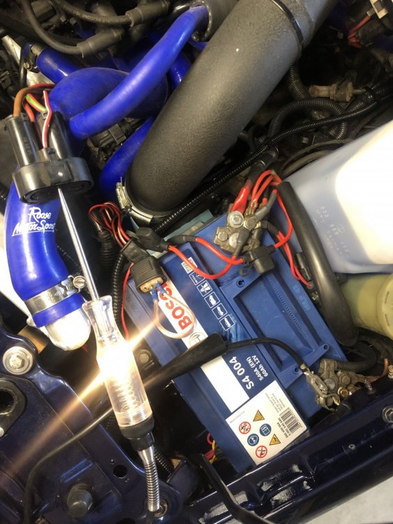

1xshaunx1 27 Posted January 18, 2021 15 minutes ago, Keyo said: Ok chap like three cables with males and females ? One thing I can say is the fan is very heavy indeed which is a good sign of quality and bares the Hella hall marks. Thanks A picture of the back of the fan where your car plugs in Quote Share this post Link to post Share on other sites

Keyo 47 Posted January 18, 2021 (edited) So the black and red cable on picture is the one from the missing power plug which is at the bottom pin Also picture showing that the unit physically fits an old shroud I have. Also picture of loom plug bottom middle connector would be black and red cable. Edited January 18, 2021 by Keyo Quote Share this post Link to post Share on other sites
1xshaunx1 27 Posted January 18, 2021 4 minutes ago, Keyo said: So the black and red cable on picture is the one from the missing power plug which is at the bottom pin Also picture showing that the unit physically fits an old shroud I have. Also picture of loom plug bottom middle connector would be black and rec cable. Looking at what I was testing, I think you are missing 2nd speed Quote Share this post Link to post Share on other sites
1xshaunx1 27 Posted January 18, 2021 Brown is earth the other thick wire red/green is speed 3 Quote Share this post Link to post Share on other sites

1xshaunx1 27 Posted January 18, 2021 1 minute ago, Keyo said: The only thing I can hope for and this is coming from someone is absolutely shit with electrics is that some how the electrics inside the fan unit can determine off the other three cable speed settings. grrrr why can the b....... just have 4 pins ! Have an old grottu stock motor but nothing worse then putting a year old part on your . If you look in the photo I posted, I think I was testing for speed one with a lamp to make sure that end was ok, it may have been speed 2 by t I don’t think so. Anyway red/ white 1 red/ black 2 red/green 3 brown - earth 24- 18 months ago I became a blumin expert on how this stuff should work, I didn’t want it that way 😖 Quote Share this post Link to post Share on other sites
