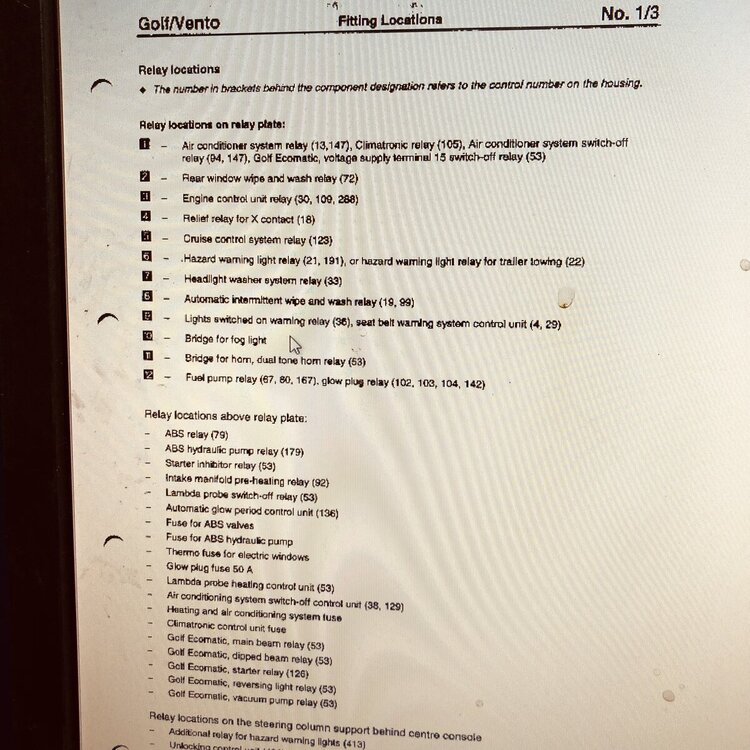

LA9V VR6 0 Posted January 31, 2023 On 1/30/2023 at 11:16 PM, _Matt_ said: Ahh if no 109 then you have no ECU control so that is probably your spark issue. With regards to testing the coil pull a lead and insert spark and crank - check for spark. However wait until 109 is installed. Sent from my SM-G960F using Tapatalk I'm unable to upload a pic for some reason buy I've just checked what relays are plugged into the fusebox, as below. 1 - nothing 2 - 72 3 -nothing atm, waiting on 109 4 - 18 5 - nothing 6- nothing 7 - nothing 8 - 99 9 - nothing 10 - 53 upside down 11 - 53 12- 80 Quote Share this post Link to post Share on other sites

James. 9 Posted January 31, 2023 (edited) Are you getting voltage at the injectors ? This may help your relay locations: Edited January 31, 2023 by James. Quote Share this post Link to post Share on other sites
