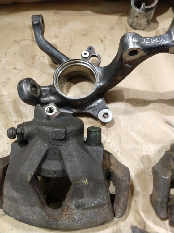

ABV-VR6 12 Posted April 2, 2020 Hey, so I dismantled a set of DE brake on a Passat b4, it's a nice OEM upgrade. I'm working on those to get them ready for powder coating and now I was looking to get a refurbish kit for the front caliper. I can find the rubber seals no problem but I just can't find anywhere the piston for them? They are rusted pretty bad. Any idea where I could find these? Cheers! Quote Share this post Link to post Share on other sites

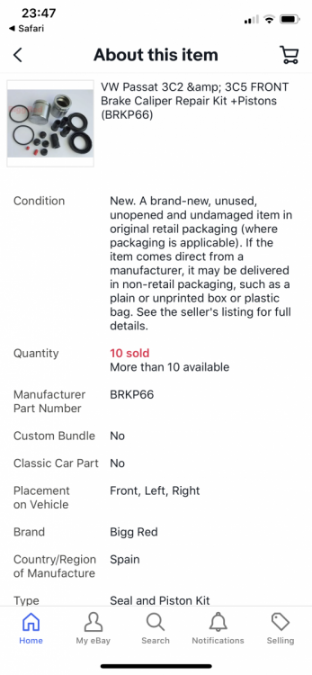

seanl82 23 Posted April 2, 2020 Bigg red do rebuild kits including pistons for most calipers Quote Share this post Link to post Share on other sites

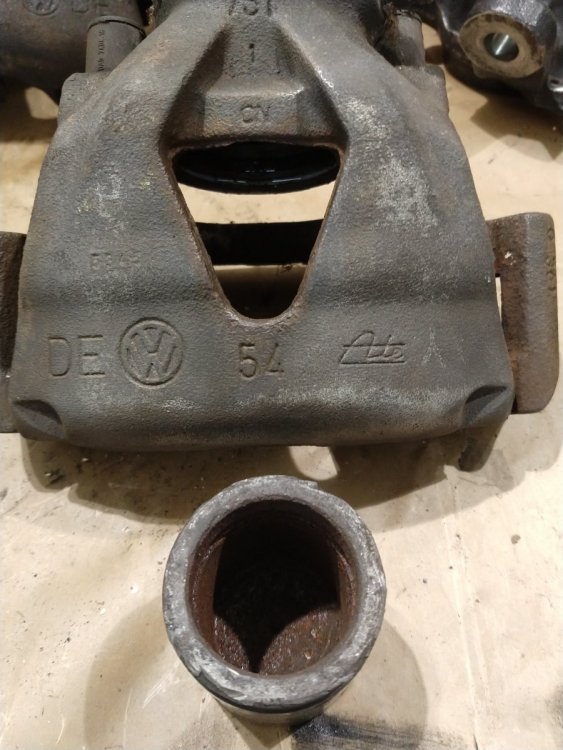

ABV-VR6 12 Posted April 2, 2020 Thanks guys for your help, always appreciated. I looked at Redd's website, they had nothing under Passat B3 or B4? They are from a Passat VR6 late 1996, it had the OBD2 system so probably the first run of them. Pistons are shot are per picture! Quote Share this post Link to post Share on other sites

1xshaunx1 27 Posted April 2, 2020 Might be this one from bigred on eBay item number 282860263003 but do a different one for golf about your cars age Quote Share this post Link to post Share on other sites

1xshaunx1 27 Posted April 2, 2020 More likely this one though with the year. ebay item number 272219252319. where’s Keyo he’s better at this, because I haven’t come across what you are try to achieve matey, I’m just trying to help, I don’t actually know for sure. You’d may have more luck if you can get the part number for the calliper or piston, maybe the dealers can help if you can’t get it online. Quote Share this post Link to post Share on other sites

ABV-VR6 12 Posted April 2, 2020 All I can see on the calipers is 731 on one and 732 on the other one. Both ATE 54 DE VW. both have stamped 5345 as well on the calipers. On the knuckles one has DE GER 255 and the other one is DE CDP 256 Quote Share this post Link to post Share on other sites
stuarttaylor37 13 Posted April 3, 2020 Looks exactly the same as the ate 54mm caliper found on golf mk3, the cracked Etka online does not list the pistons as seperate components, frustratingly the ebay compatability checkers are pretty unreliable. I would contact Bigg red ltd for advice. http://www.ebaystores.co.uk/Bigg-Red-Ltd/Volkswagen-Caliper-repair-kits-/_i.html?LH_SellerWithStore=1&LH_TitleDesc=1&rt=nc&_fsub=187431018&_sasi=1&_sid=144806038&_trksid=p4634.c0.m14.l1513&_pgn=2 Quote Share this post Link to post Share on other sites
ABV-VR6 12 Posted April 3, 2020 10 minutes ago, stuarttaylor37 said: Looks exactly the same as the ate 54mm caliper found on golf mk3, the cracked Etka online does not list the pistons as seperate components, frustratingly the ebay compatability checkers are pretty unreliable. I would contact Bigg red ltd for advice. http://www.ebaystores.co.uk/Bigg-Red-Ltd/Volkswagen-Caliper-repair-kits-/_i.html?LH_SellerWithStore=1&LH_TitleDesc=1&rt=nc&_fsub=187431018&_sasi=1&_sid=144806038&_trksid=p4634.c0.m14.l1513&_pgn=2 Yes mate, I totally agree with you there. Ebay is not reliable, etka don't show just the pistons, maybe they were just ment to be fully refurbished... I was thinking... Do you think mine are silver because they were on a passat but the MK3 GTI got the red version because of the GTI trend to be red? At this point int I'm starting to think that maybe I should just get new calipers and call it a day if it's that hard to find parts. I have the knuckles so the hardest to get I have already... Thanks a lot your time to both of you! Quote Share this post Link to post Share on other sites
