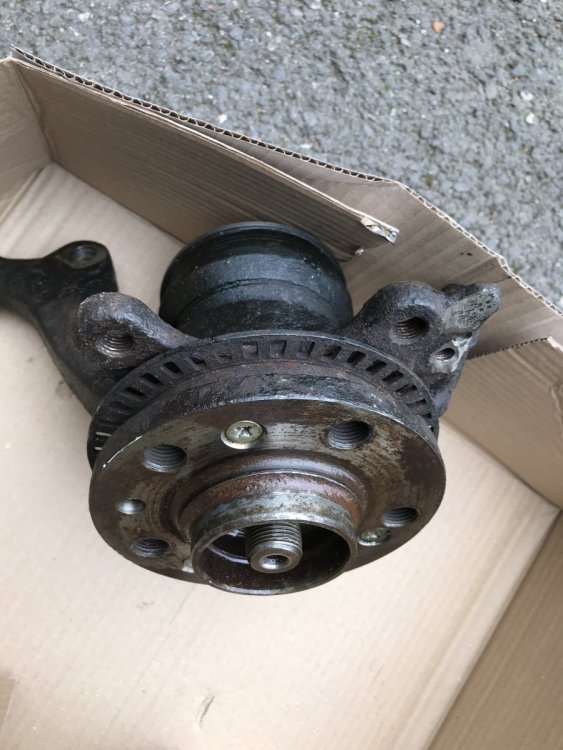

Design380 10 Posted April 6, 2020 Hi, What is the best way to remove the drive shaft from the wheel bearing housing on my 1995 VR6, It's been soaked in plusgas but no joy! See pic below: Any advice would be most appreciated. Thanks - Paul Quote Share this post Link to post Share on other sites
Dox 26 Posted April 6, 2020 I ended up pressing mine out, the passenger side was stuck solid. You could try putting the nut back on to protect the thread and hammer a piece of wood against it? Quote Share this post Link to post Share on other sites
Design380 10 Posted April 6, 2020 Could I ask what type of press you used? Quote Share this post Link to post Share on other sites
fla 9 Posted April 6, 2020 Might be easier to take them to a local garage (if you can find one thats open!) and they'll likely have a say 2 ton press to press them out easily. The bearing may separate during this process and will need changing Quote Share this post Link to post Share on other sites
Design380 10 Posted April 6, 2020 Thanks Fla, yes that's probably the best option, the reason for doing is to replace bearings. Cheers - Paul Quote Share this post Link to post Share on other sites
seanl82 23 Posted April 6, 2020 Mine took about 8 ton to break out initially, then pushed out with around 2 ton. Pushing back in was around 2 ton as well, and I made sure it was home by going up to 8 again. Quote Share this post Link to post Share on other sites
Design380 10 Posted April 6, 2020 Thanks Sean, did you get a garage to do for you or do you have your own press? if your own could I ask what type. Quote Share this post Link to post Share on other sites
seanl82 23 Posted April 6, 2020 It was a workshop when I was in Portsmouth on a course so I don't know the details unfortunately. It was a 20t press of a budget type, but it did the job well. Quote Share this post Link to post Share on other sites
Design380 10 Posted April 6, 2020 On 4/6/2020 at 2:36 PM, seanl82 said: It was a workshop when I was in Portsmouth on a course so I don't know the details unfortunately. It was a 20t press of a budget type, but it did the job well. Thanks Sean, think I'll have to wait until things get back to being a bit more normal and get a garage to sort, was hoping to to do a bit on the Corrado while I have more time on my hands! Quote Share this post Link to post Share on other sites
