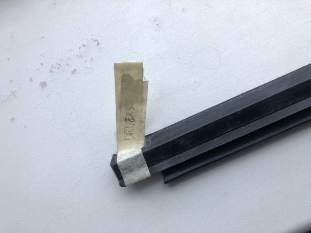

Look what the wife found down the side of the wardrobe. I must have put it there for safe keeping and forgot. She only found it because of getting ready for the decorators. No more unfortunately
7B503417-E7D4-4B09-9AA7-F370C7B18592.thumb.jpeg.fe476c1c86d9f1015d647a593c02fdb9.jpeg2020E160-143D-485D-B49B-84CB04D1B73D.thumb.jpeg.39ba45745c95afad87934060da00c4ae.jpeg
Golden straight rubber. Guard that rare one. Ive seen more dinosaurs than that piece

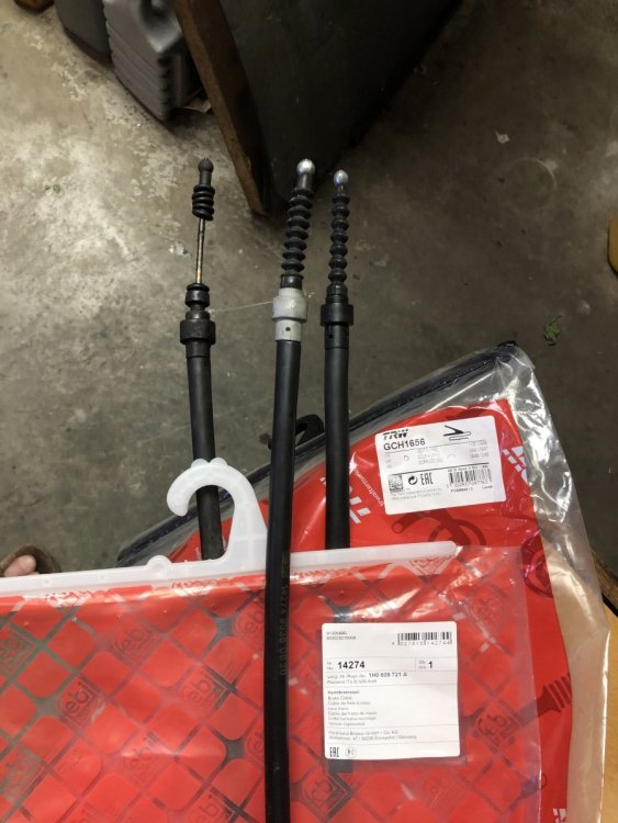

Finally got around to finishing my rear brake renew and upgrade.
carriers
callipers
discs
bearings
pads

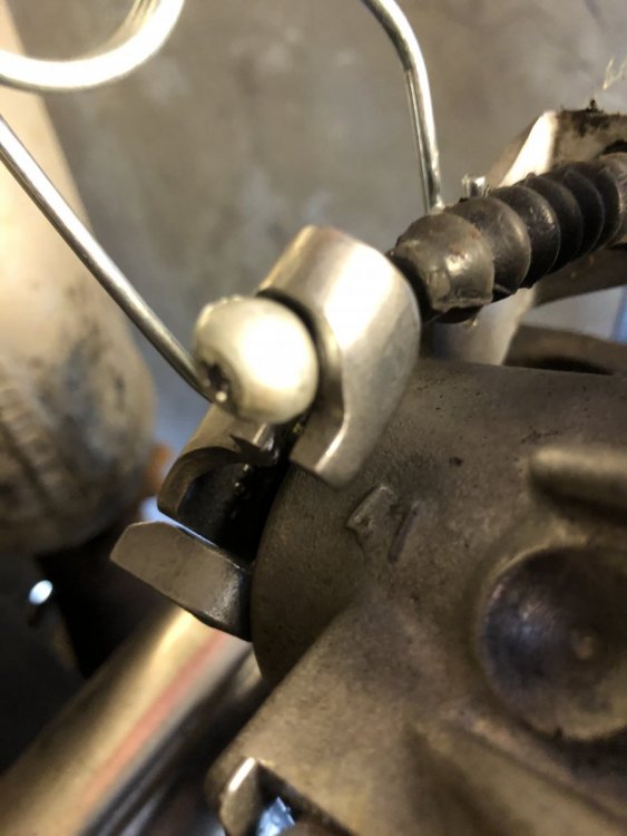

and now handbrake cables. decided to use the TWR ones.
Febi ones were very similar, same ends but a metal part where it slides into the tubes before going into the body
TRW GCH1656 £50 delivered for the pair, as you require two of the same part
Febi 14274 £20 delivered for the pair.

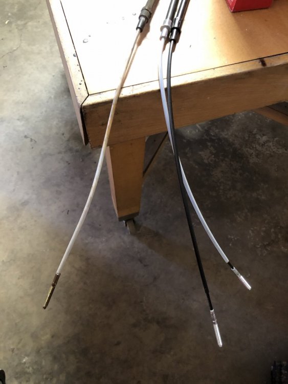

To be honest I just wanted to compare the two brands and see if they were both the correct length. The both seemed pretty much the same as the original one that came off8513AA4E-EE9B-4994-AD9C-D204F5CE0117.thumb.jpeg.b51a86df76938eba79e2b2a3c38c8d4d.jpegCD82CBA1-6DD1-4CC1-AC02-E65B9491D385.thumb.jpeg.83bdcf4484cc0f7aaac8d5c84b7d167a.jpeg7ADD8E50-75E2-421E-8E47-F22E80C70936.thumb.jpeg.5c057c8b6ca506277600e41de69582e6.jpeg

I've done this dance recently, I got one (and maybe the last, I can't remember) one from VW last year, and also picked up one which is still hanging in the garage in a blue bag, a Pagid one but it was much longer than the VW one.
Mine were about 1620-1640mm. Both the same, it has to be balanced with the same length of cable from the end stop, or the pull mech gets really unbalance. That’s why it’s best to do both cables at the same time.
Are the cables the same for all cars? Would these febi ones be fine for a 94 vr? Would you mind suggesting where you got yours from Shaun? Many thanks. Hasan
Edited by fla
Both off of EBay Hasan. just put the make and part number I gave above in the EBay search and away you go. All VRs had the same rear brakes so should fit yours unless you have a different after market set up.

I would say though that the TRW ones were more like oem and chances are you won’t be doing this again if you do it right.

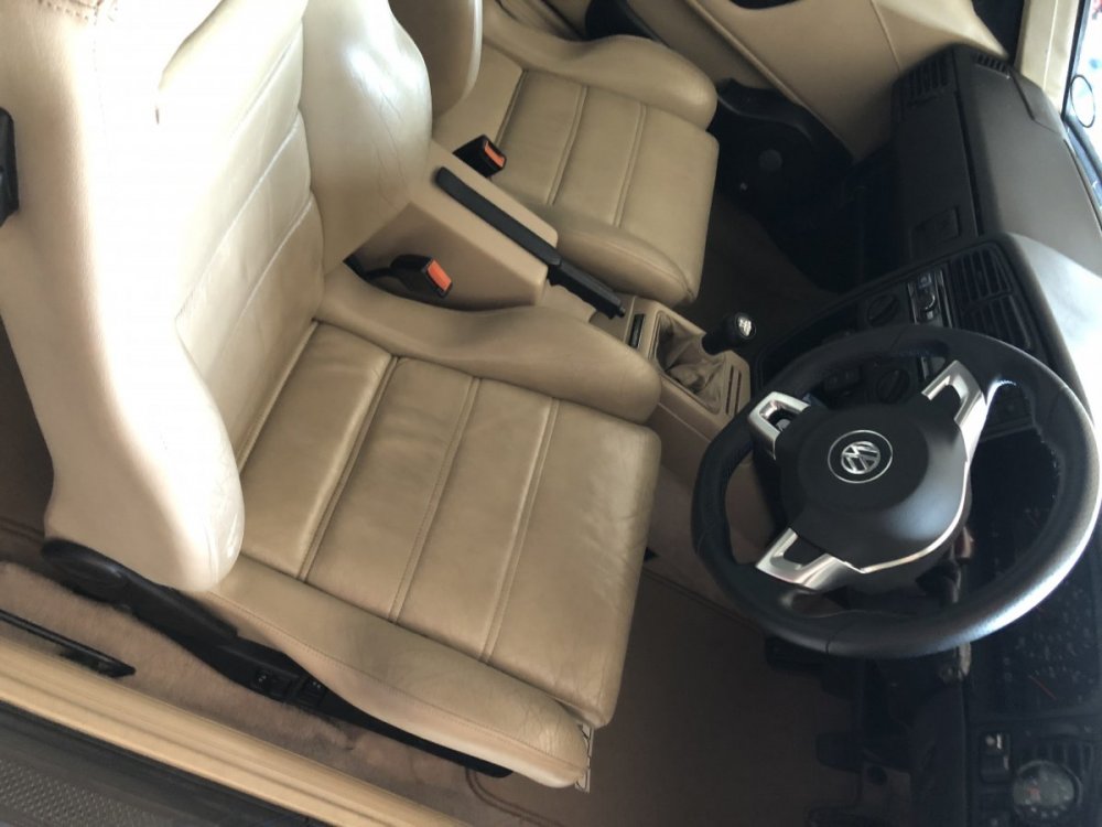

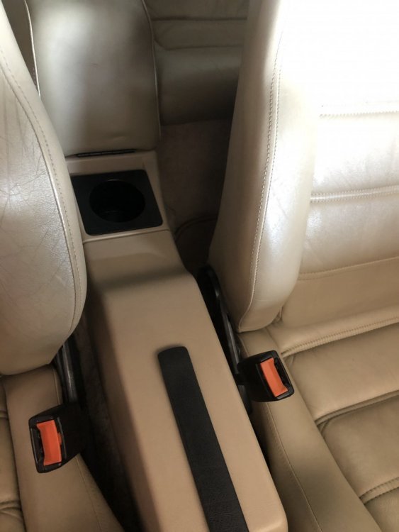

Fitted the rest for of my beige tunnel, handbrake cover and new cup cup holder. The cup holder was off eBay at about £30, pricey but slightly better than the last one as it’s a little bigger and can get a can of coke in it, looks a bit more oem too.

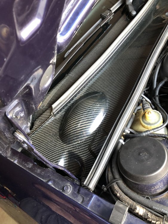

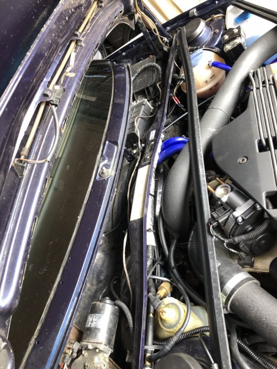

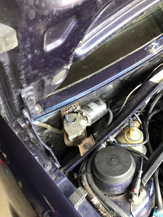

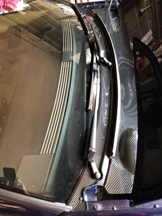

Decided to have a go at replacing my grotty looking wiper motor and bracket and tidy the whole area up by at long last having a go at fitting my spoonfed windscreen trim and wiper cover. Bit of a faf about but looks amazing when in place. 4A307F64-D873-4BFD-BD1F-857CA45490AF.thumb.jpeg.0104d2f82a32406173c785178569fe59.jpegC05888B4-0F90-4F7D-A3BF-9D047292B1B1.thumb.jpeg.7b5870412b3ea450639092917925af56.jpeg0E600890-C06D-4FFA-8492-2F3ACEE90F25.thumb.jpeg.1319daaca43a6341c2129acfcae1e3be.jpeg4CD95D46-E69B-4125-A473-AA4F15175779.thumb.jpeg.d2e521677c33c32f6a3d8d54b0b17c80.jpegAED0FE1A-752A-43CB-A9BB-1854A3A3CC6F.thumb.jpeg.a93bde59b13d2a3c8d427f8837bf7288.jpeg
wow that looks brilliant!
The steering wheel is amazing too - how did you fit it and get the indicator cutout and horn to work?  I've got a golf 6 one which fits on the spline but i'm stuck after that...
Thanks
Hasan
Edited by fla
Thanks
Hasan
You need the plastic base out of a Corrado with the wire from r the horn still attached, reinforce the wire with tape or similar.  Then drill a hole in the wheel housing to take this wire, be accurate as it will decide wether your canceller is in the right spot or not. Make the hole big enough and you are laughing

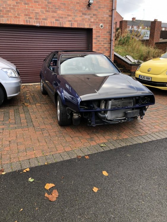

Finally the guy I wanted to do the full glass out respray said he could fit it in, 93EF0C44-0EC9-49D4-A9BF-446C8545A40D.thumb.jpeg.a5cccb2819e0f0ef2ed28b52f6684a0a.jpegYES!!!
Stripped and off for a respray, hopefully it will be all the same shade of aqua blue when it comes back

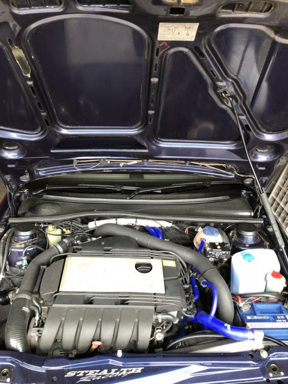

On 8/9/2020 at 1:53 PM, 1xshaunx1 said:
Full engine bay. With a sprinkle of 8795BDCB-E62B-4ED5-9B43-0664A859469F.thumb.jpeg.5c8682d07c1b8140f22ee96d57ea3515.jpegcarbon goodness
I wish my engine bay looked half as good as this, great work!!! Love the black manifold.
Cheers Ben
9 minutes ago, 1xshaunx1 said:
Cheers Ben
Looks like the car had a Schrick once as can see cut out in the bonnet .
