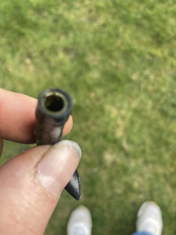

Keyo 49 Posted March 4, 2022 (edited) 22 minutes ago, seanl82 said: Did you use a sleeve on the inside of the hard plastic pipe (like no#5 above)? I'd be concerned it would deform when the rubber hose was put on and tightened causing a leak. Yes they have a metal lining - I only tighten with a screw driver as not to over toque . The black part is the same but of a mk2 swirl pot I have spare im experimenting on - bottom picture you can see the black pipe I cut off the mushroom and that is the pipe. Edited March 4, 2022 by Keyo Quote Share this post Link to post Share on other sites

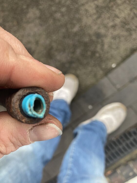

Keyo 49 Posted March 4, 2022 (edited) I took off again for a good picture - it has sleeve so your good to go. The last picture shows the line other side of filter which you can still buy for 50 euro so im just putting a new line on there- but yes you could just replicate what i have done the other side with a short cut off codan hose 7.3 mm. . Edited March 4, 2022 by Keyo Quote Share this post Link to post Share on other sites
seanl82 23 Posted March 4, 2022 Good stuff, I may do that for completeness before sale. The filter to bay hose has already been replaced with new genuine. 👍 Quote Share this post Link to post Share on other sites

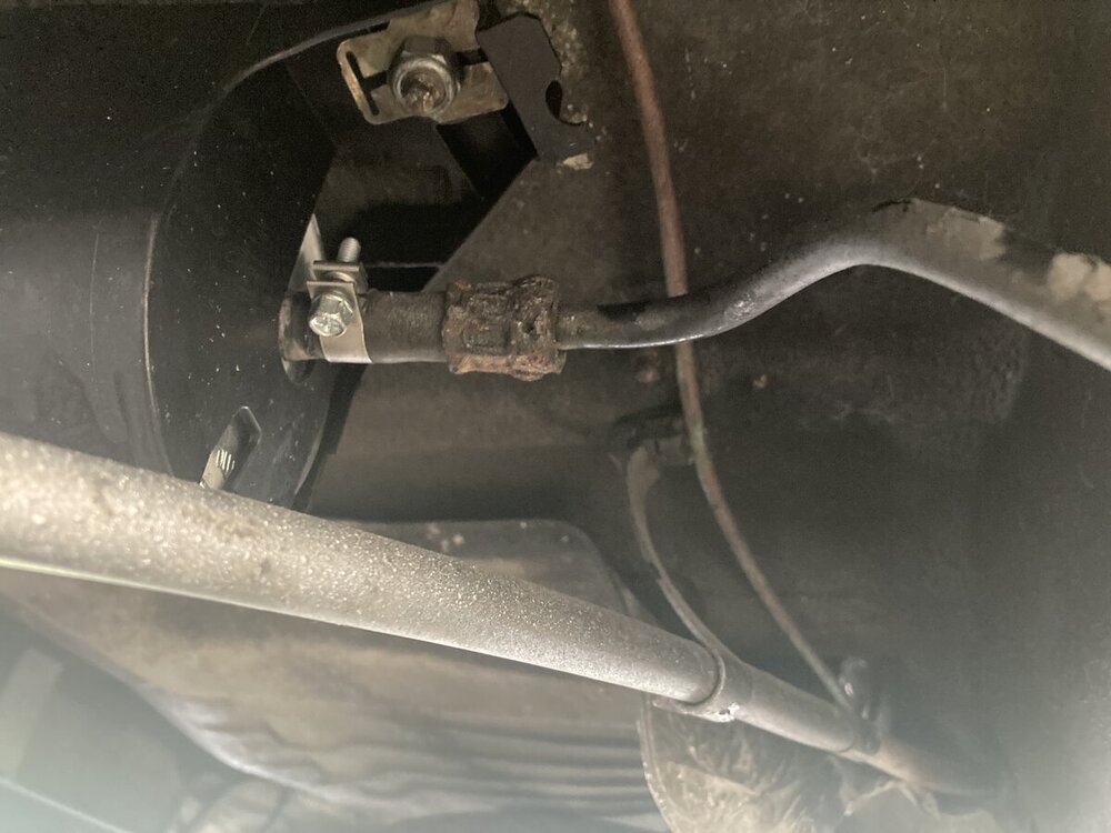

Keyo 49 Posted March 4, 2022 (edited) 3 hours ago, seanl82 said: Good stuff, I may do that for completeness before sale. The filter to bay hose has already been replaced with new genuine. 👍 Good stuff mate - it was well crusty the old one- could see micro cracks and that hard think I could of broke it- you might as well do it as i dealt you will sell your car when the time comes lol . Will be doing the vr one to as that is very crusty. Ive just notice as well I need to go back to it tomorrow as the white clip has snapped and i need to twist the hose- last owner got the rear brake lines done- shite ones and looks like they snapped it to get the brake line into position. Edited March 4, 2022 by Keyo Quote Share this post Link to post Share on other sites

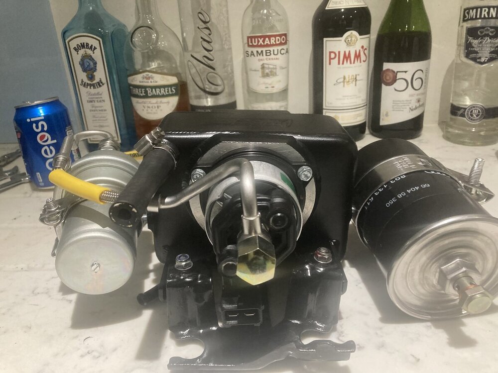

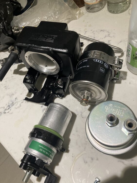

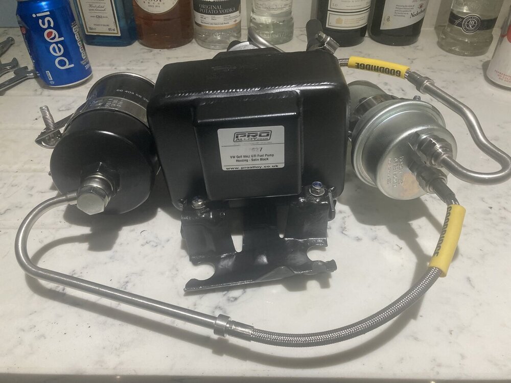

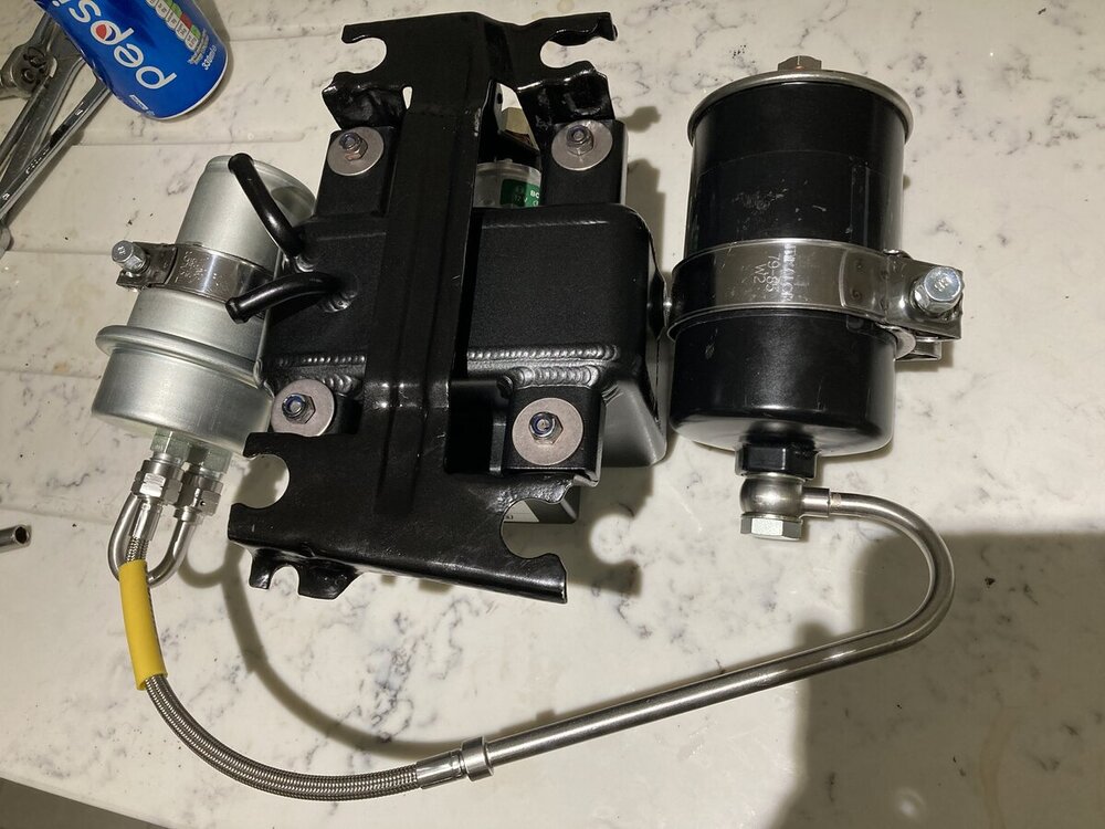

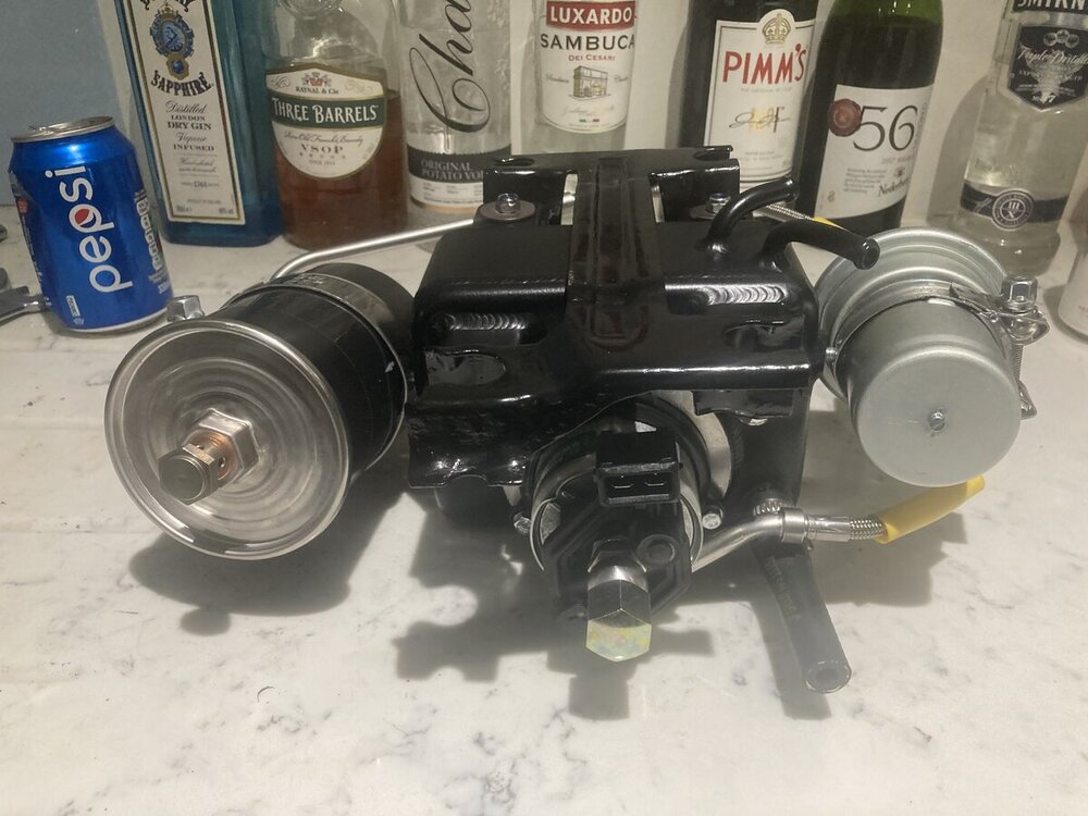

Keyo 49 Posted March 17, 2022 (edited) Another little fuelling project I’m working on for the KR - Pro Alloy big fan of my first experience of thier goods - stressfull been shipping things from all over Europe Mainly the housing buffers - bloody rip odd for the little bits. I also got myself some intank fuel line which is differnt then R9 and I believe is known as R10- R9 will melt in tank. https://www.merlinmotorsport.co.uk/p/rubber-in-tank-fuel-hose-by-cohline-per-metre-2190-0615 Edited March 17, 2022 by Keyo Quote Share this post Link to post Share on other sites

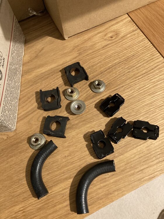

_Matt_ 33 Posted March 18, 2022 Looking lovely. As you know I am doing the same job on my mk2 16v too but sans the pro alloy housing. Thanks for getting me the clips, they look good 😄 Pro Alloy housing is a great bit of kit but too rich for my pockets today. Quote Share this post Link to post Share on other sites
