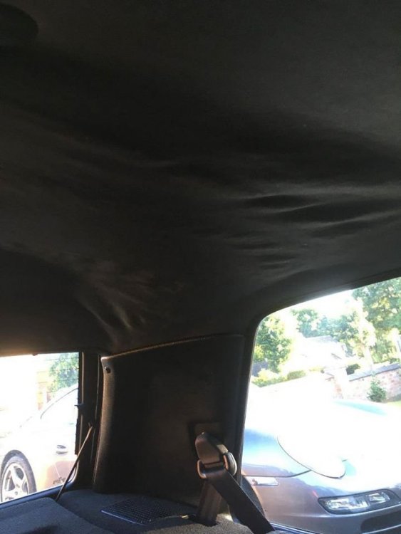

Keyo 49 Posted July 11, 2020 (edited) Sorry this is for my mk2 golf but you guys have had a fair few things trimmed in the past. VW Heritage replica OE vinyl headlining material combined with a new fibre glass back board - pictures below to illustrate the products. Very disappointed took the car to a trimmer as I know its a tricky job to glue the material on to the back board so sourced out a professional trimmer in Walsall. Looked brilliant once fitted but only after 8 weeks the glue has failed or the VW material has shrunk beyond the tolerance of glue (we had some hot days this summer). Picture below to show where it has failed on the rear corners. I saw the trimmer using a heat gun and not sure what glue he used - any advice if anyone else has used the same combination of a fibre glass board and Heritage material and had the same issues before I raise my complaint with the trimmer. Has anyone had this set up for a few years and no failure and if so what glue did they use so I can ask the trimmer to use it. Thanks bit disappointed right now as had to strip a crap load of the car to get the headliner out and spent a fair bit of money - went to a lot of effort to keep the stock look. π Thank You. Edited July 11, 2020 by Keyo Quote Share this post Link to post Share on other sites

Keyo 49 Posted July 12, 2020 Inspected in between the liner and headboard today as hot weather - glue is all gooie and runny - 100 percent glue fail due to heat - Iβm sure the trimmer will make out itβs my fault somehow π Quote Share this post Link to post Share on other sites

Keyo 49 Posted August 16, 2020 On 8/16/2020 at 8:35 PM, James. said: Have you tried speaking with Mk1 Capri owners (or similar) to see what theyβve stuck their leather hats (roof skins) on with ? No chap have not spoke out of the vag circle- the trimmer has done it Friday I stripped out the the headliner do he didnt crack every interior part so fingers crossed it is a success= looks awesome now but hard to take photos of it because of the darkness in the car- time will tell and another 30 degree devil of a day ha ! I was mocking him a bit and asked him if he made the old glue himself through lock down from a squirrel road kill and didn't see the funny side. Quote Share this post Link to post Share on other sites
