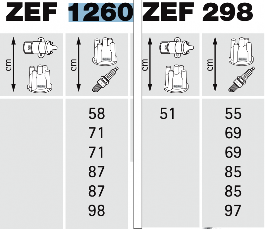

Cressa 44 Posted September 8, 2020 Okay, so I have just got the ones I took off out of the box to measure. I must be getting old as I noticed tiny writing on the ends and it they are Beru with the no. 030035255A 58, 71, 71, 87, 877, 98cm which means they are BERU ZEF1260 The fit of these was perfect for my coilpack, So my choice is narrowed down to the ZEF1260 or the Bosch ones which cross reference this part no. If anyone wants these new 8mm ones as I am going back to 7mm Quote Share this post Link to post Share on other sites

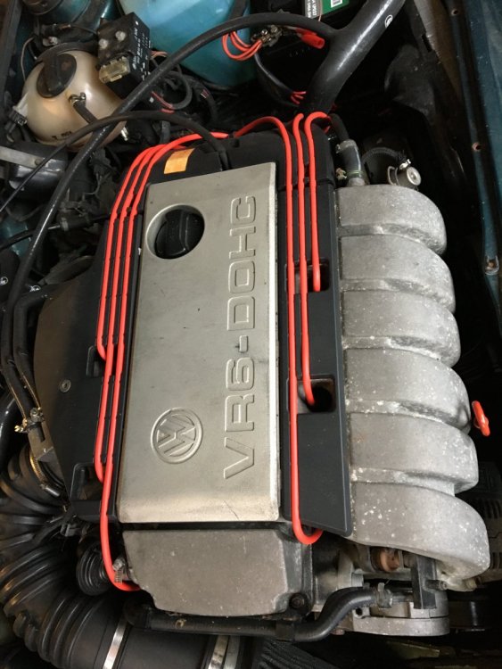

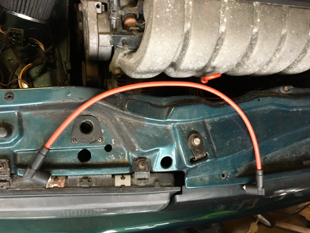

culshaw 1 Posted September 10, 2020 (edited) This is how mine look, and a pic of the spare lead. Not tight except for the one that isn't needed. I measured them up against the old leads. Edited September 10, 2020 by culshaw Quote Share this post Link to post Share on other sites
fla 9 Posted September 10, 2020 On 9/9/2020 at 3:44 PM, fendervg said: Doesn't sound right - distributor ones are longer than coilpack as the dizzy body sits further away from the side of the head. In any case, there wouldn't be any difference between OBD1 (all Corrado VRs are OBD1) and OBD2 with coil pack (as far as I know all OBD2 Golf AAA etc. engines are coil pack only). ^^^ this Leads are well made but when you put the metal clips on the ends they're very tight in the lead removal tool. I mentioned this to him when i bought mine some years back but he said he's never had any issues from any buyers...yeah ok.. Quote Share this post Link to post Share on other sites
Cressa 44 Posted October 11, 2020 (edited) On 9/5/2020 at 2:44 PM, JonnyHull said: FYI I've managed to buy some Beru leads. It seems they are still available for coilpack VRs but obsolete for earlier distributor VRs. Most places don't stock them unfortunately so they need to be back ordered from the manufacturer. Beru part number ZEF1260. What is the fit of these like? Reason I ask is the lengths these are the same as what is on the car, but on contacting suppliers they say I should have ZEF298 which are all 1cm shorter. I'm cautious as the Mr Retro ones I sent back were too tight for my liking. I am coilpack And I need to get this little project to bed... Edited October 11, 2020 by Cressa Quote Share this post Link to post Share on other sites
gotvach 10 Posted October 11, 2020 I wouldn't get ZEF298 if you have a coil pack. According to Beru's data the distributor leads are shorter so it's not just ZEF1260 with an extra coil-to-cap lead. Apparently mine (dizzy) were quite tight to fit but I believe this was the plug end rather than length issues. Original source: https://www.beruparts.eu/content/dam/marketing/emea/beru/catalogue/ignition-leads-connectors.pdf Interestingly the same document doesn't mention ZEF1260 for Corrado at all ; only 2.8 motors from 01.94 on 🤷♂️ Quote Share this post Link to post Share on other sites

Cressa 44 Posted October 13, 2020 Just throwing this in the mix. Slightly smaller than ZEF1260 and for coilpack models. And I have NGK plugs too, just a thought!!! Hmmm decisions.. Quote Share this post Link to post Share on other sites
Cressa 44 Posted October 24, 2020 Update time:- So the beru were blowing my mind and I didn't want to get it wrong, so discounted these in the end The Mr retro ones I had were too tight in my spark plug tool and one seemed too short. Credit to him I got a full refund I took a chance and have purchased the ngk vw 201 set. £52 delivered from autodoc. First impressions, slightly smaller than the ones I had but definitely a neater better fit, with a quicker start up. Chunkier solid metal ends that fit the spark plug tool perfectly with the coil pack end having a positive locking click on fitting.100% Happy with them and would definitely recommend them for a coil pack Corrado Quote Share this post Link to post Share on other sites
