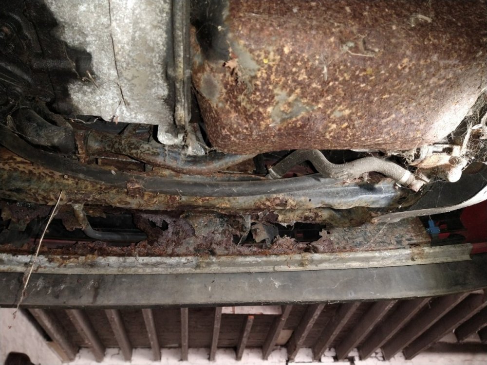

I've just bought my old G60 back with the hope of getting it back on the road.
I sold it in 2007 and it was driven by the new owner until 2010 and then it has been off the road since.
Before even trying to start it have noticed some pretty bad corrosion of the crossmember under the rad.  A quick search suggests this isn't uncommon and that the part I think I need (535199171G ?) is no longer available.  Can anyone confirm if this is the part I need and suggest any ideas on where to source one?
I didn't expect this to be an easy or cheap project but wasn't quite ready for such a depressing start!

Welcome along, sadly the radiator support is a very common thing to rust away, best to put up a wanted ad, there are a couple of corrado breakers out there. Chris Ferry aka Lilfuzzer.
Facebook has a lot of activity and is probably a better place to locate parts. You can contact Chris through there, not sure he’s on here much these days
I’d suggest you strip the front end off to be sure the front crossmember is ok as you’ll need to be in there anyway and check what else you might need. Check the wings, sills- especially at point it joins rear arch, fuel cap area as all are common rust spots 😁👍
I think these rad supports are getting thin on the ground - the sooner an aftermarket one becomes available the better- the Mk2 golf you can but all the subframes and supports aftermarket - lets hope the Corrado follows one day and they rust to heel on the rad support- leaky coolant might not help them.
