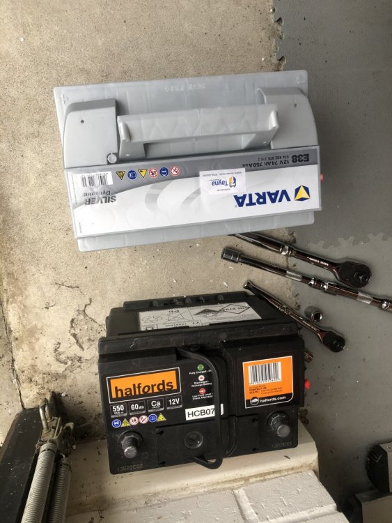

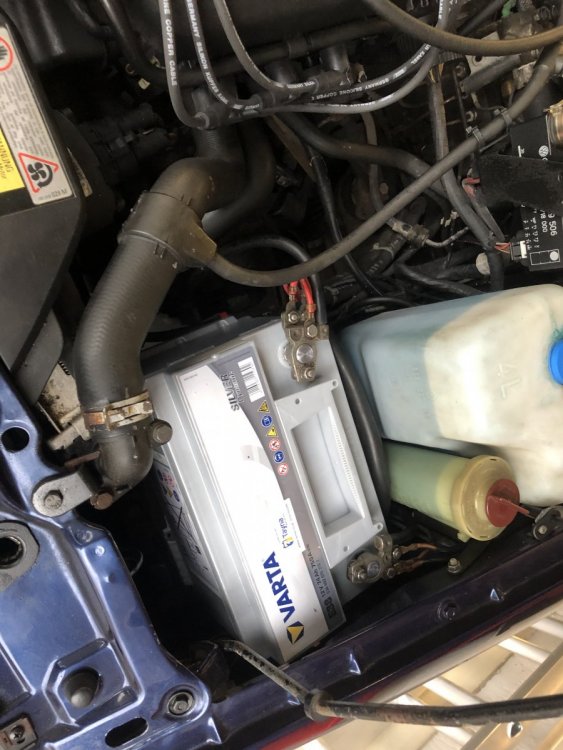

v11boy 10 Posted April 27, 2021 Hello All, Didnt find much on this before buying so thought I’d put this on to be clear/helpful. Bought the biggest in terms of power (and also size!). Got a new 74Ah Varta Battery - which the eBay add suggested wouldn’t fit. Link https://www.ebay.co.uk/itm/Varta-E38-Silver-Dynamic-096-100-067-Car-Battery-12V-74AH-574-402-075-/251195095628?_trksid=p2349624.m46890.l49286 E38 Varta Silver Dynamic Car Battery 74Ah (096 / 100) it’s massive, 278mm x 175mm x 175mm but it fits. Images attached show more dimensions and a shot of the Halfords battery that came out. Hopefully this will help someone in future! Quote Share this post Link to post Share on other sites
