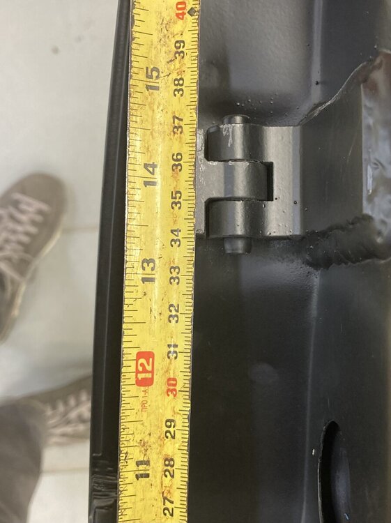

Corroda 11 Posted April 12, 2022 I bought 2 new Corrado doors from Heritage Parts Centre about a year ago and finally got round to getting them painted. The body shop just called to say the doors don’t fit as the hinges are in the wrong place. The car is a ‘95 model and I just wanted to check if the doors are different for early and late cars? I knew the front bumper, wings, bonnet etc changed for later cars, but assumed the doors were the same. Can anyone confirm they are different. Disappointed that I didn’t appreciate there was a difference, and I don’t recall Heritage stating they were year dependent. Fortunately the original doors are not bad, but will take a bit longer to remove some dings. Feeling a bit sick….. If they are for an early car then by brother has just lucked out on his 91 G60 🤔 Quote Share this post Link to post Share on other sites

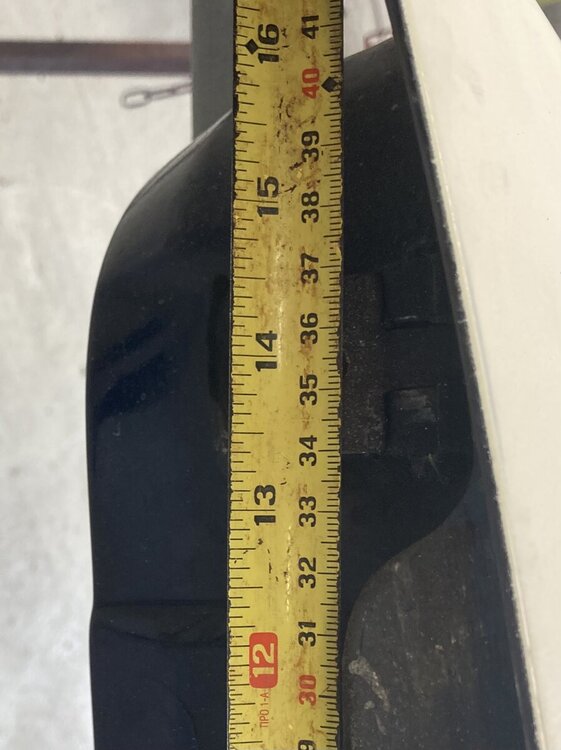

_Matt_ 32 Posted April 12, 2022 That is odd I have not heard of that. I have just checked part numbers on a 1989 car vs a 1995 car and they are coming up as the same part number. The parts diagrams can be wrong on early cars, missing early versions of parts but not normally on a late car. Are you able to get measurements on top and bottom hinges on your car? Attached a couple of pics of mine to help Quote Share this post Link to post Share on other sites

Corroda 11 Posted April 12, 2022 Thanks for the photos mate. I’ve done some more trawling myself which seems to confirm that there is no change to the doors from early to late cars, which is a relief. I will get in touch with the bodyshop and take photos of dimensions of the hinges on the car and on the new doors. Hopefully it’s a manufacturing issue with the new doors, and not the car that’s off 🤞 Quote Share this post Link to post Share on other sites

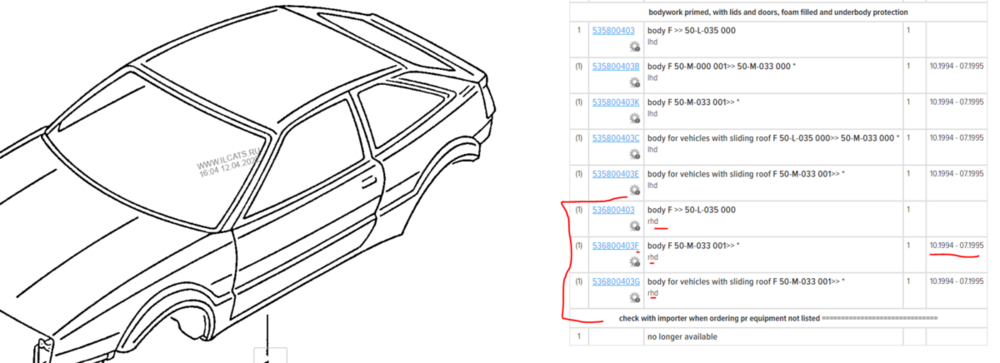

Keyo 49 Posted April 12, 2022 There was change in body - https://www.ilcats.ru/vw/?function=getParts&market=RDW&model=COR&modelcode=76&year=1994&group=8&subgroup=800&part=134000&pid=3181&language=en Quote Share this post Link to post Share on other sites
Corroda 11 Posted April 12, 2022 I can’t follow that link mate, but assuming that it confirms there was a change. I’ve phoned the bodyshop and the car’s currently in the booth getting painted, so I’ll go over at lunchtime tomorrow to take pictures and recover the new / now primed doors. it’s a good job they checked the doors before fully painting them. Quote Share this post Link to post Share on other sites
_Matt_ 32 Posted April 12, 2022 On 4/12/2022 at 1:33 PM, Corroda said: I can’t follow that link mate, but assuming that it confirms there was a change. I’ve phoned the bodyshop and the car’s currently in the booth getting painted, so I’ll go over at lunchtime tomorrow to take pictures and recover the new / now primed doors. it’s a good job they checked the doors before fully painting them. It's that part I put in red - 1994 on there was a body change but not sure what "F" added to part number as well. There is something odd on what you're experiencing - Keyo will measure his early doors to help clear it up. Assume your car is broadly standard, no known accident damage? Quote Share this post Link to post Share on other sites

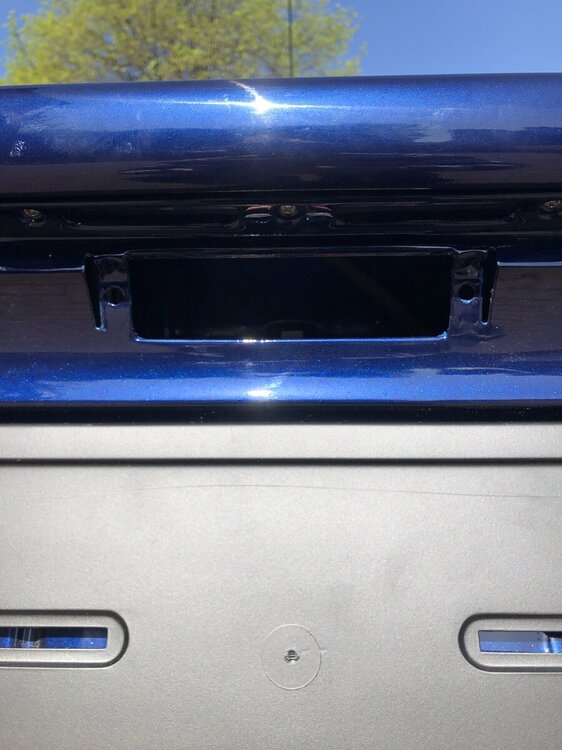

1xshaunx1 27 Posted April 12, 2022 On 4/12/2022 at 1:46 PM, Corroda said: I’ve added the part numbers from the Heritage invoice and list of prt numbers from LLL Parts, which list these for cars with central locking. the last owner had the car from 3 months old until 25 years old and said it had never been in an accident. Time will tell. The flap, is that the tailgate. Bet it’s got a hole for the third brake light Quote Share this post Link to post Share on other sites
Corroda 11 Posted April 12, 2022 Hi Shaun, I was wondering what the flap was referring to, and yes I do have an American style tailgate in my list of strategic spares……….which so far don’t seem to fit 🙄 Quote Share this post Link to post Share on other sites
Corroda 11 Posted April 12, 2022 I’m starting to think I may have ordered a ‘door for wardrobe’ as well 😏 Quote Share this post Link to post Share on other sites
_Matt_ 32 Posted April 12, 2022 (edited) I did wonder what that wardrobe door was all about. The tailgate you have is for a US spec car - not a bad move actually though - it means you can add a 3rd high level brake light and be seen more on the road. Edited April 12, 2022 by MJA Quote Share this post Link to post Share on other sites

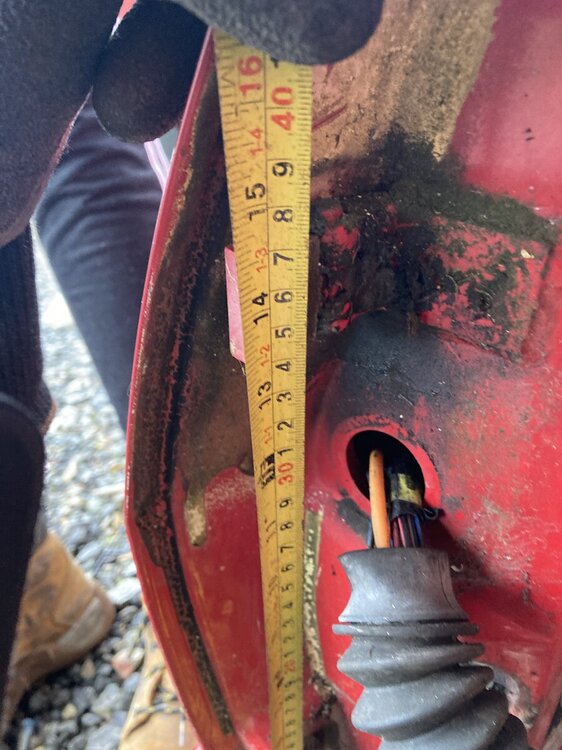

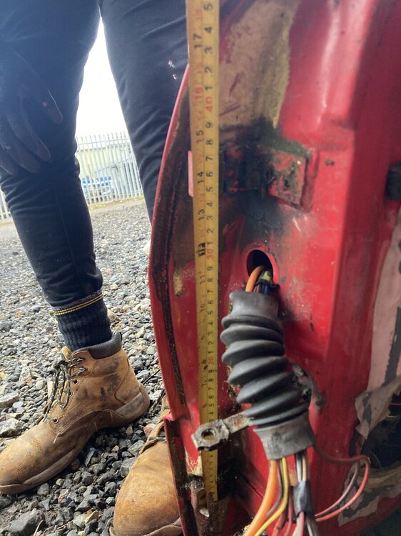

Corroda 11 Posted April 13, 2022 (edited) Right, so I’ve been to the bodyshop and there appears to be a tolerance issue between the new doors and the old doors that has caused the problem. They managed to get the drivers door to fit, and it was sitting nice against the wing, but was 5mm high at the B-pillar. The passengers door would not line up with the brackets on the body. It was out by 1-2 mm. Luckily the original doors are in good condition, rust free but with a worn hinge that will have to have to be shimmed. There are also some minor dings to be straightened out. The attached photos show that there is 1-2mm difference in the spacing of the hinges between the new doors and old doors. Unfortunately, I never took photos of the mounting brackets, but the bodyshop confirmed there is no chassis damage and I think the photos of the doors confirm a difference. I’ve read through some old posts, which suggested that Volkswagen had a jig for fitting the doors, but I can’t imagine that this would account for the bolt holes not lining up. So I don’t think there are early or late doors, just no adjustment on the hinges 🤔 Edited April 13, 2022 by Corroda Quote Share this post Link to post Share on other sites

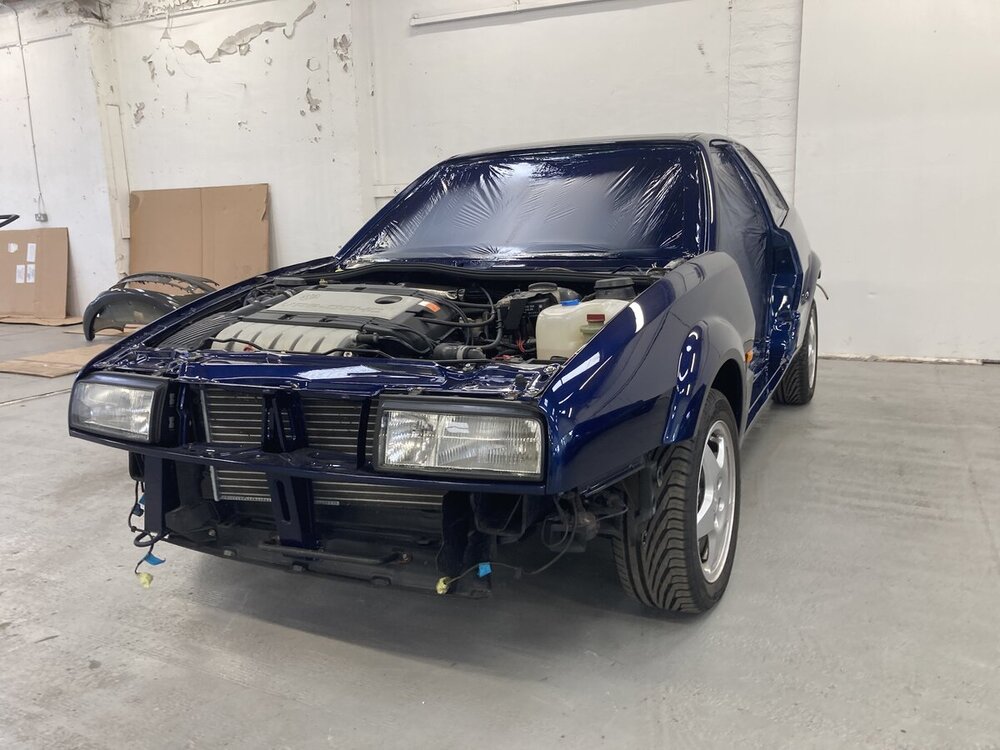

Corroda 11 Posted April 13, 2022 Feeling a whole lot better after seeing the car today. The guys in the bodyshop are taking good care of it and I think it’s going to turn out nice. I’ve been waiting 2 years for fresh paint, so the transformation is amazing. There’s a new windscreen getting ordered next week, and I’m looking forward to fitting the newly refurbished fog lights and indicators that just arrived back from Chris ‘Sprinter 53’. Quote Share this post Link to post Share on other sites
Corroda 11 Posted April 13, 2022 On 4/13/2022 at 5:00 PM, Keyo said: Measured early doors earlier they are the same. Thanks Keyo. I think we’ve proven that there are no early and late doors. Just some poorly made ones 👍 Quote Share this post Link to post Share on other sites
