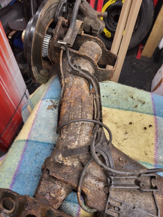

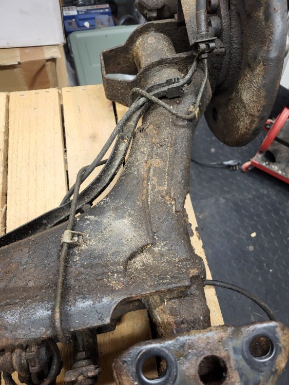

And I'm sure everyone loves a "before" shot of the rear beam:

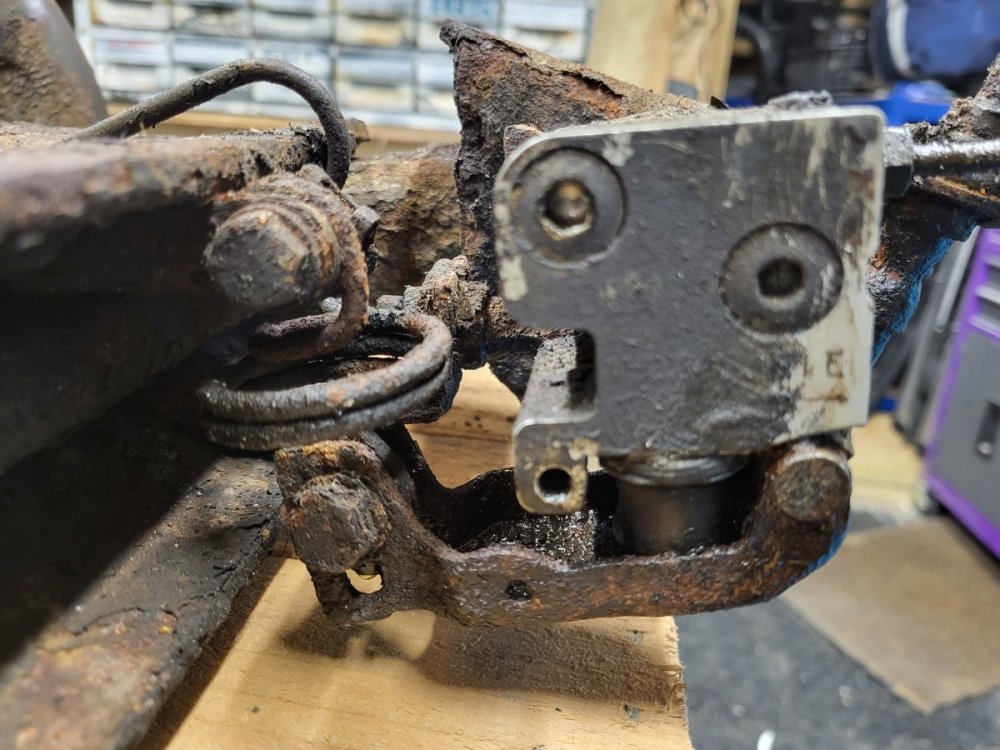

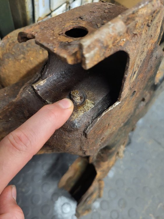

My next headache will be getting this bolt out from a spare subframe i'd like to get powdercoated. Any ideas welcomes, I have tried heat (the hot stuff in the yellow bottle), welding a nut on the end. No joy. Both sides are the same.

can you drill the stud out? Start with a small drill in the centre and work up in sizes? Get some WD40 in there too
Yeah i debated what to do with Powder Coating. I had a chat with the place that did it and they have put a zinc primer on and a "nylon" powder coating. They did a great job vs stuff I've had done elsewhere in the past. They even cleaned out the screw threads and have coated in areas missed on previous stuff (like behind the anti roll bar on the rear beam is all coated where as that was missed/light on the last place).
The snapped bolts are on the front subframe/front wishbone bolt. The trouble I'll have with drilling out is a normal sized drill bit won't reach from the hole with smaller drill bits. Worth a try though.

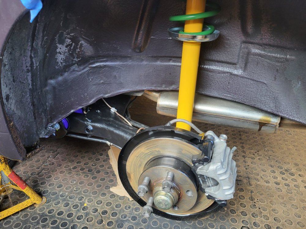

Updates, I just need to put the wheels back and do a string alignment and car is ready for MOT. Runs out on 12 May. There are couple of jobs to sort in the near future (fuel pump, waiting on the sender from classics and the wiper mech is pretty loose).
Summary of jobs done over the last year, car has has done less than 200 miles in that time 😞. It is almost ready to be used at last:

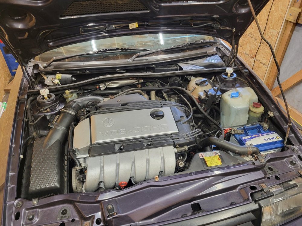

Engine Bay:
Timing chains, head refurb, 263 cams, clutch serviced etc at Stealth
Replaced Aux water pump with a Bosch unit
Lower hose coolant pipe
Injectors refurbished
Brake booster sensor fixed
New coilpack + spacer mod
Bosch CPS sensor
Oil pressure sensors + sender for cubby console dials
New fuel lines, filter etc

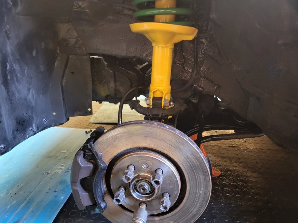

Front end:
New wishbones with R32 bushes
Inner and outer track rods
Ball joints
Top mounts
Rebuilt hubs with new bearnings, abs sensor and rings
New discs and pads on stock calipers. May upgrade in the future. They look crap in the pic as were done 200 miles ago.

Refurbished the rear beam with all new parts and brake lines, regulator and handbrake cables. Went for mk4 rear calipers. Discs pads and bearings were done 200 miles ago.
Koni TA + H&R springs
Powerflex rear axle bushes
