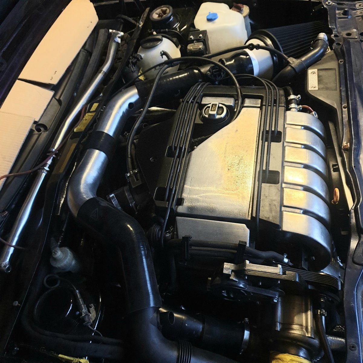

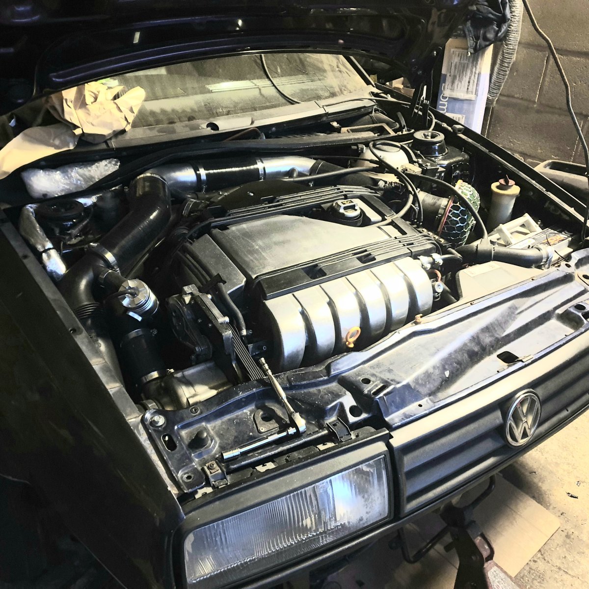

Cressa 46 Posted January 26 Welcome. That is a lovely looking interior, but I am jealous of what's bolted onto the side of the engine. I'm going to enjoy following this. Good luck Quote Share this post Link to post Share on other sites
bahnstorm 0 Posted January 26 Thanks yes interior is getting there,holset/rotrexcharger,should make fairly decent power Quote Share this post Link to post Share on other sites
bahnstorm 0 Posted January 28 Should be done by spring yes,need to sort fuelling for smaller charger pulley and pull ecu apart and fit dill plug/write map Quote Share this post Link to post Share on other sites
bahnstorm 0 Posted March 16 (edited) Pipework and rerouting everything almost sorted for intake etc... Edited March 16 by bahnstorm Quote Share this post Link to post Share on other sites
Cressa 46 Posted March 16 I must say, that does look like an o.e. build, congratulations. I'm jealous Quote Share this post Link to post Share on other sites
bahnstorm 0 Posted March 16 Thanks yes kept everything that most people bin ie carbon canister,pcv setup etc...nice big pipe run with air filter in oem battery space Quote Share this post Link to post Share on other sites

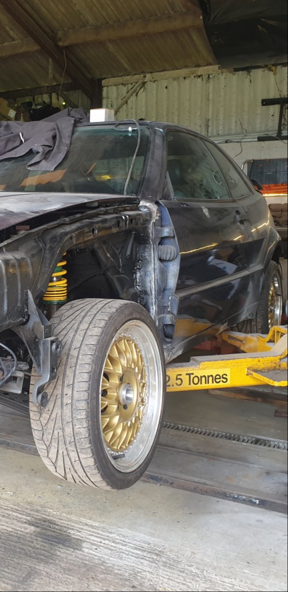

bahnstorm 0 Posted June 9 Bigger injectors and map done,idles nicely,all.panels removed half prepped should get some paint on shell next week or two,colour change to a custom xirallic black,all new suspension,bushes,lower arms etc fitted on 17in lensos Quote Share this post Link to post Share on other sites
