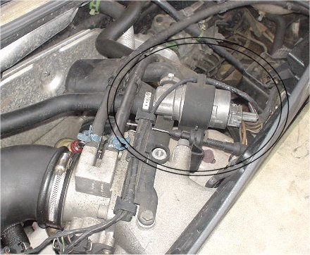

theRuler 0 Posted January 21, 2005 is it this? Quote Share this post Link to post Share on other sites
andy 0 Posted January 21, 2005 Yes it is, idle stabilisation valve, one part of the feedback loop that controls the idle speed on your engine. The electrical connections supply a voltage that determines how much air passes through the valve and therefore into your engine, thereby controlling the idle speed. Quote Share this post Link to post Share on other sites
fla 9 Posted January 21, 2005 Yes, and its one area that causes immense problems in a C. Quote Share this post Link to post Share on other sites

Kevin Bacon 5 Posted January 21, 2005 And indeed other VWs that use it....MK2 Golf 16Vs used to cut out at junctions aswell. 8Vs were better but still did it occasionally. G60 C's rarely cut out though, if ever, so I wonder if it's air volume related? Both the valver and VR6 flow a lot more air than the 8V/G60 engines and perhaps VW just underspecc'd the VR6 ISV and it's not man enough for the job..... prolly talking pap but it's just a theory that popped into my head :D Mine only cuts out once or twice a fortnight though, so it's not a major problem for me but others suffer daily occurences! Quote Share this post Link to post Share on other sites

Supercharged 2 Posted January 21, 2005 G60 C's rarely cut out though, if ever, so I wonder if it's air volume related? Maybe, I know the ISV actually vents off boost above 0.8 BAR.... Quote Share this post Link to post Share on other sites
theRuler 0 Posted January 21, 2005 right i got it off, and filled it full of carb / choke cleaner it can soak for a bit. couldnt i just leave it off and plug up all the holes? Quote Share this post Link to post Share on other sites
Kevin Bacon 5 Posted January 21, 2005 You could but it won't drive very nicely though. I ran around with the ISV disconnected on mine for a few days as an experiment and it was sluggish and idled too fast. Quote Share this post Link to post Share on other sites
theRuler 0 Posted January 21, 2005 i'll sling it back on tomorrow then. i hope cleaning this makes it all run better. Quote Share this post Link to post Share on other sites
