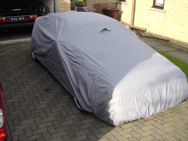

Its off the road now anyway, Ill let it sit and rot.

Off the road??? Your not giving up are you mate?
Nah, well, for now i suppose...Its sat like this while i use the new valver for a while. I miss driving the damn thing though...
