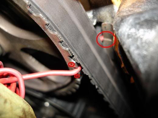

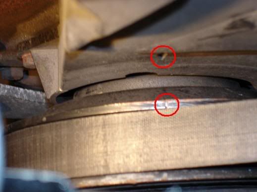

2_Door_fun 0 Posted March 15, 2006 Hi all. used the search to great affect. Just double checking thats all. Fitted a new timing belt n tensioner yesterday. I set the cam sprocket with the two dots against the top of the cylinder head. Crank set fine also. The previous owner had marked these points with red paint. Also he marked the Dizzy sprocket with red paint. I removed the cap from the dizzy and at the 11 oclock position was a notch. Is this No1 cylinder. If so his red mark on the pulley was about 1-2 teeth out? I set the sprocket so the rotor arm is facing the notch. Have I set it correct. Just want to check befor I go bolting on a new water pum,p n pulley wheels ect. Quote Share this post Link to post Share on other sites
Riley 0 Posted March 15, 2006 the 2 cam pulley dots line up with a line on the backing plate (as pic) or...theres a dot on the back of the pulley that lines up with the edge of the cylinder head like you say. :) crank pulley: best to check the above at the flywheel end too:replace crank bolt with one from a mk1 gti (dx engine) if you havent already,you need the washer too (i have part numbers). and yep,rotor pointing at the notch(no. 1) Neil. Quote Share this post Link to post Share on other sites
2_Door_fun 0 Posted March 15, 2006 Thanks bud. Much appreciated. I thought the dizzy would point at the notch. The previous owner has the Dizzy Spocket 2 teeth out. Maybe due to the cars vac system and ecu line being plumbed wrong. Soon sought that out. Got a new inlet manifold arriving tomorrow. The brass nipples for the ecu line are snapped off. So the vac line is plumbed into the Brake Vac unit!!!! Quote Share this post Link to post Share on other sites
Riley 0 Posted March 15, 2006 no probs m8 8) wow,some weird plumbing going on there! the ecu line runs to the throttle body/top nipple.the lower one on the throttle body is for the carbon cannister. and the brake servo line is for the mfa mpg reading :shock: edit:ps:the intermediate shaft(dizzy timing) is a right barsteward to get right,you can just compensate by turning the dizzy which is probably stuck solid :lol: love these corrado's eh.. hope you sort it m8. Neil. Quote Share this post Link to post Share on other sites
2_Door_fun 0 Posted March 15, 2006 Hi Mt. here ya go. Take alook I have a new manifold on the way. You gota love Ebay. the nipples have been snapped off and plugged with wood screws So I priced up the butterfly block at the dealers. I would need a new one and 2 gaskets....Gaskets were £2 each and the 1" thick by 4" square block was.....£1157+vat :shock: Oh and 1 had never been orderd...Ever. So I went on Ebay....and got one...? So the mfa pipe actually runs to the servo? So i leave that conected? Cheers Quote Share this post Link to post Share on other sites
