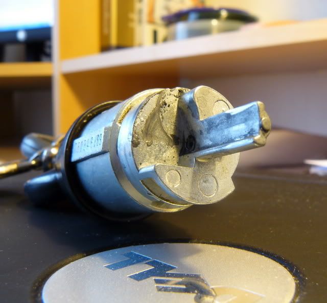

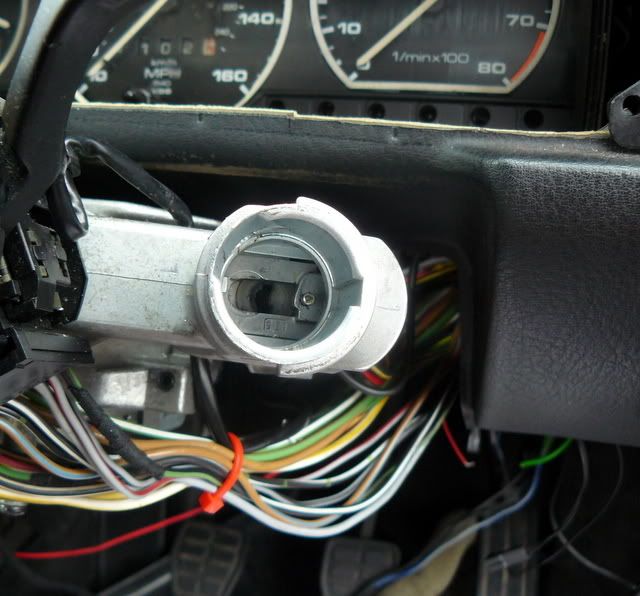

Dec 1 Posted September 1, 2008 Cheers for the info! :wink: Drilled the ignition barrel out and the problem is indeed in the lock mech. There is a plastic 'L' shaped piece on the mech that rotates when the matching 'L' shaped bit on the ignition barrel is turned. The plastic bit on the mech itself is pretty worn and more C than L shaped. :roll: Could get a voltage at the starter when I turned the mech with a flat head screwdriver, but I guess the key barrel cant make a good enough contact with the worn part. Quote Share this post Link to post Share on other sites
Toad 0 Posted September 1, 2008 Can you put a picture of the part up? I might have one I can send you... Quote Share this post Link to post Share on other sites
Dec 1 Posted September 1, 2008 Here are the offending items! The L shaped bit at the end of the key barrel And the part it mates into in the lock mech. It's the white plastic part in the centre. Actually looks better than it really is in the photo. I cant see how it could be removed from the mech itself though? Quote Share this post Link to post Share on other sites
