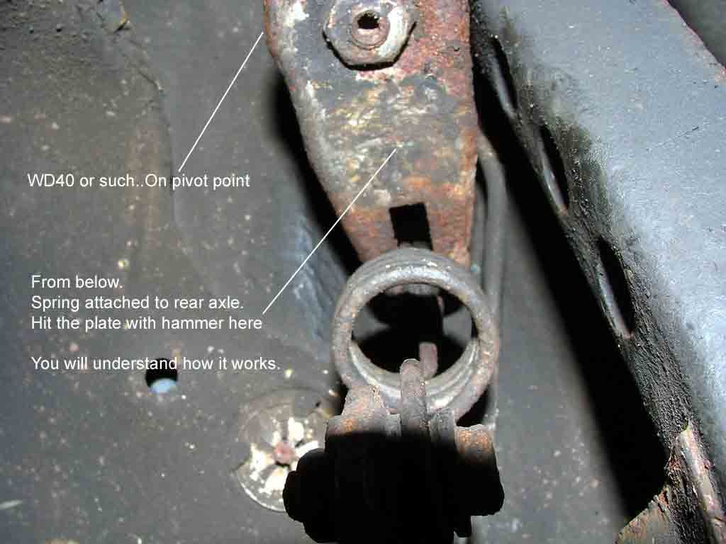

Supercharged 2 Posted May 14, 2006 The valve probably just needs unseizing mechanically... Look for the block with brake pipes going to it near the rear axel, then locate the spring mechanism next to it, spry loads of WD 40 on it and try and 'free' it with a hammer (being careful not to hit the brake lines) - MOT testers are used to doing this on VW's! Quote Share this post Link to post Share on other sites

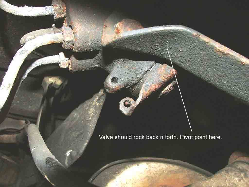

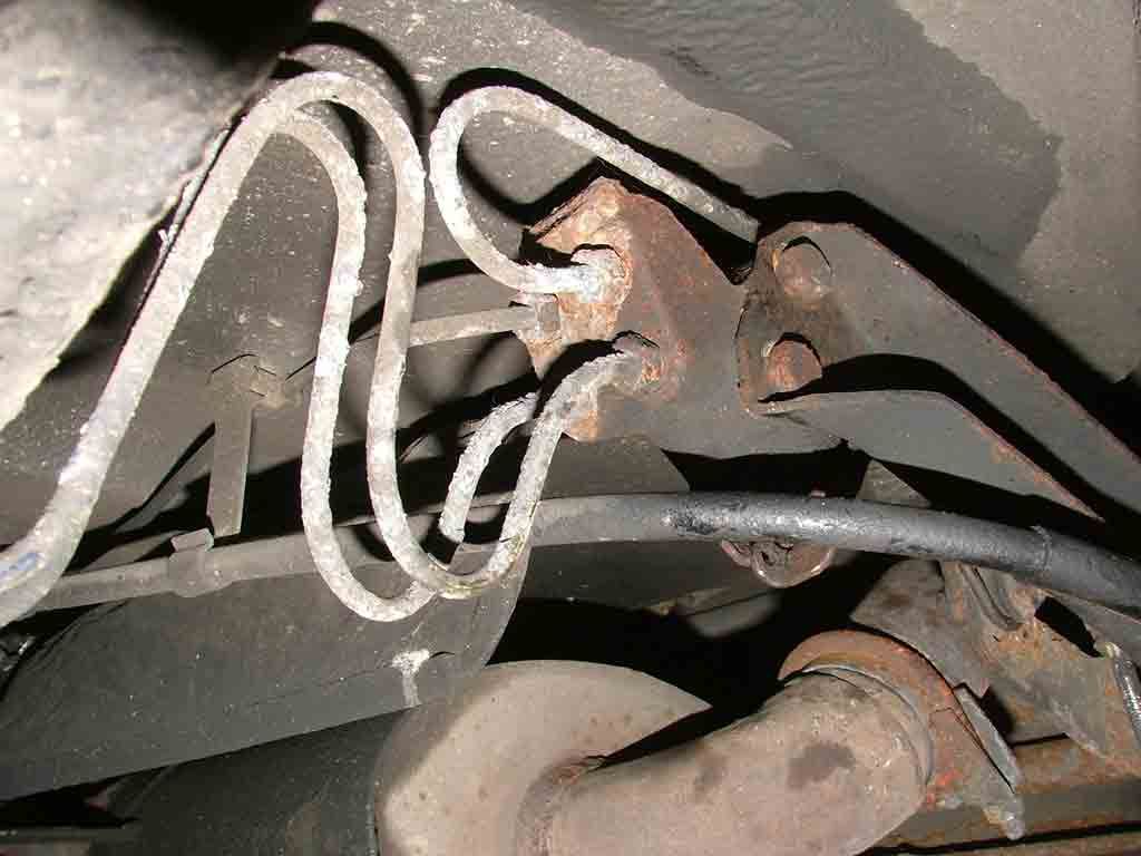

2_Door_fun 0 Posted May 14, 2006 I Failed my MOT on the bias valve being seized. WD40 and a hammer :lol: Soon soughted it. These are the lines going into it. Quote Share this post Link to post Share on other sites
CazzaVR 0 Posted May 14, 2006 2_Door_fun, thanks for the pic! Where did you put the WD40, and what did you actually wack with the hammer? Could you bung some arrows on the pic? :wink: Cheers Quote Share this post Link to post Share on other sites
2_Door_fun 0 Posted May 14, 2006 2_Door_fun, thanks for the pic! Where did you put the WD40, and what did you actually wack with the hammer? Could you bung some arrows on the pic? :wink: Cheers Here ya go mate. My cars of for its retest 11:30 tomorrow morning here's hoping :roll: Quote Share this post Link to post Share on other sites
CazzaVR 0 Posted May 14, 2006 Thanks matey, you're a star :) Pics are worth a thousand words. Best wishes for your retest! Quote Share this post Link to post Share on other sites
