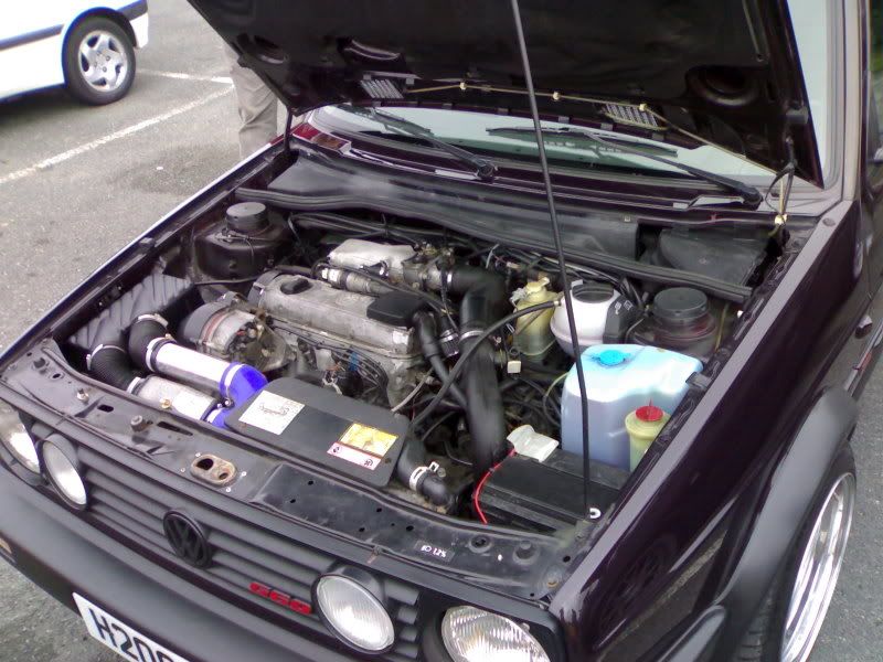

_Monkey 0 Posted May 16, 2006 Ever heard of swg motorsport? The guy there is desiging an airbox for twin inlet chargers. Picture's a bit pants, but you get the idea. Quote Share this post Link to post Share on other sites
Walesy 0 Posted May 16, 2006 Yep, As far as I know they're still finalising the design but they should be ready soon :) Quote Share this post Link to post Share on other sites
Dubcharged 0 Posted May 16, 2006 Oooh i like that box, same principle as my twin cone setup on my rallye. Quote Share this post Link to post Share on other sites
G60SC_Stoney 0 Posted May 16, 2006 im liking that too. have to get one when they are available!! Quote Share this post Link to post Share on other sites
Riley 0 Posted May 16, 2006 that does look very smart 8) ! but personally i dont think there will be a massive advantage in using the original air box? i reckon it may help keep the actual charger more 'evenly cool' but not really get 'cooler' air through? better having the induction coming from lower down/more direct i think? neil. Quote Share this post Link to post Share on other sites
Shaggy 0 Posted May 16, 2006 that air box looks really cool! i would probably get one even if it didnt do much for extra power! Quote Share this post Link to post Share on other sites
Riley 0 Posted May 16, 2006 :lol: yeah,tempting! will the rubber hose from the original inlet side also fit the other side? think it should do from memory? neil. Quote Share this post Link to post Share on other sites
Neil VR6 0 Posted May 16, 2006 That twin entry system looks the nuts, much better than a boost return IMO. Probably need to run a feed from the brake duct with that though and it's gonna be sucking like a goodun a WOT. Much more than the airbox box was designed for. I'd say an exhaust and downpipe (or manifold). At the moment you're pushing a load of air in the front and it's all restricted when it comes out the back. Also a FMIC is gonna be essential soon (then you'll need to sort the fuelling) Quote Share this post Link to post Share on other sites
Dubcharged 0 Posted May 16, 2006 On my twin cone setup, i used a heat shield and a big duct from the removed foglight to the hole where the carbon canister used to be. i found that boost was higher earlier in the rpm as the charger had more area to draw from therefore was more efficient. Made the car feel stronger in mid-range. only thing i'd like to investigate with this airbox is that the charger will be drawing in air on both sides but from the same area downstream of the filter element. This could cause some turbulence issues in the airbox as both sides will be pulling air against each other. Will need to investigate to confirm my thoughts though. Quote Share this post Link to post Share on other sites
