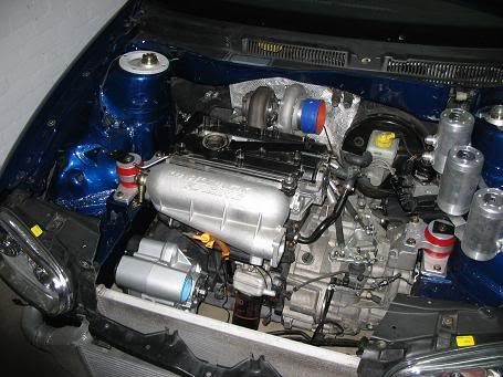

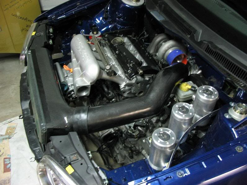

carpoid 0 Posted June 9, 2006 Hows this ..... !! Quote Share this post Link to post Share on other sites
DaveVR6 0 Posted June 9, 2006 VW are building 1.4 compound charged engines for the new golf which produce a healthy 170bhp! Theyre also building a 2ltr to go in the mk6 golf, god knows what power thats gonna put out Quote Share this post Link to post Share on other sites
BeavisJem 0 Posted June 9, 2006 Hows this ..... !! Can you give me any more info about this car? Wonder what kind of power its pushing? Bevaisjem Quote Share this post Link to post Share on other sites
biggerbigben 0 Posted June 9, 2006 Its Roy Kenton's Mk4.. don't think its finished yet.. he is friends with JD Engineering.. should be good for 500+ bhp I would have thought. Ben Quote Share this post Link to post Share on other sites
Henny 0 Posted June 9, 2006 20VTG60?!? Woah! Cool... 8) Quote Share this post Link to post Share on other sites

B4LJX 0 Posted June 9, 2006 this is a uk car??? i've seen this on other sites saying its a guy in austria??? Quote Share this post Link to post Share on other sites
bcstudent 0 Posted June 9, 2006 Well it would appear to be a left-hand drive car. Quote Share this post Link to post Share on other sites

W3RKD 0 Posted June 10, 2006 Roys car has come along way since those pictures posted above. i would imagine the supercharger on this set up wont be clutched it will just run a slightly larger pulley to stop it revving the arse of itself. I also disagree about it being a waste of time on the 8v head now we have them flowing well it makes staying 8v a very good option. Back to Back on the dynos there was no differance between our big valve 8v and a modded 16v head. Quote Share this post Link to post Share on other sites

carpoid 0 Posted June 11, 2006 Here's the link to those pics BeavisJem, http://forums.vwvortex.com/zerothread?id=2075109 Quote Share this post Link to post Share on other sites
