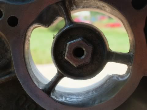

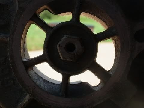

flusted 0 Posted June 28, 2006 This is what i wanted to do Standard Ported thats easy enough Quote Share this post Link to post Share on other sites
Spykee 0 Posted June 28, 2006 WOW! is that a full blend? does only 3 legs on hte exhaust not weaken the structural integrty of the charger at all? Quote Share this post Link to post Share on other sites

veeDuB_Rado 0 Posted June 28, 2006 Can someone explain what porting is? To me it just looks like cleaning it? :oops: And what's it's benefits? [/hijack] Quote Share this post Link to post Share on other sites
flusted 0 Posted June 29, 2006 Its basically removing any sharp edges or obsticals in the airflow Quote Share this post Link to post Share on other sites
GazzaG60 0 Posted June 29, 2006 is that yours done. gotta help with flow somewhat. not sure on the strength issues though. i heard a long while back maybe 4 yrs now that 3 was not too good an idea but again personal preference and experience with this type of stuff plays. i was told to avoid the 65mm pulley but its been great and the charger has been fine. Quote Share this post Link to post Share on other sites
Polo Classic 0 Posted June 29, 2006 Only one of the major German tuners do that kind of RS2-porting now. I guess theres a good reason for that....... I causes more stress on the supports makes the scroll more prone to vibrations. Kinda like buying 6 spoke rims and cutting away 3 spokes to improve brake cooling :cuckoo: , These charges have been known to blow up from everything less than 1K miles and up combined with smaller pulleys (72-65mm) Also remember if you are going to port your charger, that if your grinder slips once, that is enough to make an expensive paperweight out of your charger Quote Share this post Link to post Share on other sites
