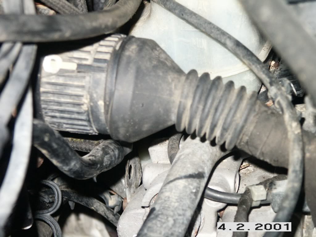

and this thing is also making noises dont know what it is maybe it also has somthing to do with my idle PICT0769.jpg
Turn up ur speakers and sorry about the big pic cant make it smaller
