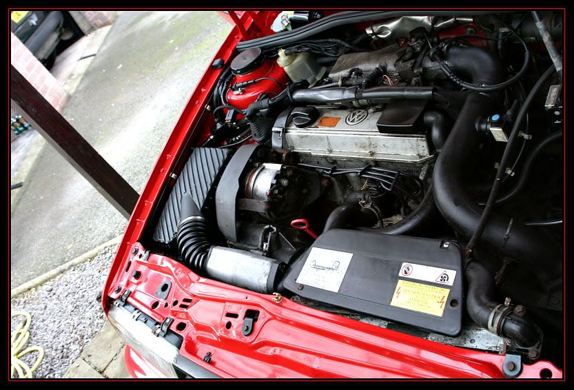

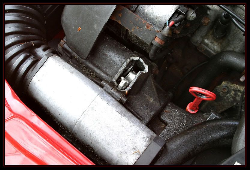

ewang33 0 Posted November 7, 2006 I've just sealed a deal on a G60. Well chuffed (I think). Trouble is, it needs a new charger. I haven't removed the thing yet, but it looks pretty bad! See pic >> I'm not sure which charger to go for though.. the options (as far as I can see): • G-werks (Hi Darren) can supply a brand new unit, fully rebuilt, with a good guarantee for the best part of a grand. • L&S Cartec are selling new units on eGay for around 700 bucks, 1 year guarantee. As far as I can make out (translated badly) they sound pretty good. • Again on eBay, there's a fully working second hand charger, removed to make room for a turbo conversion. I've emailed for more info. • Or, buy a charger (eBay) that needs a rebuild, for the second time. Has been flowed to stage 4 by Jabba. This is my first G60 so I'm not 'up' on all the different pulleys, chips, double belts etc etc.. I'm thinking I need to get it running in it's standard form first. What would you do? Cheers Ewan The damage: ::::::::::::::::::::::: ::::::::::::::::::::::: ::::::::::::::::::::::: Quote Share this post Link to post Share on other sites

Supercharged 2 Posted November 7, 2006 ewang33, just bare in mind that the whole intake system will need to be cleaned and the engine checked for debris as well as fitting a new charger... Engine looks fairly standard which isn't a bad thing but also budget to replace those original parts that wear out at this point in time... If the charger has been neglected then also check there is nothing else major on the car that needs imediate attention I hope it's cheap! Quote Share this post Link to post Share on other sites
Tempest 0 Posted November 7, 2006 Eeewww, the usual secondary shaft hole. Probably a later G-Lader with a rubber seated eye, in which the secondary shaft is located. Those were meant to absorb any wobble in the shaft, but alas did give a few times, too, with the damage as shown in your piccie. As Supercharged said, make sure there is no debris in the boost pipes, intercooler, throttle-body, intake manifold. Best to fit a metal sieve in the boost pipe which prevents any future debris caused by charger explosions to get into the engine. It may cost you 5 bhp, though, as I found out on Vince's RR at Stealth. L&S Cartec are a reputable company over in Germany. Quite a few of my Germ,an G60 mates deal with that company. I would personally not buy a 2nd hand charger off ebay. 2nd hand yes, but as long as you know the previous owner well (like I did, when I bought mine to keep as a spare), which you often don't with bay sellers. Tempest Quote Share this post Link to post Share on other sites

ewang33 0 Posted November 8, 2006 I wouldn't by one of ebay (without prior inspection) as we have ended up with far to many expensive paperweights in the past. Regards D A bit of a risk I realise now :oops: Fingers crossed this one will be ok. I won't leave feedback until G-werks have had a look of course. How much am I looking at roughly for a refurb please? Looking at the pic of mine.. is this now a big paperweight? Can any internals be salvaged if this eGay one is crap? Quote Share this post Link to post Share on other sites
