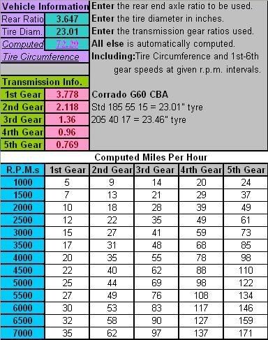

Gearbox:- Corrado CBA
Tyre:- Goodyear Eagle F1 195/50 x 15
Top Gear gives 24.049 MPH/1000 RPM and a top speed of 149.105 MPH at 6200 RPM
Engine speeds in top gear:-
30 MPH = 1247 RPM 40 MPH = 1663 RPM 50 MPH = 2079 RPM 60 MPH = 2495 RPM
70 MPH = 2911 RPM 80 MPH = 3327 RPM 90 MPH = 3742 RPM 100 MPH = 4158 RPM
Top Speed in 1 gear = 30.359 MPH

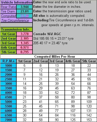

And changes into 2 gear at 3475 RPM dropping 2725 RPM
Top Speed in 2 gear = 54.161 MPH
And changes into 3 gear at 3982 RPM dropping 2218 RPM
Top Speed in 3 gear = 84.332 MPH
And changes into 4 gear at 4407 RPM dropping 1793 RPM
Top Speed in 4 gear = 118.642 MPH
And changes into 5 gear at 4933 RPM dropping 1267 RPM
Top Speed in 5 gear = 149.105 MPH
It really isn't that important, it's more important to have a box that drives well, but yeah it does seem like a target just because the CBA won't even get close! :) I'd spend £50 on a dyno run to find out what the engine is doing throughout the rev range. Are you struggling for traction?
not struggling for traction in the dry as such but the 1st and 2nd are too damn low, can't change gear quick enough!
I will get it dynoed and see what the figures are and take it from there.
