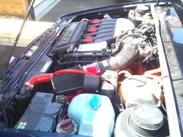

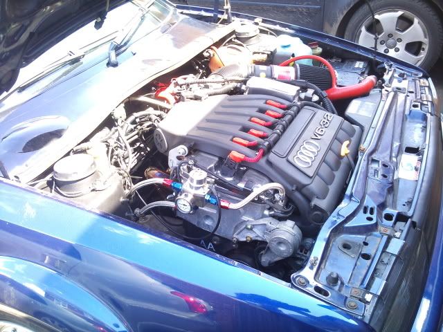

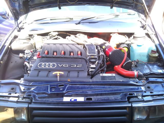

quicky1980 0 Posted May 1, 2010 What Ive been doing today: Tidied up the fusebox area and fitted the plastic trim under the dash to make it look like it used to. My interior is no longer half dissasembled. Took some pictures after tidying the engine bay slightly and fitted the last exhaust clamp to the back box. Was going to visit herisites this weekend to see if we could work out why my exhaust fouls so badly but something has cropped up at home and need to sort that out first. Now Im pretty much sorted, I will save up for a remap and sell some spares on to recoup some cash. But my intention is to do a write up of how I did the fitting so anyone who is brave enough to do the same can have a better definitive guide than the existing one on the forum. Next phase of the project will be to rebuild the rear subframe, feels skittish around corners so I think the rear needs a spruce up. Quote Share this post Link to post Share on other sites
herisites 0 Posted May 2, 2010 Looks like a really tidy install mate! No worries about not making it to mine, I'm not a million miles from you so you can pop round any time! If you want some help writing up a guide gimma a shout, I might have some useful pics as well. Quote Share this post Link to post Share on other sites
swiftkid 1 Posted May 2, 2010 looks like a real nice install and very fast turn-around, glad to hear your pleased with it. Are you having the same throttle response issue as herisites? ie a bit twitchy on low throttle? Quote Share this post Link to post Share on other sites
