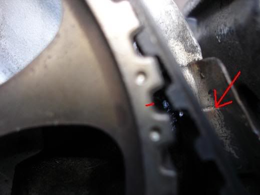

Riley 0 Posted May 8, 2007 Right,this is getting on my t|ts now :lol: G60...New crankshaft bolt,and the gudgeon type pin was mint,no wear at all. It can only go on in one place so it has to be aligned perfectly for the timing mark. Flywheel... The timing mark does not match/align with the mark on the crank pully. How? Surely the only way is a twisted crank? :? or the marks are just put on the pully/flywheel willy nilly :? Ps:Im looking at the right mark arent i? The -o Neil. Quote Share this post Link to post Share on other sites
Shaggy 0 Posted May 8, 2007 you will prob find that the Flywheel hasnt been put back on correctly.. and is now out compared to the crank pulley mark?? There should be 2 marks on the flywheel... one at TDC another 6 Deg BTDC.. The crank pulley mark is at TDC.. that is rarely wrong tbh.. it maybe out by +/- 1 degree but least it will give you a better idea of where the engine should be as this is rarely removed unlike a clutch flywheel. Quote Share this post Link to post Share on other sites
Riley 0 Posted May 8, 2007 Cheers m8... Thing is...ive done the ignition timing using the crank mark,but everyone on here says to use the flywheel? But then...am i running a tooth out also? :? Quote Share this post Link to post Share on other sites
Shaggy 0 Posted May 8, 2007 yeah but if the marks on the flywheel are out then not only is the cam timing out.. the ignition timing is out also... :D For now just time everything up using the crank pulley mark.. you will need to dial in 6 degs of advance on a timing gun tho.. to set it up correctly when doing the Ignition timing. Quote Share this post Link to post Share on other sites
Riley 0 Posted May 8, 2007 Aye,ive always used a gun at 6deg :) All the marks line up mint at the crank side. But the problem is that,if i then go to look at the flywheel where everyones always told me to set the ign timing...the marks are not in sight. :? If i turn the crank to line up the flywheel... Then check the crank pully...the mark is way out...But the cam is still somewhere near...as it turns slower than the crank. If ya know what i mean. :? :lol: Quote Share this post Link to post Share on other sites
Riley 0 Posted May 8, 2007 Trying to think of a way to explain this better... Imagine the cam pully mark lining up with the slit on the back plate...You can tweak the cam round either way just a little bit,but yet it can still sort of be lined up. Its a crap alignment idea... Anyway. If doing the above,just tweaking the cam a little bit,it moves the crank pully mark/flywheel mark more because of the difference in pully sizes. I tweak the cam one way,and its lined up with the crank...no flywheel marks in sight. Tweak it the other way,its lined up with the flywheel but the crank mark is waaaay before tdc. Quote Share this post Link to post Share on other sites
Riley 0 Posted May 8, 2007 Right...here we go.As you can see,cam alignment mark. You can move the cam just slightly and still have it lined up if you see what i mean. But when you do move it just a little,it throws the crank/flywheel well out...By around a tooth :? Quote Share this post Link to post Share on other sites

Riley 0 Posted May 8, 2007 Aye,and yours goes alright up against mine Manny! :shock: This is what i can't understand though...when i bolted the crank pully on,it was a super snug fit,it cant go on wrong...so how could it be out? And guys...just trying to get my head around this bit. :oops: If i now use the flywheel to set the ignition timing...it wont be aligned with my crank/cam surely? :? So am i running a tooth out? Do i need to align the flywheel mark with the camshaft mark? It revs slowly compared to manny's (chappy above) and it seems heavyish on fuel,it also intermittently farts when hitting the throttle. Neil. Quote Share this post Link to post Share on other sites
jezzaG60 0 Posted May 8, 2007 Flywheel can't go on in any orientation..... and if your using a mk2 gearbox.... then things are completely different because you have a rod change 'box. Its still very difficult to get it wrong though unless you remove the dowels that line everything up. If it were mine i would set my cam timing from the flywheel and the cam pulley. If it means moving your cam timing 1 tooth then you shouldn't have any problems giving it a go. I'm not that keen on the bit of pressed steel with some nick cut in it. Quote Share this post Link to post Share on other sites
Riley 0 Posted May 8, 2007 Ok cool. 8) Am i right about the marks being out then if i leave it as it is currently,and THEN set ign timing with flywheel? Just getting confused... So if i pop a driver in number 1,find roughly tdc,and then check which mark (crank or flywheel) is nearest to lining up... and then set my cam to which ever it may be? Lastly,where is the exact alignment on the cam? having the slash on the backplate anywhere in the middle of the two dots? :? Neil. Quote Share this post Link to post Share on other sites
