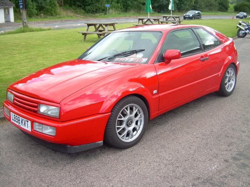

CorradoVR6-Turbo 0 Posted August 27, 2007 Cheers Chris i needed some raddo loving :lol: Rob Heath that was not even at half its full potential this time when i do this VR i WILL finish it :lol: But for today i fitted back stock grill and black badge on with eyebrow spoiler,changed back plinth from red to black,removed single wiper and fitted stock back on and will fit lupo arms and blades at some point. Got the headling out as it needs a good clean and thats it for now but in future its a full respray with widened arches then turbo 8) But untill more money is saved im just going to enjoy the superb ride on avos and 15" wheels with 50 profiles :lol: Share this post Link to post Share on other sites

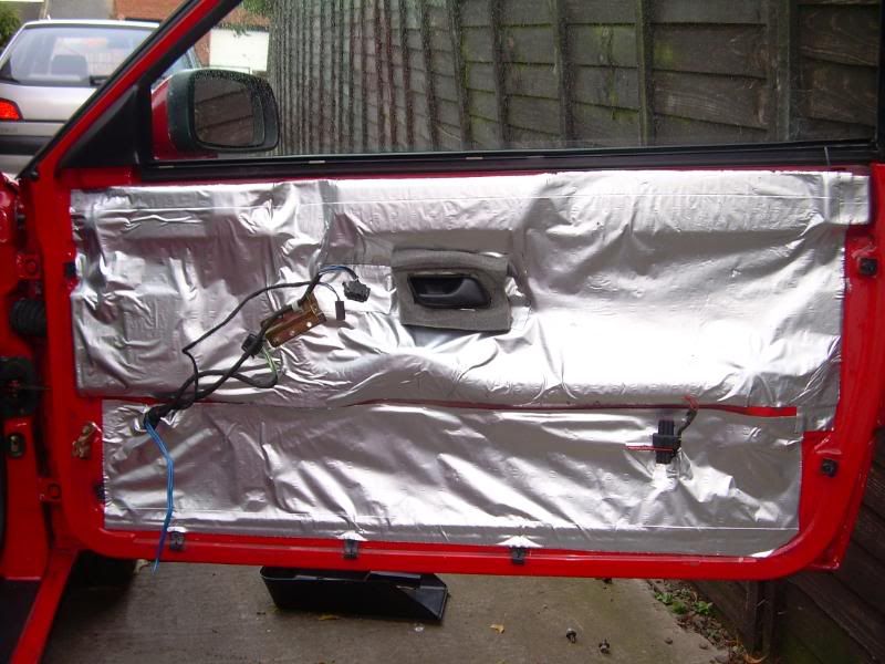

CorradoVR6-Turbo 0 Posted September 22, 2007 Just a update,done some ICE install,sound deading the rear and door cards,ran alpine speakers up front with crossovers and tweaters in dash,6x9 pioneer at the rear with 500w JVC sub and amp. Powered by my old Alpine 8) Done some work on my garage and droped a plank of 3x2 on the rear quater and now i have a nice dent,how hum ...would have pulled the raddo out but ive got the suspension off the front. Off to Zante tomorrow night ...woo...hoo 8) Share this post Link to post Share on other sites

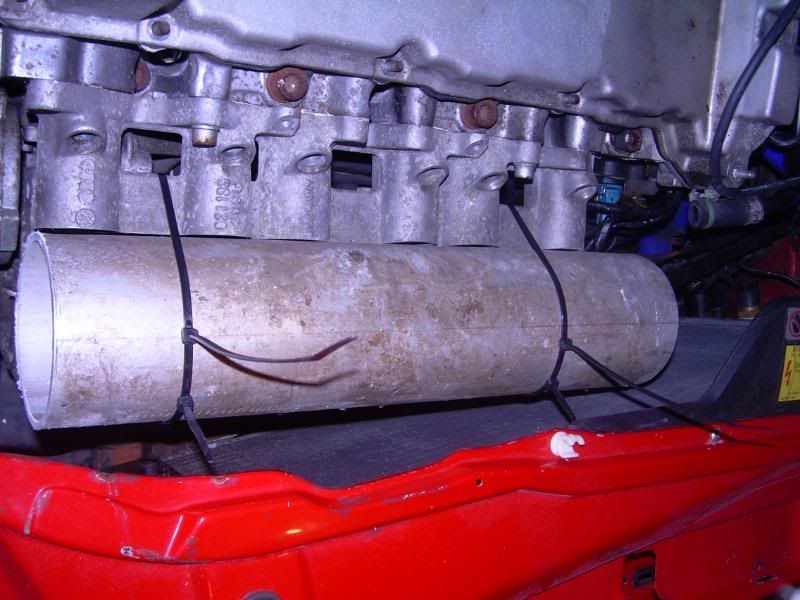

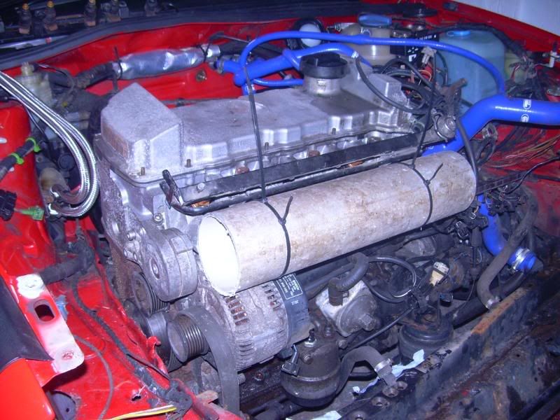

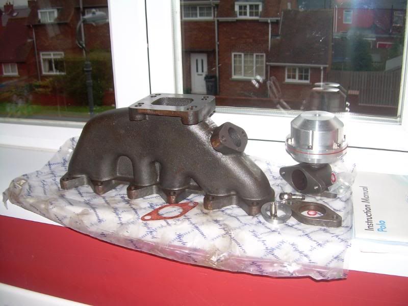

CorradoVR6-Turbo 0 Posted December 26, 2007 CoxyLaad said: wots with the gaffa tape? :) its a old car,need something to keep it together :lol: Been a while,little update,started to do the VR turbo again,after the last one it was way to addictive to give up :lol: Here are a few starter pics... Share this post Link to post Share on other sites
StormchargedVR6 0 Posted December 26, 2007 Nice work james, great to see you back on track mate :) You using intercooler again. Share this post Link to post Share on other sites
CorradoVR6-Turbo 0 Posted December 26, 2007 No mate,charge cooler...its works out cheaper than the front mount and far less work. Need to get some more alloy to finish manifold,its coming on nicley,unlike the shimmel the throttle will point to the charge cooler,it will also use the stock rail 8) Share this post Link to post Share on other sites
StormchargedVR6 0 Posted December 26, 2007 what cooler you using mate, got to say the Schimmel very good but not cheap. Got a S/runner elbow if any good to you. Share this post Link to post Share on other sites
CorradoVR6-Turbo 0 Posted December 26, 2007 StormchargedVR6 said: what cooler you using mate, got to say the Schimmel very good but not cheap. Got a S/runner elbow if any good to you. Im using a XS POWER charge cooler,ive heard good right up's on these and its only £ 90 for the cooler,im using a motorbike radiator with a built on fan for the heat exchanger and a fuel pump to pump the fluid around,the bike rad has a filler cap on and the rate of coolant that will be pumped around will eliminate the need for a reservoir tank on the back. The SP log is nice,but its out of my budget,cant see why there would be any performance difference in my home made one and the SP one and the best bit it only costing me under £50 to make. 8) What is this S/runner mate,any pics Shaun? Cheers James Share this post Link to post Share on other sites
