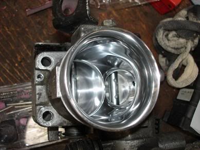

flusted 0 Posted September 4, 2007 heres 1 i did Quote Share this post Link to post Share on other sites
JMC 0 Posted September 4, 2007 Aha, so it looks asthough you took some off both side there, and took it down to a knife edge. Have you done anything with the butterfly vlaves themselves?? Quote Share this post Link to post Share on other sites

JMC 0 Posted September 9, 2007 Ok, I've started porting mine - attached, and yes this is just the first stage of porting hence it's still rough. Question for the experts - is the idea with this 1st part of the of the throttle body to make the diamater of the hole bigger or just smooth off the flat surfaces?? And why?? Quote Share this post Link to post Share on other sites

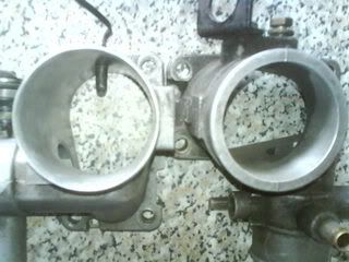

flusted 0 Posted September 10, 2007 smoothing that entry should be fine, just some people find it easier to bore it out. heres the difference Quote Share this post Link to post Share on other sites
JMC 0 Posted September 10, 2007 smoothing that entry should be fine, just some people find it easier to bore it out. heres the difference Wow, that is a huge difference :shock: . Puts my filing into context. Now, if only I had access to a machine shop :? So is porting this section like porting a manifold - a trade off between torque and horsepower?? Just been thinking about it, and surely there is a trade off between fast gas flow (through a smaller but flowed and flat surfaces removed hole) and more but slower gas when it is bored out. Or have I done my usual and gone off on a complete tangent :lol: Quote Share this post Link to post Share on other sites

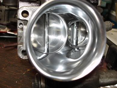

JMC 0 Posted September 15, 2007 Right, done a bit more and started removing some of the rough marks from the file. Also taken some material out from within where there was a sharp edge (Image 2, and I presume that was where you were refering to flusted?). Came back in with hands looking like hey were from the Tin Man in the Wizard of Oz after doing this :lol: Ok folks, I still want to do more smoothing of it, but does it need to be really mirror smooth at the end?? Quote Share this post Link to post Share on other sites
flusted 0 Posted September 16, 2007 yeah thats looking good, still try and round off that edge on the second pic. Quote Share this post Link to post Share on other sites

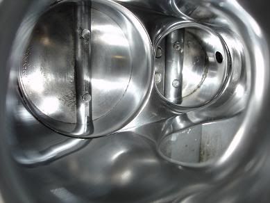

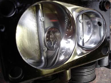

Riley 0 Posted September 16, 2007 Here's some pics of mine that i did a few years ago or sommet. I decided to venturi the entry...Definately gave a more snappy throttle response.Also ported and knife edged/polished. Quote Share this post Link to post Share on other sites
JMC 0 Posted September 16, 2007 Here's some pics of mine that i did a few years ago or sommet. I decided to venturi the entry...Definately gave a more snappy throttle response.Also ported and knife edged/polished. Wow that looks really good. I've been finding loads of imperfections in the casting of mine, so looks like I'm going to have plenty of polishing to do. Started on the other section as well, and have decided to take some off the entry both valves. Very rough at the moment, and am in the process of taking it all apart for easier access (man that thing is complex :? ). Cheers for the advice too flusted, will have another go at it. Quote Share this post Link to post Share on other sites
flusted 0 Posted September 17, 2007 i tryed to angle the divider towards the entry if that makes sense,as the air wont hit the small butterfly straight on because its off set to the big butterfly I gota take mine off today so il take some more/better pics Quote Share this post Link to post Share on other sites
W3RKD 0 Posted September 17, 2007 you havent yet touched the biggest restriction in the throttle body.. il add some text to your pic 2 later so you can see where to remove the material. Quote Share this post Link to post Share on other sites
JMC 0 Posted September 17, 2007 you havent yet touched the biggest restriction in the throttle body.. il add some text to your pic 2 later so you can see where to remove the material. Cheers Darren, get the feeling I'm going to need different tools though, as I've been doing this with a file and wet and dry so far, and am running ut of bits I can easily get at :lol: Quote Share this post Link to post Share on other sites
