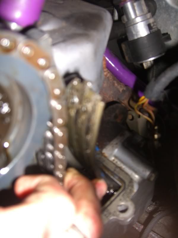

M15 VW 0 Posted January 1, 2008 Hmm, right we have found the cause of this..........finally. It is the upper chain tensioner. This has already been replaced once when the head gasket was done. (Before the rebuild) However, it looks like the tip of the upper chain tensioner has snapped off due to wear and there are two deep grooves in the tensioner itself where the chain has been rubbing against it (very deep, almost past the rivets). Any ideas on how this could have happened? Could the upper tensioning bolt be putting too much pressure on the tensioner pad? The chains were brand new when we rebuilt it and the upper tensioner pad was replaced a couple months previous to that and was fine on inspection during the rebuild. The only thing not to have been replaced was the upper tensioning bolt. Could this be the culprit for the damage or is there something else we should be looking at? Also, is there any way of sliding the upper tensioning pad off without completly removing the gearbox? Quote Share this post Link to post Share on other sites

M15 VW 0 Posted January 1, 2008 Sorry about the blur but this is the best pic we could take of the damage ....... Quote Share this post Link to post Share on other sites
peanut 0 Posted January 1, 2008 I had this problem with mine when the bolt tensioner got a little bit of crap in it blocking the oil way, this resulted in chewing the top pad up. By the way if you want another top pad (original metal with polymer layer and rivets) I have a brand new one you can have for free. Out of interest what were your symptoms for inspecting the tensioner pad? Im wondering if i didnt purge the tensioner bolt when i reinstalled it :( leaving air inside, or i over torqued it? would this lead to adverse pressure on the back of the pad or would the damper in the bolt compensate for this? Bugger is all ive got to say, especially as it looks like it was my fault, Bum :( Sorry Zed :( Quote Share this post Link to post Share on other sites
steve @ 0 Posted January 2, 2008 symptoms, it started to wine pretty badly. Then eventually started making a horrible sound. Mine looked pretty much the same as yours. I dropped the sump on mine after to clean the remains of the top pad, i'd recommend you do it as well as there were a few bits floating around.. Quote Share this post Link to post Share on other sites
