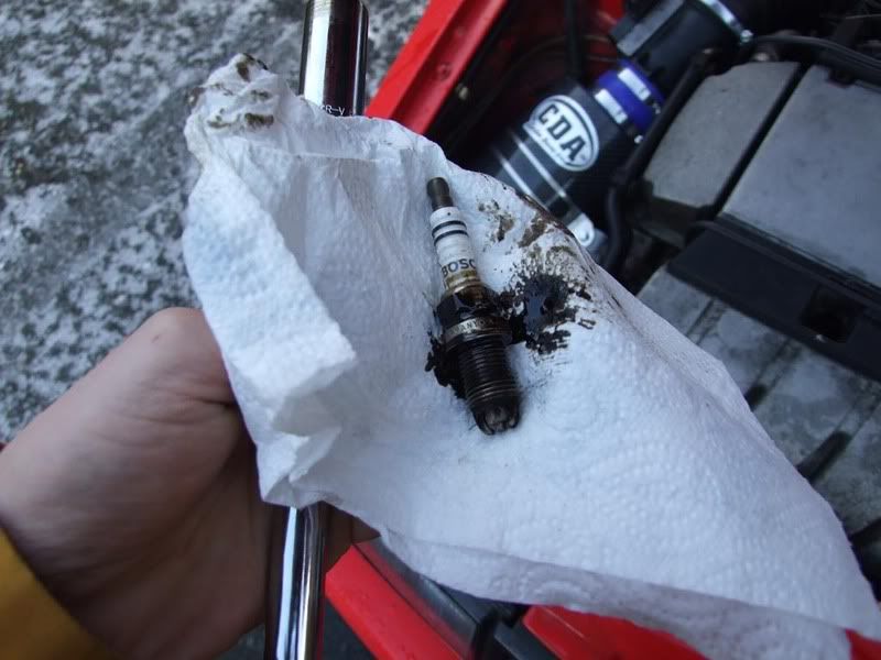

grimmy 0 Posted December 5, 2007 The head was rebuilt less than 6 months ago, but about 2 months ago it started misfiring. Starting checking the plugs and got to one that was covered in really hard crap... Cleaned that off and it was fine. This evening it started misfiring on the way back from putting a 500 quid deposit down at the garage for my new exhaust and bmc cda. So again I started taking the plugs out, 6 was oily so cleaned it off, still misfiring. Took the lead off number 2 and that was oily, so was around the plug, took out the plug that was also covered in oil so cleaned that off, but still its misfiring. How can oil get past the plug? Could it be leaking down from the head gasket? As i'm sure you've guessed i'm clueless when it comes to car mechanics... Its dark and raining so i'm not loving this, shall i take the plugs out again and make sure they're super super clean, and leave them out for a while for the oil to run off? Quote Share this post Link to post Share on other sites

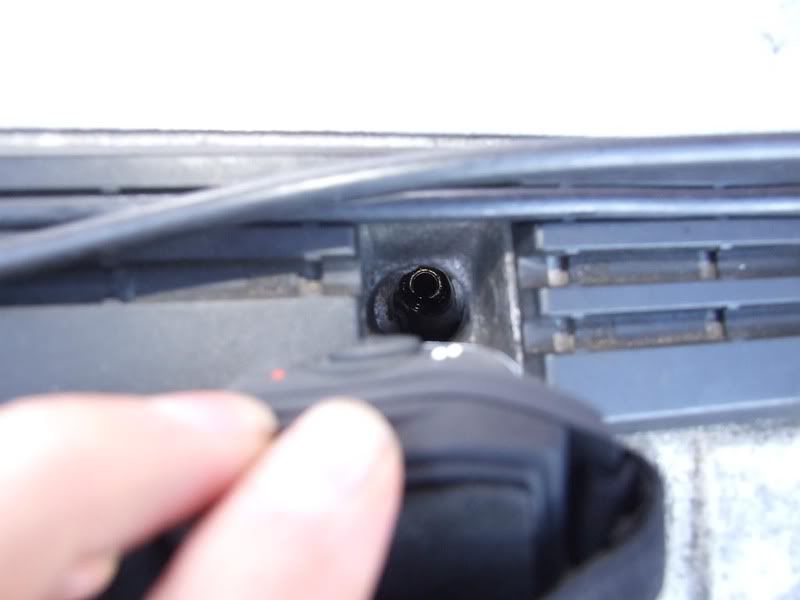

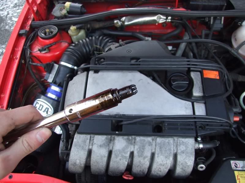

grimmy 0 Posted January 12, 2008 Well a month on and the dreaded misfire cropped up again. I started with plugs 2 and 6 which is where i had the problems before. To my horror i found a huge amount of oil sitting on top of the plugs again. All the bottem 3 cylinders 2,4,6 are covered in oil. Its hard to see from that last awful picture but down in the hole is a large amount of oil. It must be leaking down from the cam cover gasket. Having had the head rebuilt very recently should that be covered by them? Should i go and see them and ask that they replace the gasket? Obviously there is still the problem that there is oil getting onto the plugs 2 and 6 so i suspect rings or worn bore. Do i have many options here? If the bore is worn i thought that 1 and 6 are the main culprits. Would i be looking at getting it rebored or a new bottem end. Which would be the cheaper option? As you may be able to tell i'm fairly useless and just expect my cars to work :lol: I've already spent enough money on the car to accept i'm going to keep it and do what needs to be done to keep it running. Quote Share this post Link to post Share on other sites
steve @ 0 Posted January 12, 2008 Looks like the rocker cover gasket to me. I would replace the gasket and go from there. Quote Share this post Link to post Share on other sites
