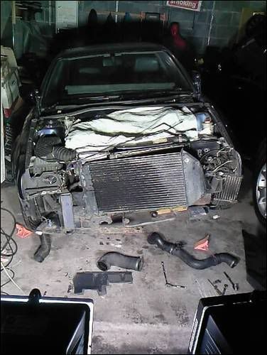

just_say_meth 0 Posted January 12, 2008 Yep it will be fine, provided as you say its dried properly :) While you have it off have you not thought of fitting a FMIC? Check out THS performance I am planning to fit either a Type 1 or 2 not decided yet 8) http://www.thsperformance.co.uk/cgi-bin ... PR=-1&TB=A Cheers Dan Yeah been thinking about it a while :lol: so bought this Its a rallye intercooler, just a trial fit but shouldn't need too much work to get it in :D :D The THS coolers sound good, never came across them when i was looking before. Cheers dan :thumbleft: Quote Share this post Link to post Share on other sites
