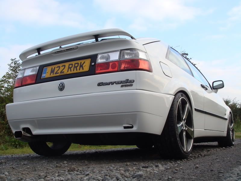

Danny B 0 Posted March 18, 2010 I like white c's but I think as with some of the other comments you need a bit of black to break it up.....maybe front grill, splitter and handles :shrug: - as you seem to be swaying towards !! sorry really dislike rears, all red looks great on white IMO :) Great stance though, looking good :salute: Quote Share this post Link to post Share on other sites
Wastegate86 0 Posted March 24, 2010 borbets look ace gota aggree prefer the black grill and chin spoiler but im bias keep the white handles though White Rados = SEX :lol: Quote Share this post Link to post Share on other sites
turbomagikz 0 Posted March 31, 2010 Hello matey Thumbs up !! white corrados ruled before "WHITE" was the in colour .... ive had white corrado for over 6+ years now ! i dont think that the corrado needs any colour codein of door handles grill splitter ect ? i think its sexy enuff as it is ....... just my opinion because WHITE is bright & well sex in your face ! .. as for the clear tail lights ... they are horible lol yerr horibble . now i know that because i have them on mine and still have ! but i sprayed them half red .... never even took them off car ... just masked them off and sprayed that red light stuff on them . . HOPE my little bit of "white corrado talk helps you " a couple of pics of mine that i aint drove for 4 months now .....cannot wait for the sunshine again . respect fella . ( HOPE you dont mind the pics ? its just so you can do your opinions against others ) cheers mark :shrug: :shrug: :shrug: Quote Share this post Link to post Share on other sites
STU175 0 Posted May 9, 2010 (edited) nice pics mark allways nice to see another white c ......is the best colour after all :clap: :clap: quick update fitted original rear lights and got another set to tint red...stuck on rear badges...and a good clean... just front grille and splitter to get round to...climatronic wiring-Golf from May 01.pdfImage030.jpg[/attachment:bbnadjxq] [ATTACH=CONFIG]83621[/ATTACH] Edited April 12, 2016 by STU175 Quote Share this post Link to post Share on other sites
borarob 0 Posted May 9, 2010 standard lights look 100 times better - i'd be tempted to leave them like that, and even put the side repeaters back to amber too.... Quote Share this post Link to post Share on other sites
