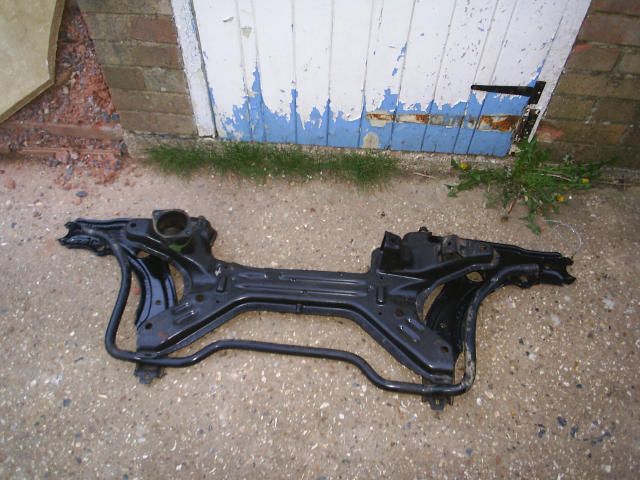

^^ These bits sticking out past the ARB at the rear aren't on the mk2 subframe... can I still fit it? (pic is of a passat subframe, but this bit looks the same as corrado)

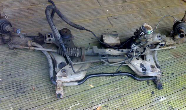

This is the frame I have now. It shows clearly the lack of metal plates back past the ARB, which bolt up into the chassis... are they just for extra support? The bolts used are M10x24 so are definitely not load-bearing mounts.
Perhaps the rear wishbone mount (vertical) on a mk2 acts as the rear subframe-to-chassis mount point on each side?
Any more thoughts welcome, cheers to the guys who commented so far.
I'm guessing that as the mk2 subframes are used on a mk2 (I do a degree you know) then there's no inherent risk / engineering issue with using it on a Corrado which AFAIK is mk2 chassis based anyways?
Will keep on degreasing it and see what it looks like. Wishbone bolt holes are still galvanised and have grease in! :clap:
The powers that be and I have decided that the Corrado must have the vibration block and the extra rear mounts for a reason and as such I'm gonna prep the mk2 subframe up and then sell it on.
