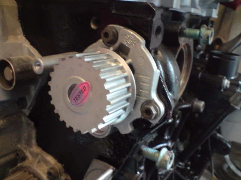

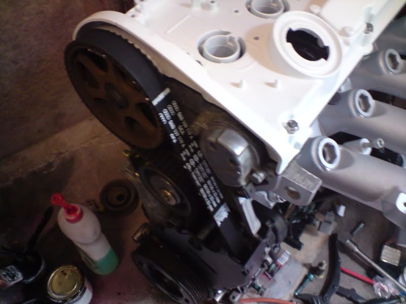

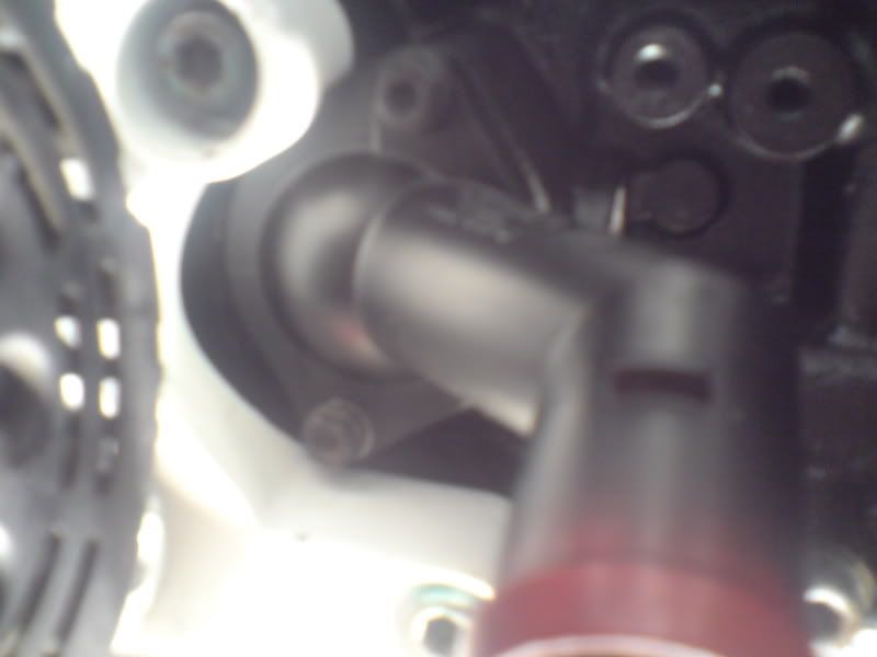

managed to change the timing belt and water pump today
new water pump in!
new idler bearing

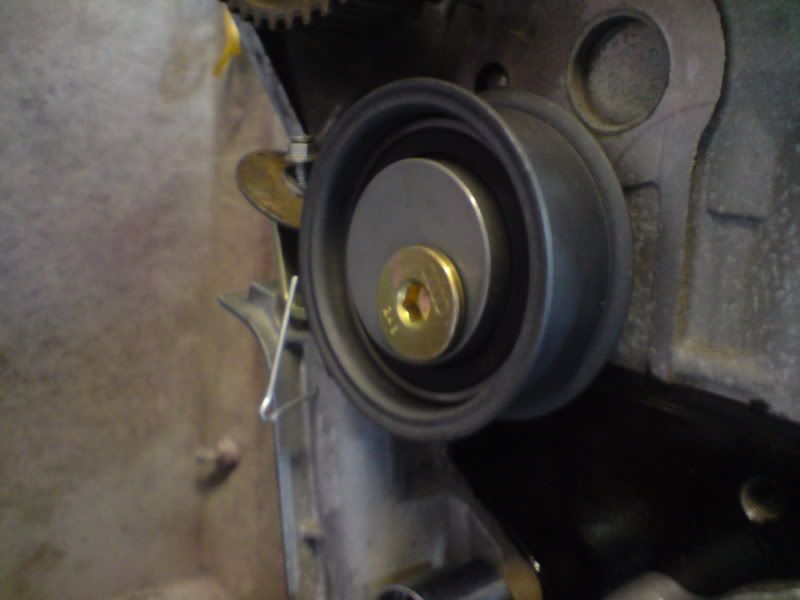

new cambelt tensioner

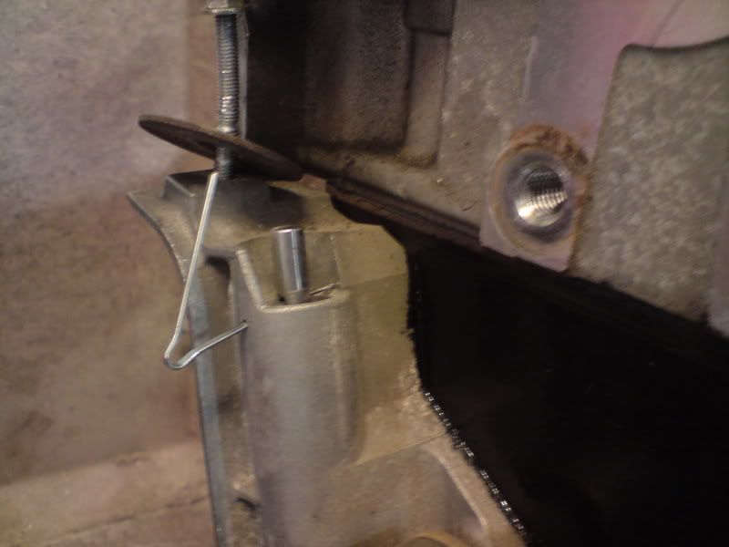

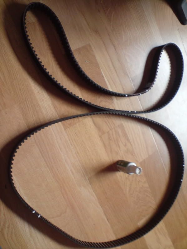

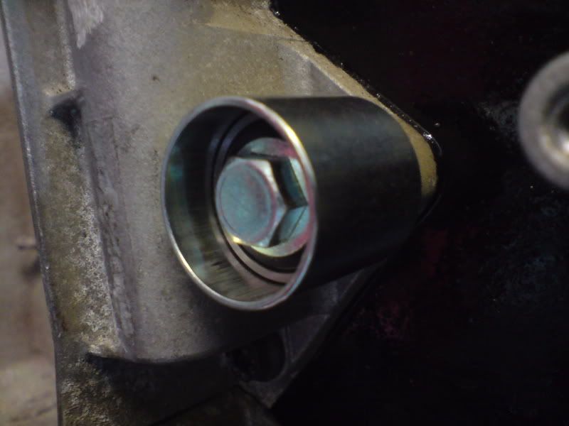

used an m5 bolt with a large washer to compress the old tensioner and stuck a split pin throught the hole to keep it down whilst i put the new tensioner in
before i took the belt off i made sure the timing marks lined up, One on the cam sprocket and cam cover and the other on the crank pully and the sheild behind it. I then made a few marks with tipex on the belt and sprockets. transfered the marks onto the new belt, double checking the correct amount of teeth between each mark.
all done

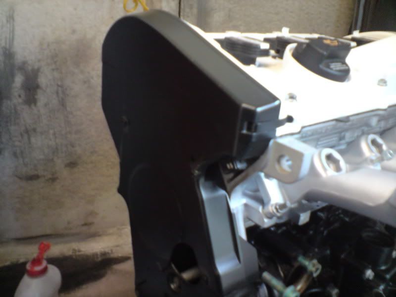

freshly sprayed timing belt cover
and a couple pics of it back together

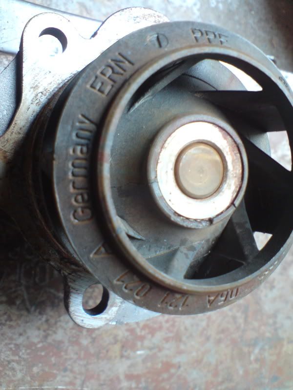

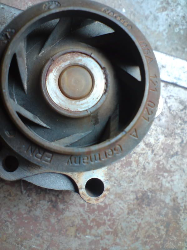

as for the water pump, i initially wasnt going to change it as the engine has only done 35k , glad i did now! the impellor was starting to crack

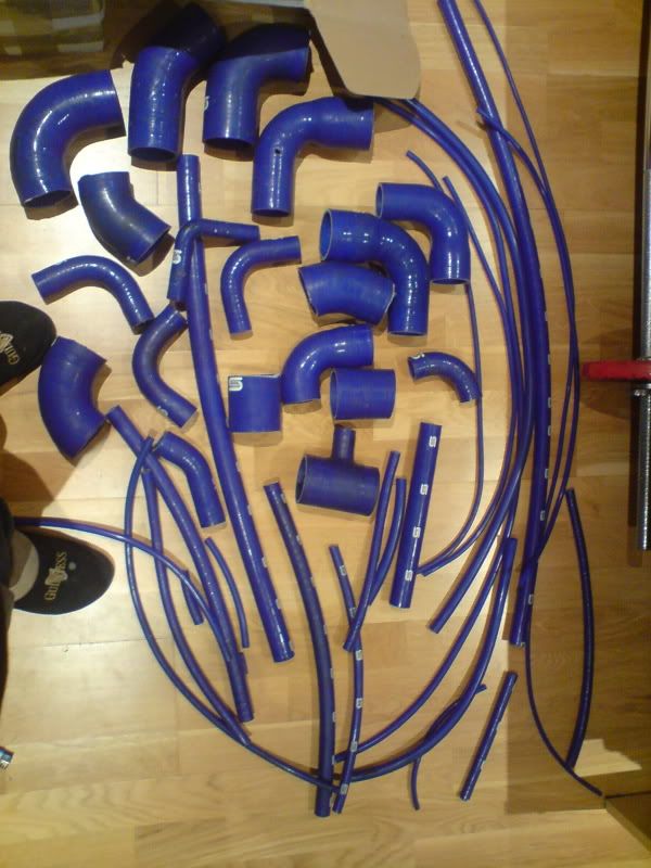

got these samcos off a club gti member who put a 1.8t in his mk3 golf. he decided he wanted black hoses so i got his old ones, need a bit of a clean but i think ive got plenty to be getting on with! and theres more to come lol

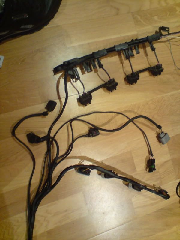

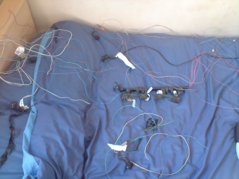

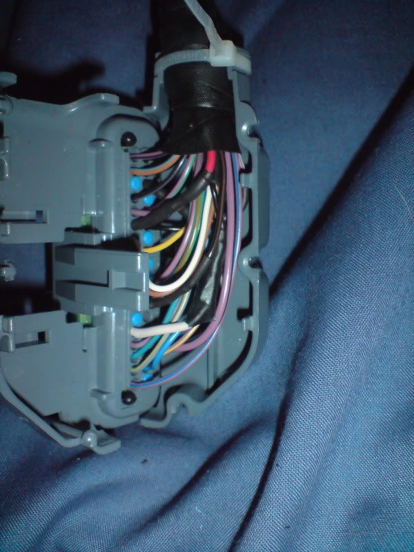

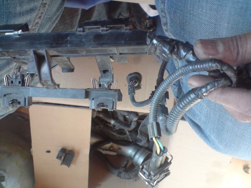

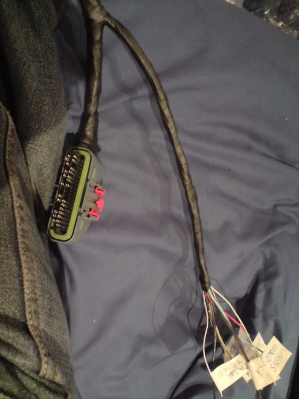

been working on the loom, its nearly done, just need a throttle positon plug , a lambda plug and power interface connector to use the existing power connections under the scuttle panel. The wiring notes qpeng supply are very easy to understand! there are loads of different engine codes listed with the corresponding colours (mine matched up perfectly) id recommend it to anyone.
Tommorow i will do continuity checks again just to ensure i have no shorts.
some of the loom to start off with
all split out from the insulation
The loom at the ecu connector
injectors, coil packs and most the engine sensors complete and wrapped
connector end with power connections spit off (which will go to the plug under the scuttle)
hehe yea,i love doing stuff like this! just spent the last half hour testing each wire from end to end and everything is a ok :D roll on pay day when i can buy more bits!

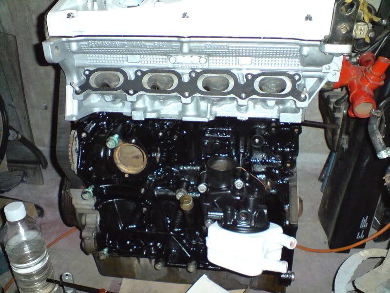

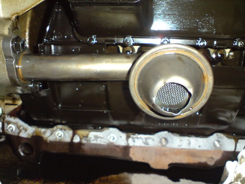

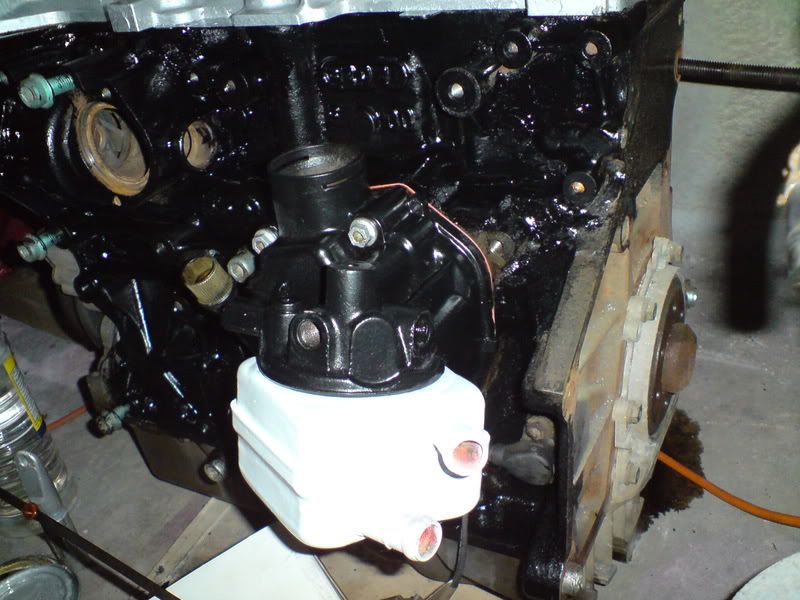

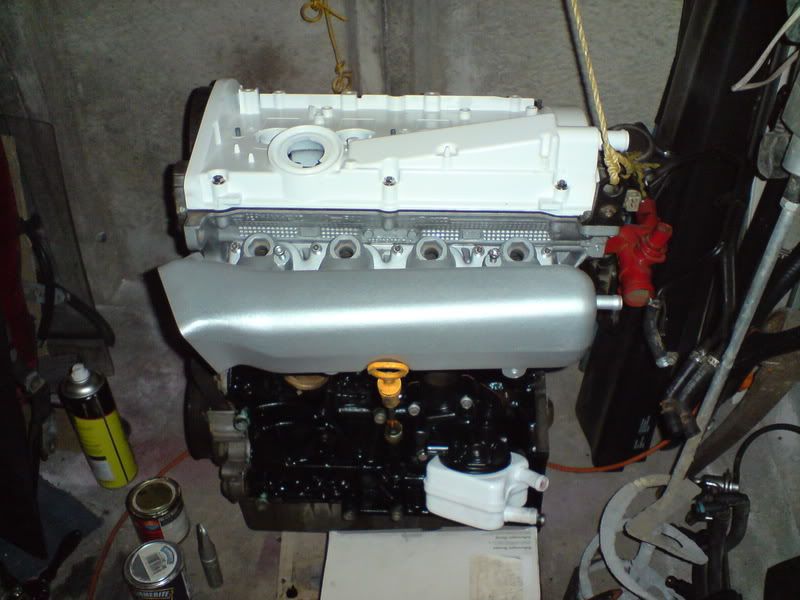

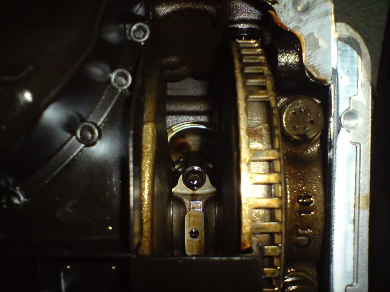

nothing much here, i managed to drop a nut int to the crankcase via the oil filter housing breather. doh! shat myself when i couldnt find it. Ended up taking the sump off to have a butchers......Couldnt see it! gave the oil pick up a clean whilst i was there (wasnt really clogged to be honest) then i took the plastic moulding off that leads up to the oil filter housing as i took it off the flippin nut i dropped in fell out (thnk god!)
few random pics ( looks really clean in there)

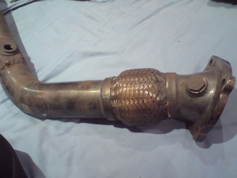

also got myself a second hand qpeng down pipe off the bay so happy days.gunna use exhaust wrap on it
cant wait to drop the lump in. Need to get a lambda probe, n75 valve (as i have no idea where ive put it) a few breathers and some new engine mounts

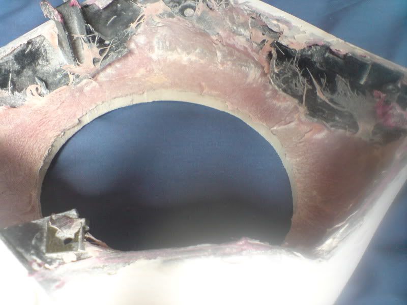

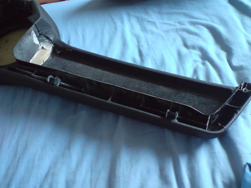

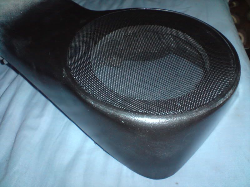

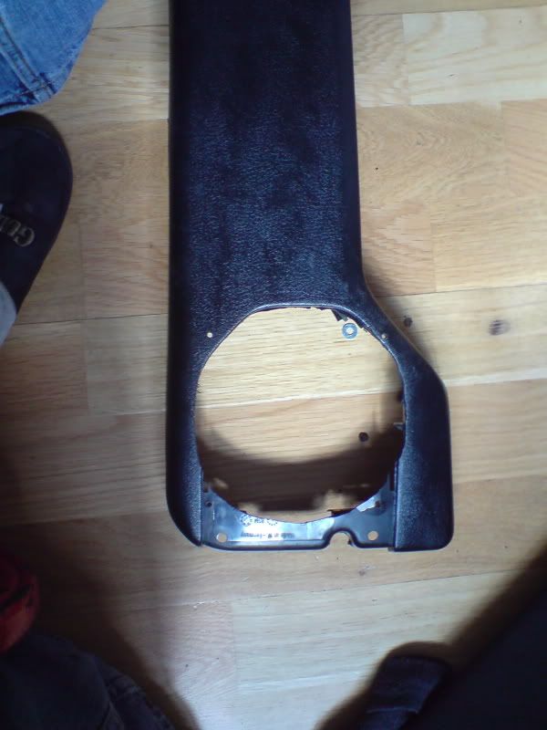

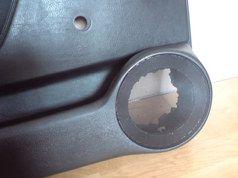

take one door pocket (butchered to fit my 6.5 inch alpine components on top)

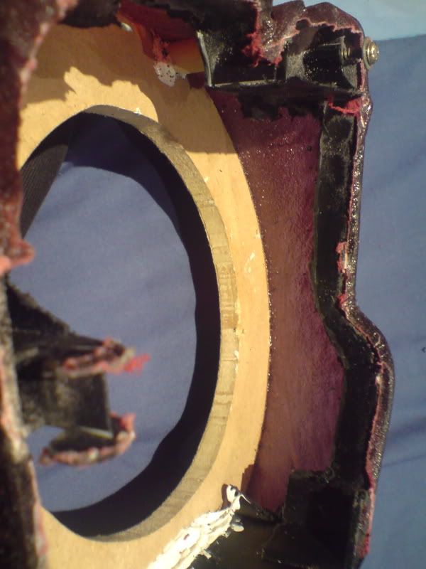

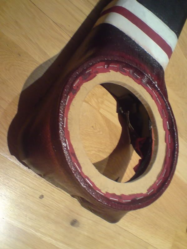

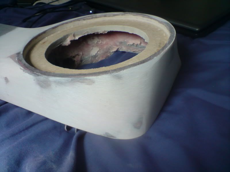

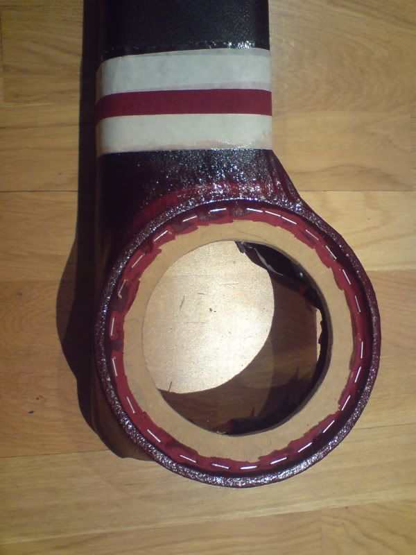

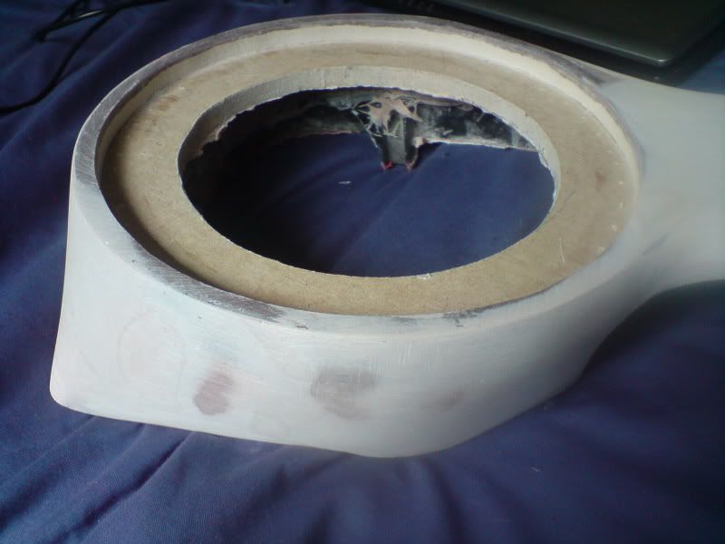

i bought some grilles off the bay which are 8 inch diameter (all that was available) so i set about making some mdf rings to accomodate them
they were glued and clamped together overnight.i then carefully chopped away at the door pocket to fit them in (glued them using sikkaflex and left that overnight to dry).

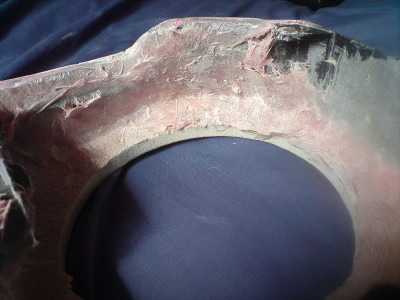

the fun part, found an old tshirt and carefully spent time wrapping it around the pod to make a wrinkle free cover. I then covered that in a few coats of fibreglass resin and let that dry.

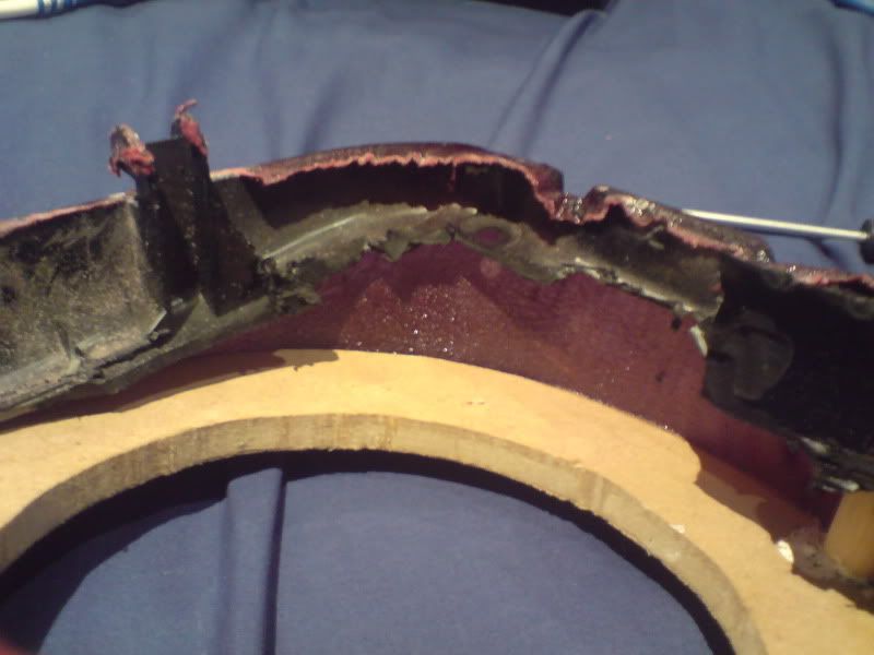

I trimmed some of the plastic away inside
and trimmed the material out of the inner section where the speaker sits

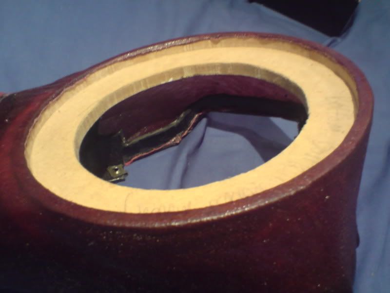

Where i had cut the plastic oout of the inside i used fibreglass filler to fill any gaps and also to reinforce the outside

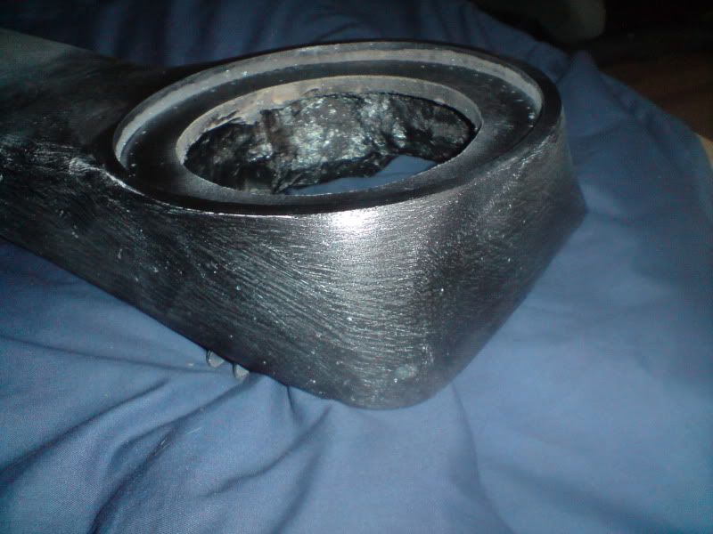

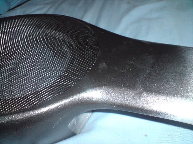

gave the outside a skim of filler to smooth out any imperfections and then roughly sanded it

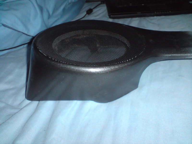

Sprayed it with a dark colour as i can see the curves better that way and what will need adjusting (looks rough because i used really coarse sandpaper to get the shape right)
more sanding and have also rounded of the edge that goes around the speaker as i thought it was a bit pants with a sharp line (you can also see the grille sat in place)

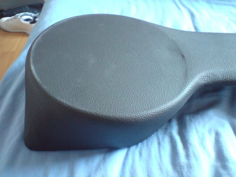

thats how far ive got at the moment. Have ordered some contact adhesive and some really stretchy vinyl to cover it with so stay tuned.....

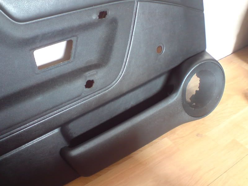

cheers mate, its not very hard to do just time consuming. very satisfying when you look at it compared to what i started with.beats paying 200 odd quid for audioscape ones too

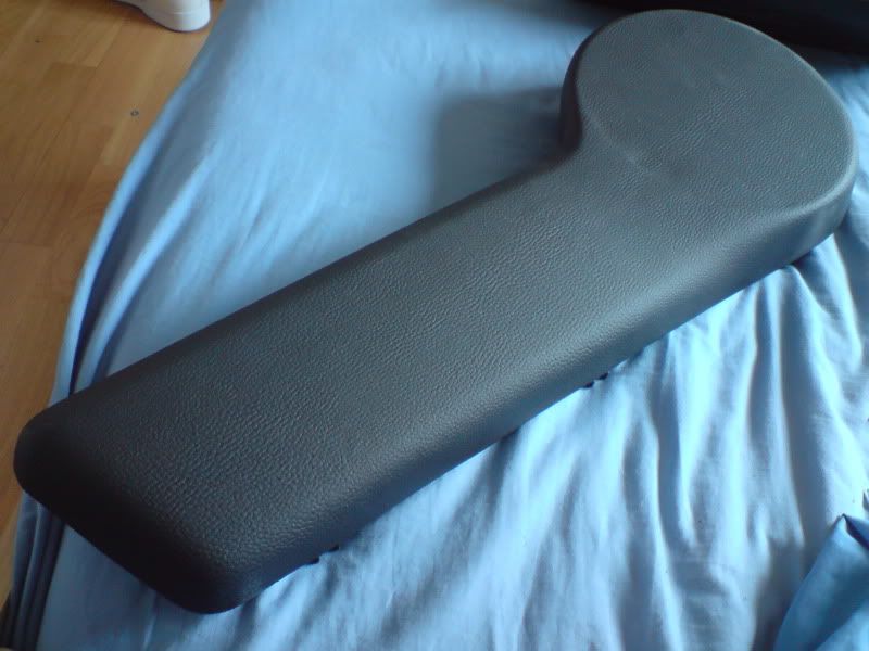

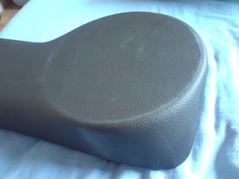

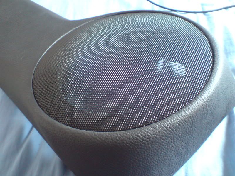

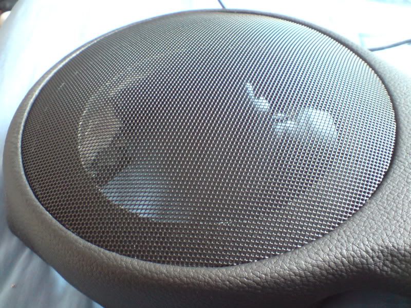

got 1 door pod near enough finished, feast you eyes on this....
test fitted on the door card

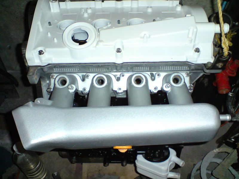

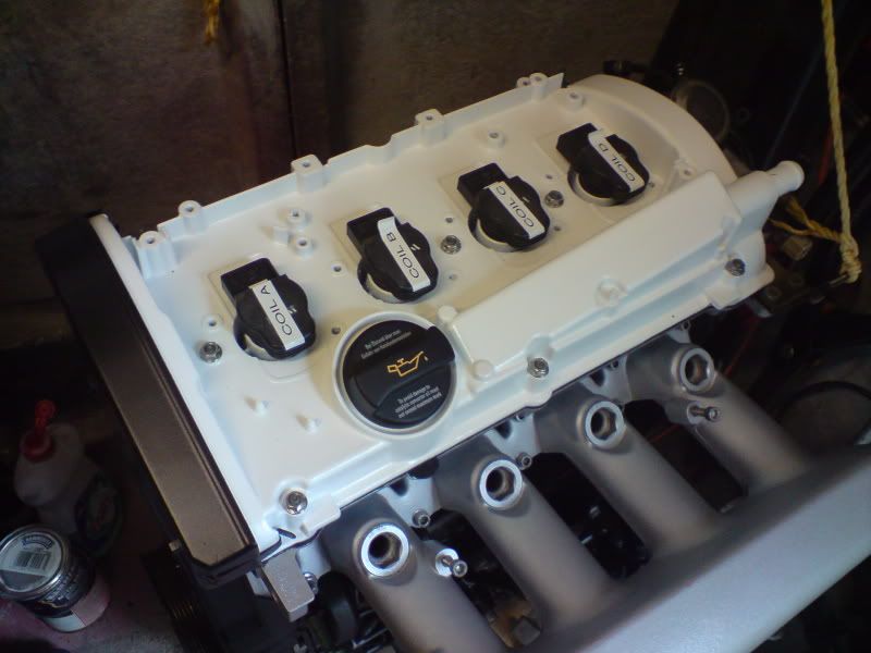

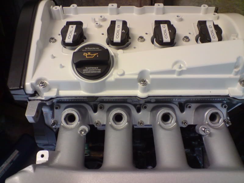

Also did a bit more on the engine

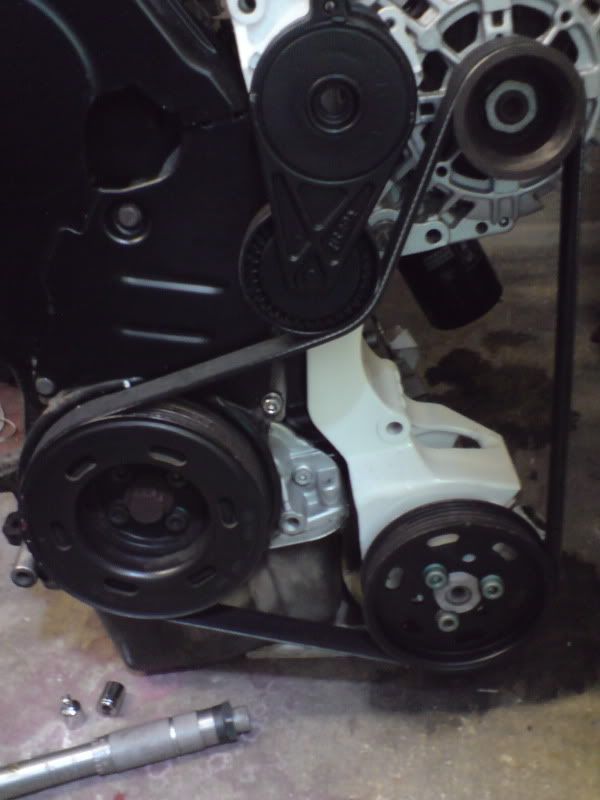

shorter drive belt for power steering and alternator fitted

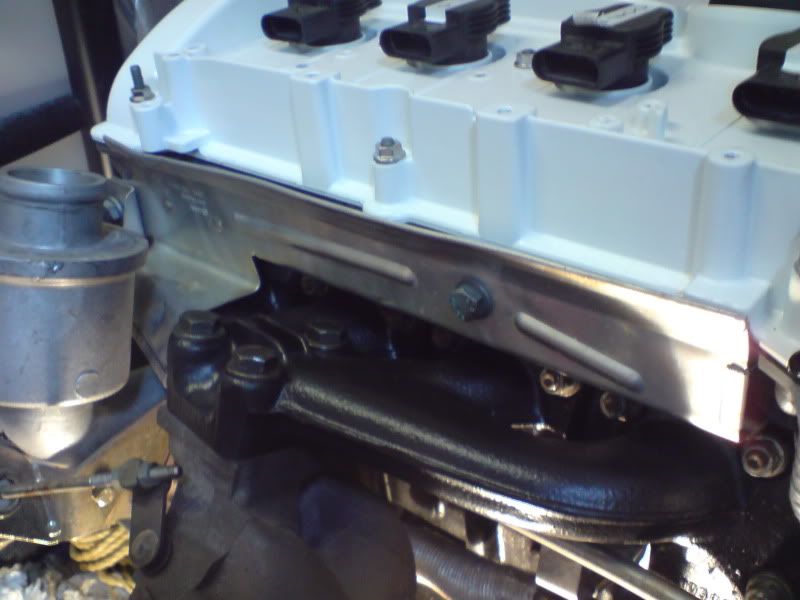

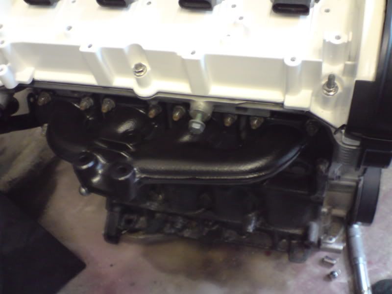

exhaust manifold fitted back up
heatshield bolted up

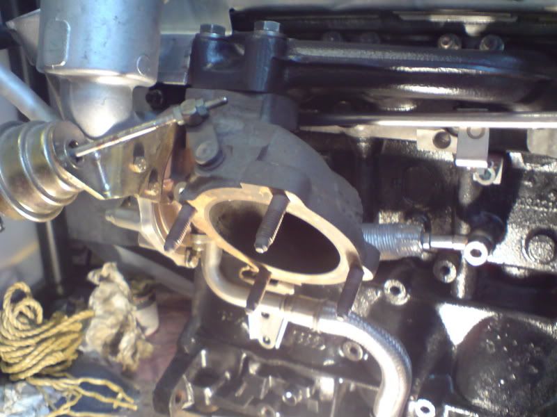

turbo bolted up
oil return bolted up

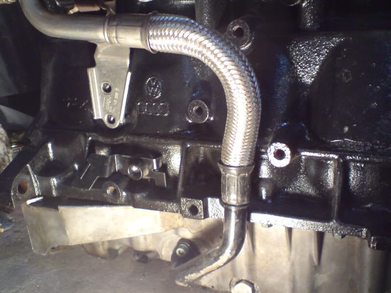

and the oil suply and water pipe bracket bolted back up
wow,,door pod looks great with a nice finnish!
engines looking good too when you gonna fit it??
cheers pal, im well happy with the door pods. Engine is pertty much complete, im just being lazy i suppose - still need to source a few parts. want to drop it in over the next couple months

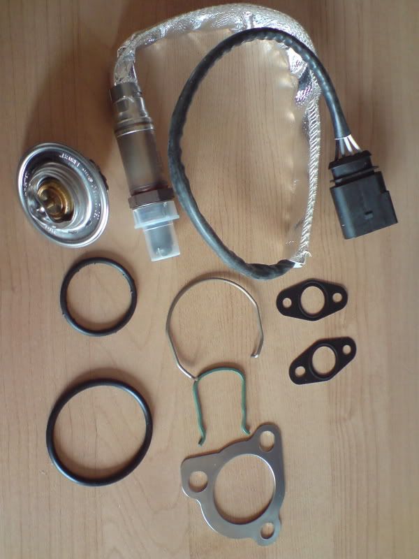

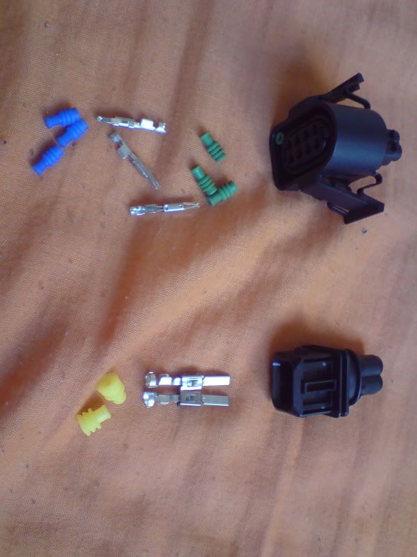

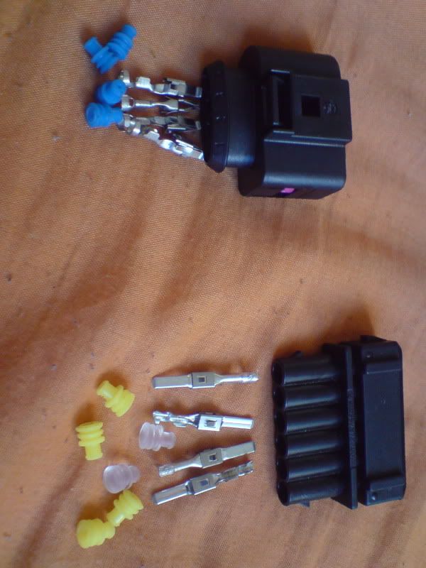

lil updates, got the remaining connectors i needed for the loom.
here you can see the lambda connector at the top and the digifant power connector at the bottom
here is the throttle body connector at the top and the temp sensor connector for the gauge
here is a bunch of other little bits i needed (all genuine of course )

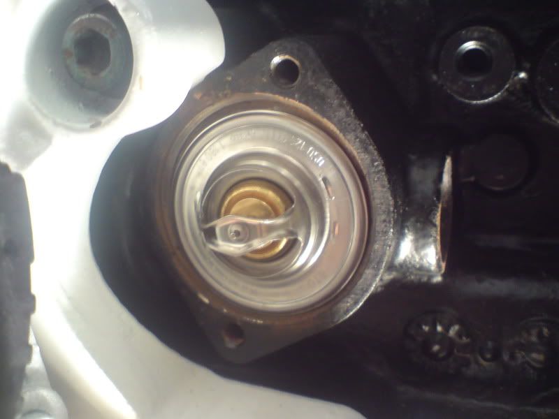

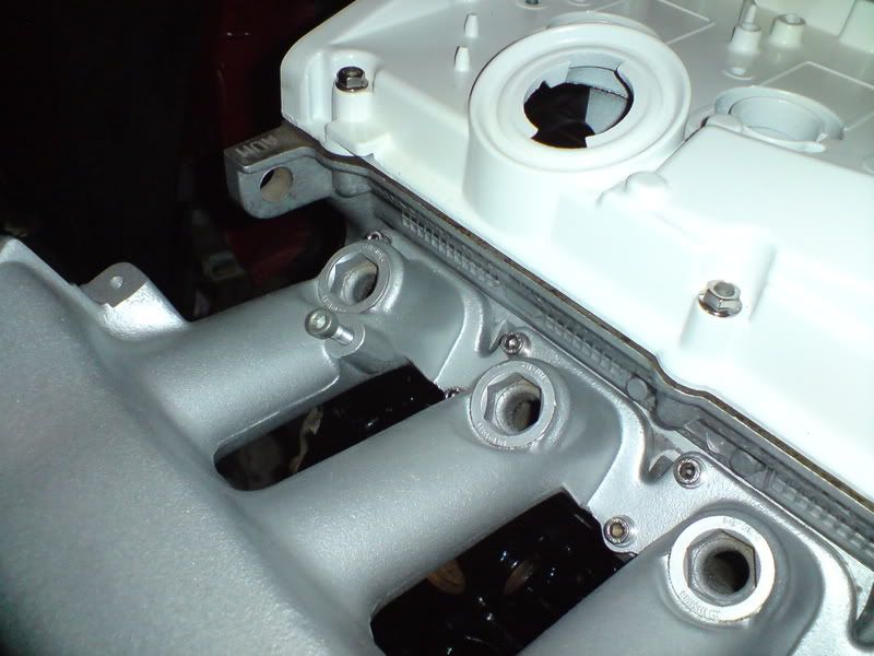

thermostat sat in place
o-ring and outlet bolted back on top

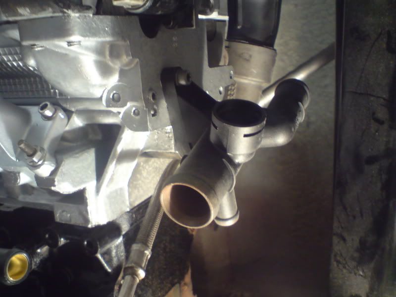

o-ring and water flange bolted back up

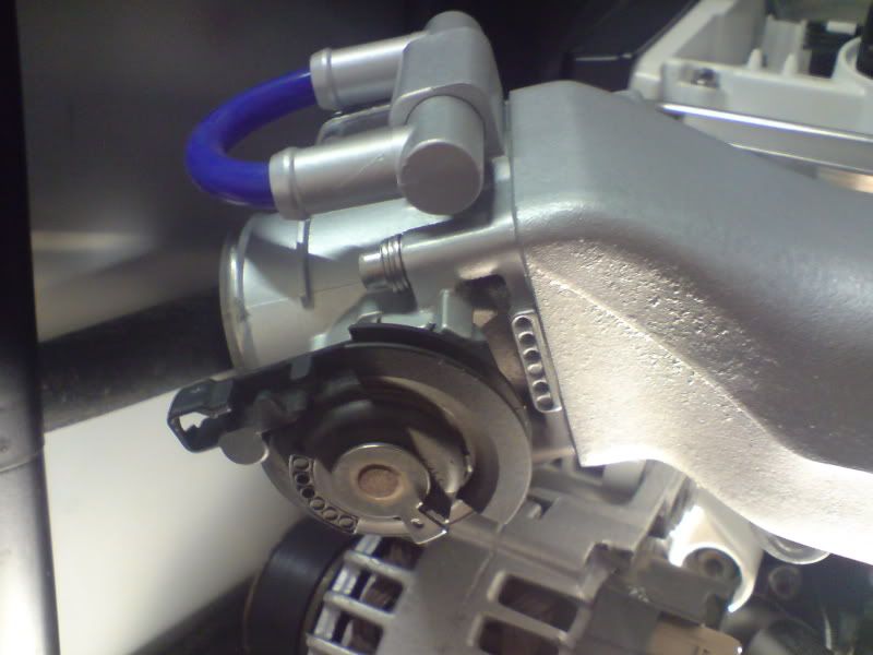

The throttle body fitted (ignore the blue hose haha - as the pipes at the top are unused i just stuck a bit of hose in there to make it look functional)

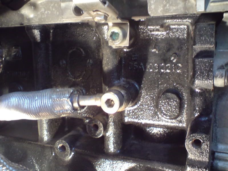

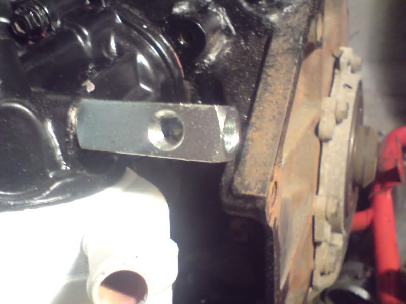

an adaptor i got to allow the fitment of the two g60 oil pressure sensors
