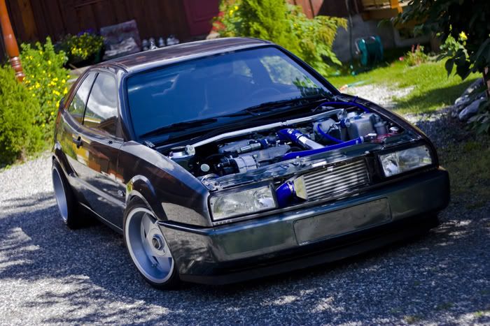

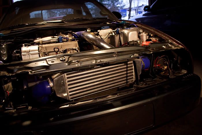

waynos 0 Posted July 8, 2008 i have been looking through some galleries and i came across corradonald's rado, stunning motor with some trick touches. Hes got a front mounted intercooler behind the grille (see pics - hope you dont mind me pinching these pics corradonald) im liking this idea as i can keep the boost pipes nice and short. Is there any reason i couldnt do this on my g60? would it block flow to my radiator in such a way that my cooling would be compromised? Quote Share this post Link to post Share on other sites

Toad 0 Posted July 8, 2008 That doesn't look ideal to me in terms of radiator cooling. Quote Share this post Link to post Share on other sites

Toad 0 Posted July 9, 2008 Sorry, I didn't make myself entirely clear, I have no issue with FMICs, oil coolers etc, but that example has the fairly large headers for the IC and the large bore piping sat in front of the radiator which will restrict airflow. Rather than just the core of the I/C, which air will pass through. I feel that obstructions like that will impair the performance of a system. I realise that the grill and horns are in the way also, but the air has space between the obstruction and the radiator to diffuse and thus pass through the entire core radiator, the FMIC headers/pipework are a lot closer to the radiator, and won't let the diffusion occur. It's also worth mentioning that if people are planning to fit FMICs like that, they should leave enough room to clean between the FMIC and radiator as grass and detritus builds up between them blocking the radiator cores, or make some way to tip the radiator back to get in and clean the space out. Looking forward to my next flaming.... ;) Quote Share this post Link to post Share on other sites

Toad 0 Posted July 9, 2008 Yeah, stacking radiator cores isn't too bad, as the air will get through, although I might be tempted to try uprating the fan, I'm used to seeing intercoolers, aircon, gearbox and engine oil coolers rammed in front of the main rads, but there is nothing solid in front of the rad core, and everything works swimmingly, until shite builds up in the gap between them. Quote Share this post Link to post Share on other sites
