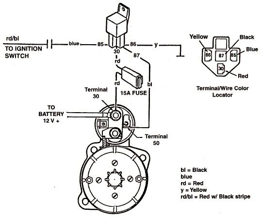

waynos 0 Posted October 15, 2008 When i first got my car i could start the car and drive for hours on end however, if i turned the car off e.g. to fill up with petrol the minute i tried to start it i wouldnt get anything, not a click ,not an attempt to crank. Now ive been doing some research and it appears a lot of vws used to do this, especially those with bosch starter motors. They suffer from a heat soak(from high under bonnet temperatures) where the voltage to the starter solenoid terminal drops below ten volts or even more. This seems to make even more sense in my case as i swapped the starter and battery from my 16v and still had the same problem. My g60 gets way hotter than my 16v ever did. the solutuion.. A starter relay. Bosch did do a kit called the wr 1 which came with wiring etc and i think vw even did a relay for this too. it is wired so that the original starter wire trips the relay. The relay is positioned next to the battery so that you can have a nice short direct feed from the battery positive to the relay then from the relay to the starter solenoid. Earth can be taken from the gearbox earth. In effect this should also lengthen the life of your igntion switch as the load will be placed on the relay and not the switch. Your starter solenoid will now always get battery voltage nothing less. heres a pic i found showing the wiring of the bosch starter kit. They use a fuse so that in the event your starter is faulty it will blow this rather than fry the relay. I cant find the bosch kit for sale anywhere but im sure all the bits needed could be bought from somewhere like halfords for under 15 quid. Hope this helps anyone whos had the problems ive had, Now i still need to sort my other running problem lol Quote Share this post Link to post Share on other sites

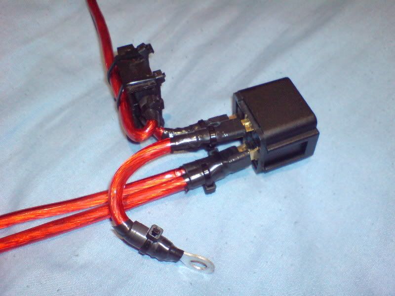

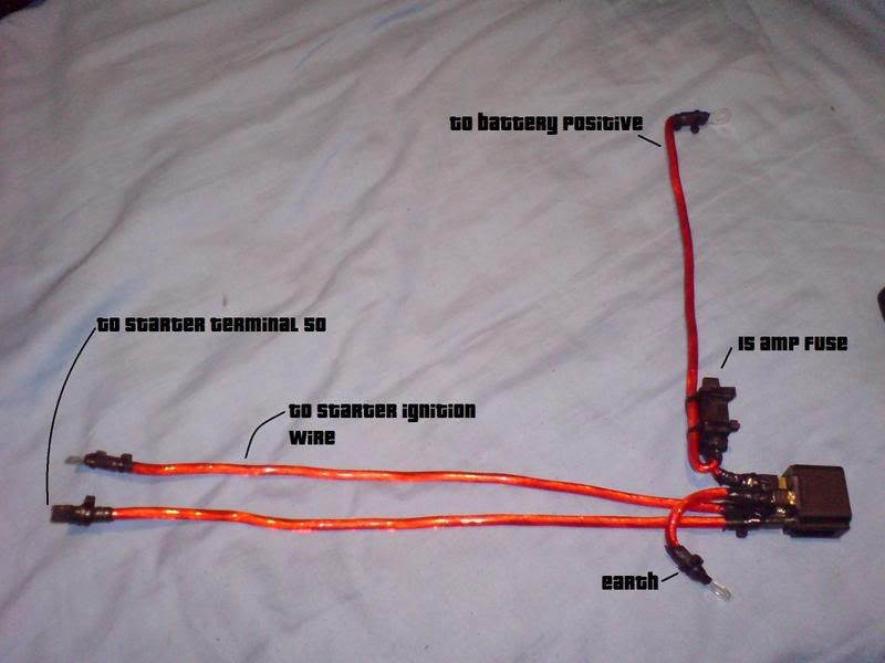

waynos 0 Posted October 21, 2008 right i got busy making my own. Used a 40 amp relay which i got off ebay, some old amp cable i had and some male and female spade connectors. All connections were soldered ( i dont trust crimping them!) hopefully i can get it on the car this weekend and also sort out my other problem Quote Share this post Link to post Share on other sites
mattkh 0 Posted October 22, 2008 All connections were soldered ( i dont trust crimping them!) Hi But then you have to worry about a dry solder join. Quote Share this post Link to post Share on other sites
waynos 0 Posted October 22, 2008 i have never had a dry joint before (touch wood)in a way ive kind of combined the two. Pushed about 7mm of wire trough the terminal and crimped that then the bit of wire left protruding ive soldered so it should be ok Quote Share this post Link to post Share on other sites

buttles 0 Posted June 21, 2012 fla, I cut the wire about 3 inches from the plug on the starter motor. You then attach the load wire from the relay to the plug. The loose end (from the ignition switch) then attaches to the trigger terminal on the relay. Quite the most simple and best mod I've done to the car. Neil Quote Share this post Link to post Share on other sites
