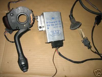

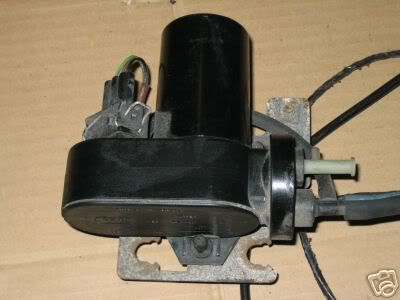

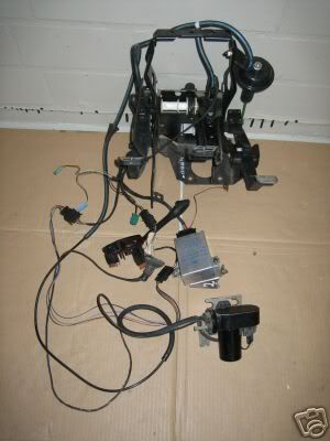

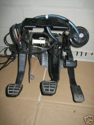

mattwelcer 0 Posted December 11, 2008 As said above it works from a vacuum system. There are some available on German ebay but if they will fit a RHD Corrado i am not sure. I know the Passat, Corrado, Mk2/Mk3 Golf all used the same Cruise Control system (just different control stalks depending on model and year). Here are some pics of what i bought of eBay when i fitted it to my Mk3 GTI a few years ago As you can see the vacuum unit controls the actual accelerator pedal and there are switches on the clutch and brake pedal that disengage the system when pressed. Prob some points i have missed but the system is straight forward! ;) Quote Share this post Link to post Share on other sites
