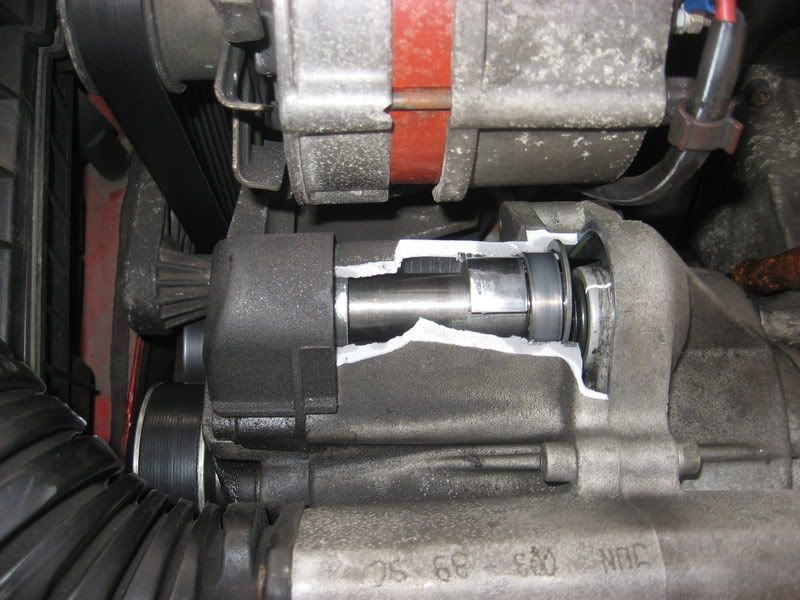

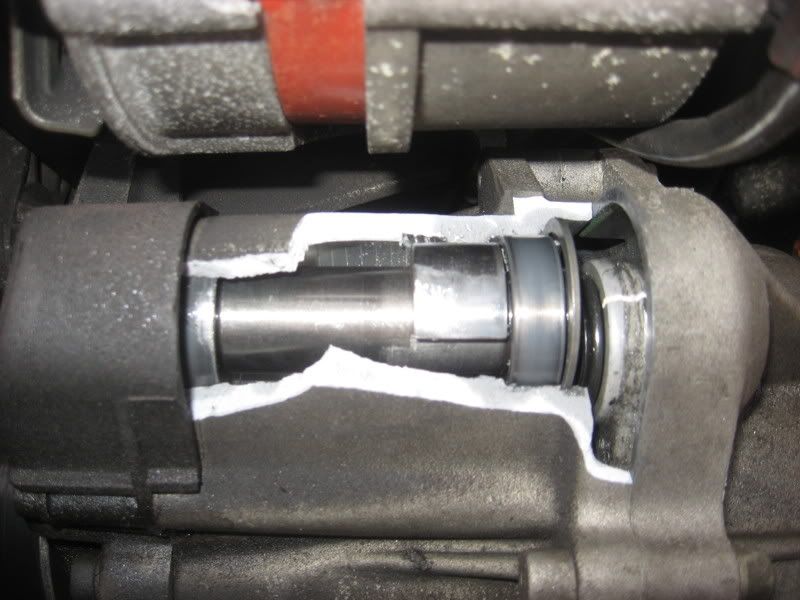

Corrado_Addict 0 Posted December 31, 2008 Not actually sure why this has happened or have the tiniest idea. The supercharger has covered under 7000 miles since its rebuild by the previous owner. I put the foot down and couldn't get traction thanks to the greasy roads after going to have some banter with a mini cooper s revs went up very quickly, heard a little bang from underneath the bonnet heard a rattle, pulled over after a few hundred yards to find this..........on the day i get it back from the garage with the steering rack sorted and my brakes working this happens :confused4: :pukeright: Gutted isn't the word :pale: Quote Share this post Link to post Share on other sites

flusted 0 Posted December 31, 2008 looks like the small belt has snapped? Quote Share this post Link to post Share on other sites
Neil VR6 0 Posted December 31, 2008 There are a few places which I'd happily take a G-Lader to for a re-build, G-Werks, JMR and Stealth all have excellent reputations. There are some markings on the supercharger which I presume whoever did the re-build etched onto it. When JMR did mine he stamped on 'S4 JMR' so this could be a similar mark someone's made. It's a real pain that's it's blown but you might find that the place that did it might exercise some goodwill. Alternatively, as you're a different owner to who had the work done, there could be little comeback to be had. When it's this cold it's so important to warm the engine up slowly and make sure your oil's nice and warm before you give it beans, especially as the G-Lader shares its oil supply with the engine. They also hate hitting the rev limiter which is quite abrupt on G60s - it tends to 'shock' the charger. If you need to source another blower I'm sure Darren from G-Werks could find one. EDIT - You might want to amend the title of the thread with 'hole' rather than 'whole' Quote Share this post Link to post Share on other sites

SamG40 0 Posted December 31, 2008 looks like the small belt has snapped? I was going to say that. I change the small belt on my charger anually regardless of the mileage now. They cost about a tenner and can be changed in about 30 seconds once they are off the car. Quote Share this post Link to post Share on other sites
