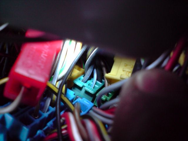

I know i have another post on this somewhere but i cant find it and i need a quick responce please.
Ive got my dash out to do my matrix so thought it'd be great time to do my heated seat loom into my fuse box now.
I have found the D setion on my fuse box and found wires coming from it, just need to know what i need to do next...
as you look at this pic, D11 is in bottom left of the green plug and D12 is in the bottom right.
I've been told
'the thin black from the switch into the larger black which goes to the fuse box. Find socket D and then terminal 9 on that socket, hopefully there is a black/white wire coming from this terminal to another terminal block that you can connect in to.'
the black/white from D9 is not connected to anything, its the one u can see me holding my my hand.
Cheers for your help!
So don't you just need to put a female connector on to the black wire and connect it to the green plug that you've marked up as "goes to D9"?

what i want to know is that if i put a connector on the end of my grey/blue iluminace wire from my loom and plug it next to the other blue/grey, in this pic at bottom of post, on the left will that work?
and if i put that black/white wire from D9 into one of the spare slots in the black box just underneith the green connector(on top of fuse box) and then put my black wire from my loom into the other spare slot, will that work?
and how to them little black boxes work on top of the fuse box?

1) The wiring diag shows the black white from D9 connecting to the black wire that goes to the driver's side control unit. It connects in TV5 which is one of those black boxes (I like that name!) on top of the fuse box.
2) All grey/blue wires are switch and gauge illumination positives. Connect the one you have from the seats switch as you suggest in the black box and it will light up with all the others. Again wiring diagram shows it in TV8 black box but if it's with grey/blue it should be OK.
The little black boxes by the way are simply multi connectors, saves having to wire loads of single wires into the fuse box.

nice one tony, cheers for your help, still bit confused tho, let me see if i've got it right..
i can put my grey/blue wire from my loom into the black box next to the other grey/blue one?
still not sure where i put the black wire from my loom tho as the black/white isn't plugged into anything?
Is the black/white not the one comes from D9? That has to connect to the black from your loom, if there is a spare black box on top of the fuse box, use that to connect the two. Don't however connect it to one that already has some other wires in or it'll really confuse things!
Just knocking off mate, I'll be on line again a bit later, I'll check how you got on.
yes that black white comes from the D9 slot, but it's not plugged in anywhere. i dont think i have any spare TV (black boxes) on top of my fuse box, could u use a female conector and plug it directly to it?
ill try it 2morow whilst i try and put my car back together and see how i get on.

If you don't have a spare connector (black box) then just join the black/white to the black, solder it if possible cos then it's not going to fall to pieces when you cram all the wires around the fuse box back in! Spade connectors or something will do the job too if you can't get near a soldering iron.

wired up the seats no problem, soldered them as you said, their working fine.
but now my alarm doesn't work, it has no power going to it at all! not a happy bunny!

Sounds like you've disturbed one of those zillion wires that's crammed behind and above the fuse box, you were supposed to be connecting wires, not pulling them out!

yeah no problem, i must adm,it i owe alot of thanks to 'Tonedef' who gave me loads of useful info and a wiring diagram.
i've got a few pics so ill put the in this post,
Blue/grey.
There will probably be spare blue grey sockets on the top of the fuse box or behind the fuse box. It doesn't have to run all the way there if you don't want, any blue/grey will do as they are all switch illumination.
Black.
This is the only tricky one as it's the power supply to the switch and should come though the same fuse as the power supply to the seat heaters. If you look along the bottom of the wiring diagram there are numbers 1 to 14, these are the columns on the drawing, at column 7 you should see the 0.5 BK (Black) which goes from the switch to a thin line above it. The thin line joins it to a 1.0 BK at column 4 and a 1.5 BK at column 1. The number is the wire thickness, you'll see all the wires from the switch are 0.5 which are small control wires, the one at column 1 is the main power to heated seats and is 1.5mm as more power is required. The thin line joining these three black wires just shows that they are connected together, it's not a wire!
So, what you need to do is connect the thin black from the switch into the larger black which goes to the fuse box. To identify where the larger black finally connects, you probably have to remove the fuse box, all sockets on the back of the fuse box are identified by moulded letters. Find socket D and then terminal 9 on that socket, hopefully there is a black/white wire coming from this terminal to another terminal block that you can connect in to. This terminal block (TV5) will be either on top of the fuse box or behind it, follow the wire (if there is one) from D/9 to TV5 and this is where you connect the thick black wire. If there is no Black/White wire coming from D/9 you will have to connect one in, if this is the case you really need wiring terminals of the correct type, I have loads at home but of course I'm in Saudi. Hopefully not anyway!
i just put the grey'blue into spare black box on top of fuse box and directly soldered the black from the loom to the black/white from D9, its all fine now.
