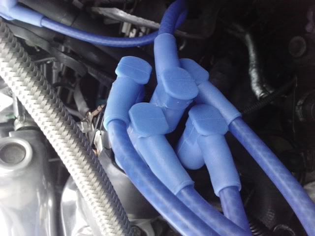

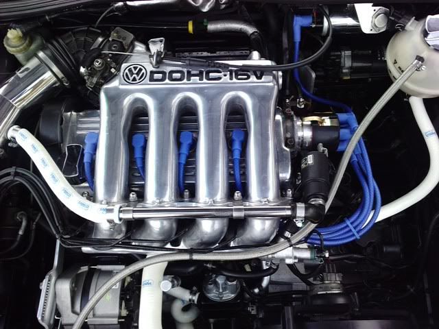

samthegram 10 Posted February 6, 2009 I'm currently gathering all the part I need for a 9A 16v rebuild - I have a question regarding HT leads. At the moment I have what looks to be original leads though the knock reference sensor is loose in the engine bay (the one that should be attached to the #4 cylinder lead). I've spotted some K1 racing leads on Ebay that say they are suitable for for 9A, but they are 10mm, which won't fit throught the reference sensor. So, my question is what are the implications of not using the sensor? - if it is required what are the best leads to use? - and what are the benefits of using the thicker core performance leads? Any help would be appreciated. I have just got some of these and fitted them this morn, they went straight on . there was no sensor attached to the old lead as you say and they seem to work fine. I have to say i did just get them to look good and they do look very bling. i will post a pic up tommorow. p.s- I also have the 2.0 9a. Quote Share this post Link to post Share on other sites
samthegram 10 Posted February 7, 2009 here you go matey, see what you think i think they look the dogs danglys :shades: Quote Share this post Link to post Share on other sites
russlench 0 Posted February 8, 2009 Agreed, they do look good. Do you mean that you don't have #4 cylinder sensor, or that you just didn't use it? Quote Share this post Link to post Share on other sites

mariojoshi 1 Posted February 8, 2009 here you go matey, see what you think i think they look the dogs danglys :shades: As does that engine bay fella! :luvlove: Quote Share this post Link to post Share on other sites
