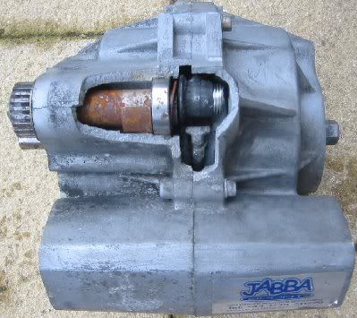

steveo29 0 Posted May 12, 2009 jabbas work hasnt good for some time now ive had problems with their rebuilds and know others that had them grenade at low miles be worth at lest getting a health check on it a gwerks Quote Share this post Link to post Share on other sites
